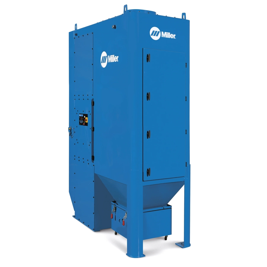

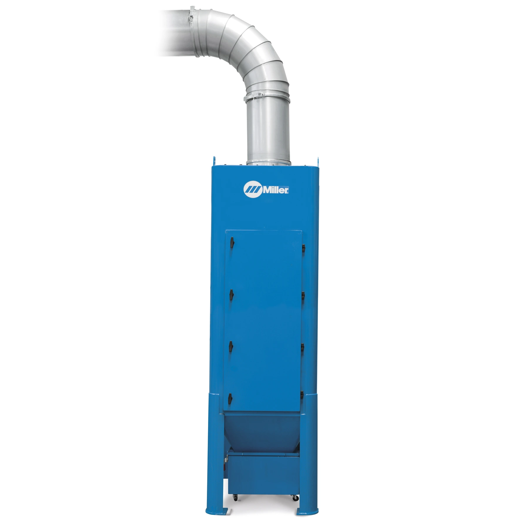

  • Smaller Footprint than Traditional Systems
    65% smaller than traditional cartridge filter collectors, taking up less shop, roof or outdoor space.
  • Quiet Operation
    An integrated silencer housing minimizes fan and motor noise making the unit up to 75% quieter, for a safer more productive work environment.
  • Efficient Design
    Dirty air gets pulled down into the filter area which deposits fume particulate on the surface of the filter and into the 22 gallon particulate bin.
  • Smaller Size and Fewer Filters
    One FilTek XL filter replaces up to three cartridge-style filters increasing efficiency, reducing extractor size, and lowering operational costs.
  • Longer Filter life
    Is a result of the Linear Jet Automatic Cleaning System which delivers cleaning air in straight line paths through the filter media and easily pulses weld particulate off of the surface-loaded filter media. Easier cleaning results in longer filter life, better suction and better efficiency.
  • MERV 16 Filter Rating
  • Maintenance Free
    Premium high-efficiency motor with direct drive blower eliminates bearings and belts and ensures vibration free operation.  Located in clean air maximized life.
  • Strong Structure
    Strong 3/16-inch to 12-gauge, all-welded steel structure compliant with IBC2006
  • 24 VDC Motor Start/Stop Feedback Relay
    Allows an external signal to automate the remote start of the collector fan from other equipment.
  • Filter Access Bay
    Provides easy access to filter packs for toolless removal and installation.

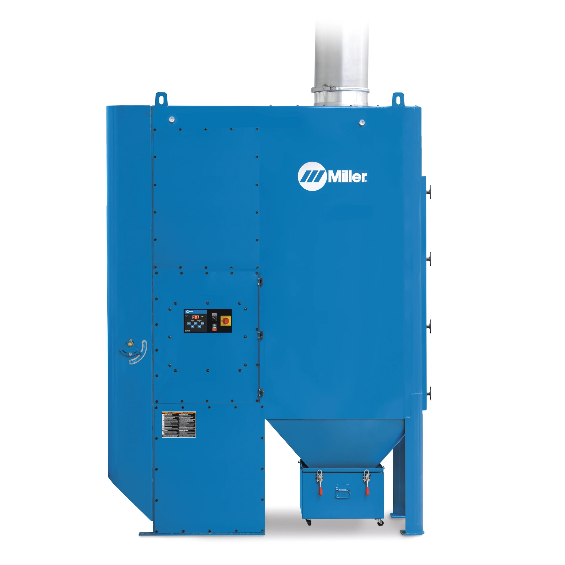

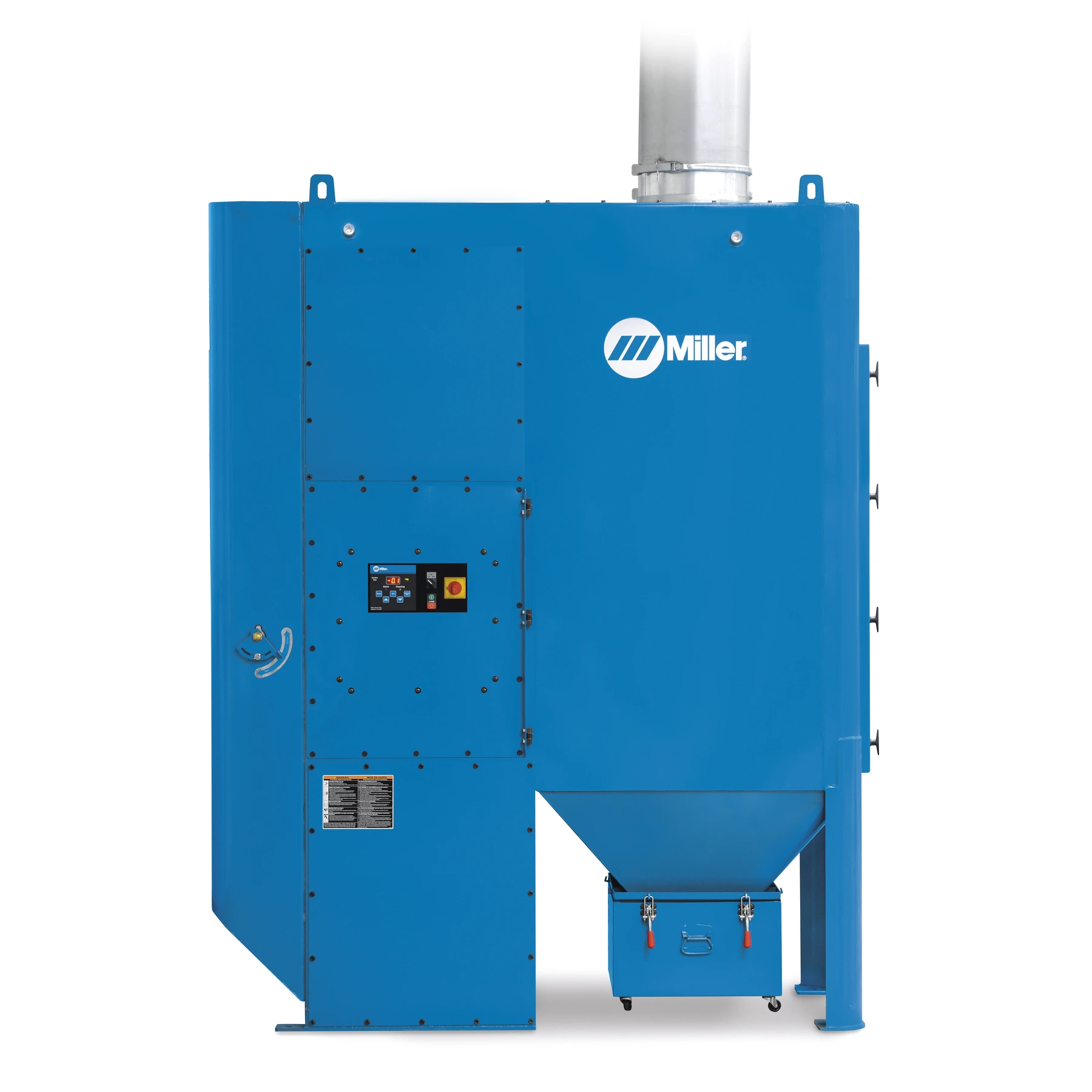

  • Integrated Electronic Controls
    Control panel manages all of the collector functions, including the fan, the filter differential, and the pulse cleaning system.
