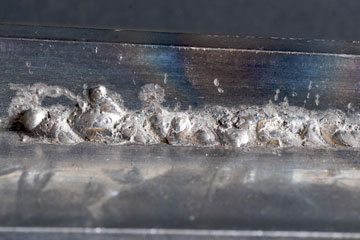

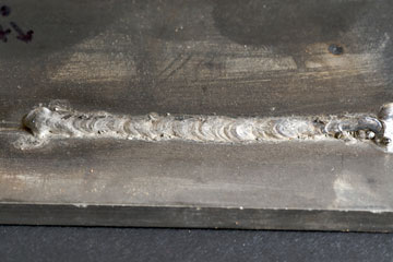

If your amperage is too low, your electrode will be especially sticky when striking an arc. Too low amperage may also cause your arc to keep going out while maintaining the correct arc length or the arc will stutter.
ampstoolow1jpg
This weld is a result of too little current. If you’re welding with amperage set too low, your electrode will be especially sticky when striking an arc, the arc will keep going out while maintaining the correct arc length or the arc will stutter.

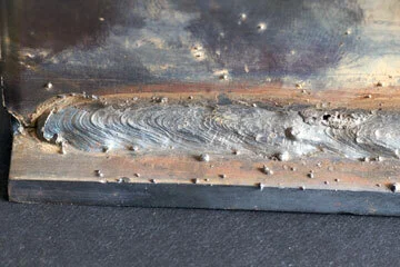

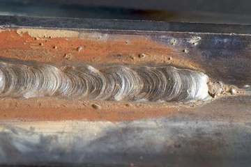

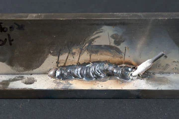

Once you get an arc going, if the puddle is excessively fluid and hard to control, your electrode chars when it’s only half gone, or the arc sounds louder than normal, your amperage might be set too high. Too much heat can also negatively affect the electrode’s flux properties.
ampstoohigh4jpg
The weld is the result of too much current. When the amperage is set too high, the puddle will be excessively fluid and hard to control. This can lead to excess spatter and higher potential for undercut. In addition, the electrode will become hot — perhaps hot enough to glow toward the end of the weld—which can adversely affect the shielding properties of the flux.
glowingelectgrodelrjpg
A sign of too much current is when the electrode becomes hot enough to glow.

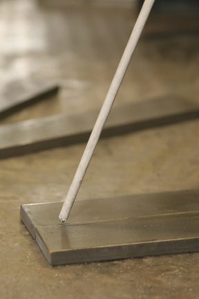

The optimal arc length, or distance between electrode and puddle, is the same as the diameter of the electrode (the actual metal part within the flux covering). Holding the electrode too closely to the joint decreases welding voltage, which creates an erratic arc that may extinguish itself or cause the electrode to freeze faster and produces a weld bead with a high crown.
arctooshort1jpg
An arc length that is too short will create greater potential for the electrode sticking to the base material.

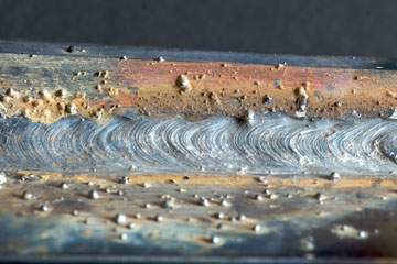

Excessively fast travel speeds also decrease penetration and create a narrower and/or highly crowned bead. It can also possibly lead to underfill or undercut, which is when the area outside of the weld is concave or recessed. Note toward the end of the bead in the image below how the bead appears inconsistent as if the puddle were trying to keep up.
toofast1jpg
Traveling too fast will create a thinner/undersized bead that will have more of a V-shaped ripple effect in the puddle rather than a nice U-shaped, or stacked dimes, effect.
