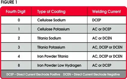

Welding current
Some electrodes can be used with only AC or DC power sources while other electrodes are compatible with both. To determine the correct current type for a particular electrode, refer to the fourth digit of the AWS classification, which represents the type of coating and type of compatible welding current (see Figure 1).
figure1000jpg
Refer to the fourth digit of the AWS classification to determine the compatible welding current.
The type of current you use also influences the penetration profile of the resulting weld. For example, a DCEP compatible electrode, such as an E6010, delivers deep penetration and produces an extremely tight arc. It also has the ability to “dig” through rust, oil, paint and dirt. A DCEN compatible electrode, such as an E6012, provides mild penetration and works well when bridging two joints or welding high speed, high current fillet welds in the horizontal position.
An AC compatible electrode, such as an E6013, produces a soft arc with medium penetration and should be used to weld clean, new sheet metal.
