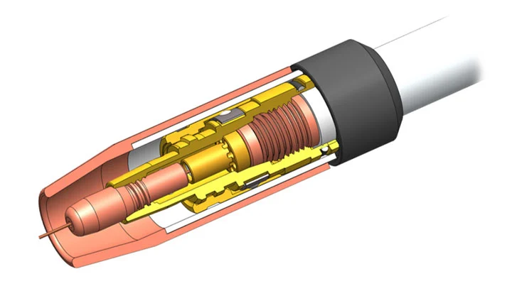

Adding to the ease of installation of the AccuLock Consumables system, the contact tips feature coarse threads that easily mate with the gas diffuser, lessening the chance of cross-threading and speeding contact tip replacement. In addition, AccuLock Consumables are designed to reduce heat buildup since the contact tip tail within the diffuser is cooled with shielding gas for long product life. The tapered design of the consumables tightly locks all conductive parts together to minimize electrical resistance and further reduce heat buildup.

cutaway_image2
Because non-threaded contact tips do not require tools to change, they are quicker to replace after burnback. Some fabrication shops use tips that have just four settings, such as flush with the end of the nozzle, 1/8-inch recess, 1/4-in. recess, or 1/8 in. stick out. Fewer choices improve consistency among welders.
