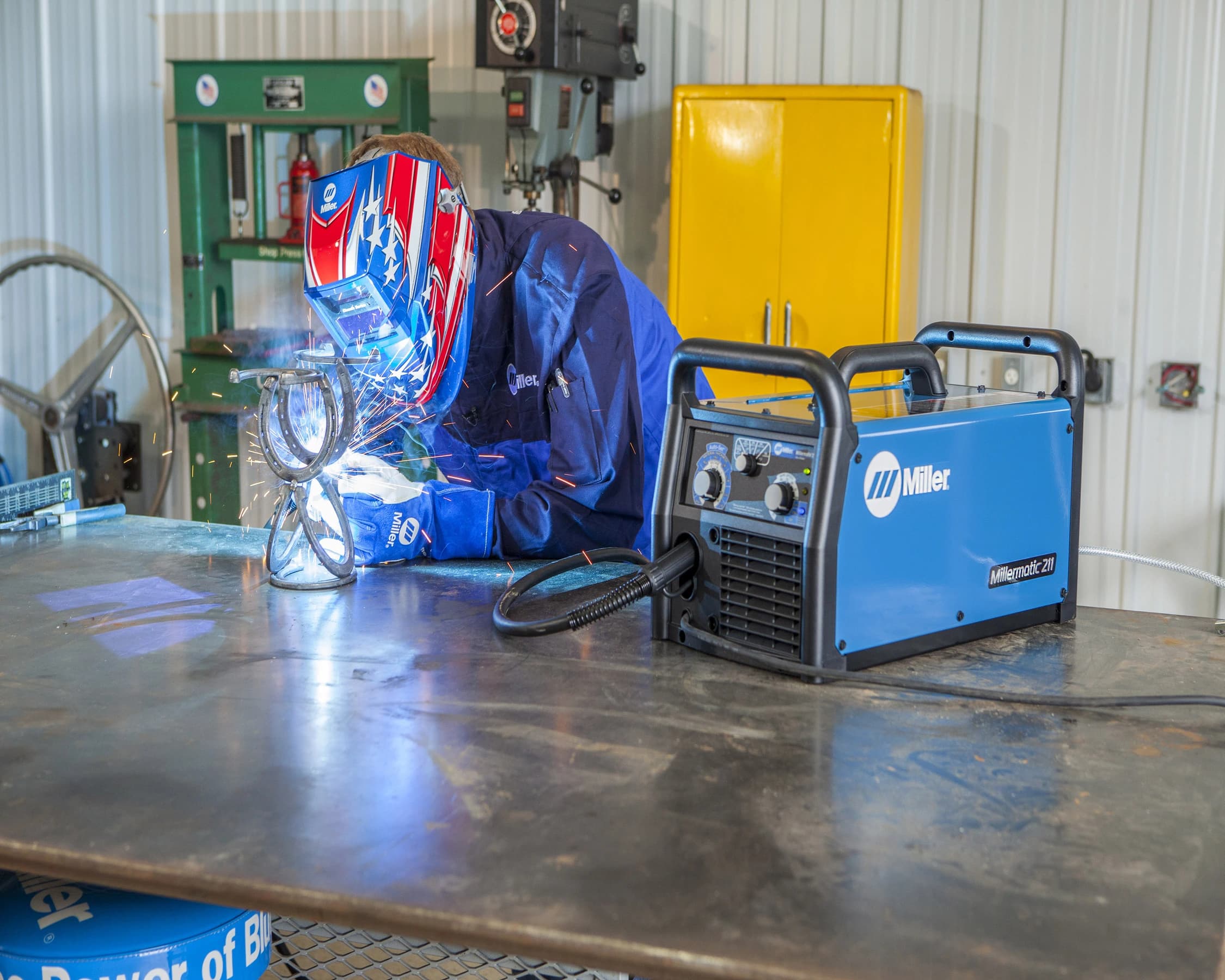

So Brooks unbolted the broken stainless steel piece and took it back to his shop, where he has a Millermatic® 212 Auto-Set™ MIG wire welder. It took him just a few minutes to switch spools on the machine so he could fix the retracting arm.
“In five minutes I had it switched over to weld stainless steel, I made two little welds and got it back to the milking parlor,” Brooks says. “We probably only lost 15 minutes of operating time. Being able to fix it so quickly meant avoiding a lengthy downtime.”
Whether it’s repairing a stainless steel piece in the milking parlor, fabricating an aluminum part for the farm’s light sport airplane or building a trailer with mild steel, Brooks needs welding and cutting equipment to complete the job easily and efficiently.
When he can complete repair and fabrication work in the shop at Brooks Farms, Brooks has a few options. He can use his Millermatic 212 Auto-Set, which can weld aluminum, stainless steel and mild steel from 22 gauge to 3/8 inch thick in a single pass. Another option is his Bobcat™ 250 EFI engine-driven welder/generator with electronic fuel injection for stick welding mild steel and thicker materials.
