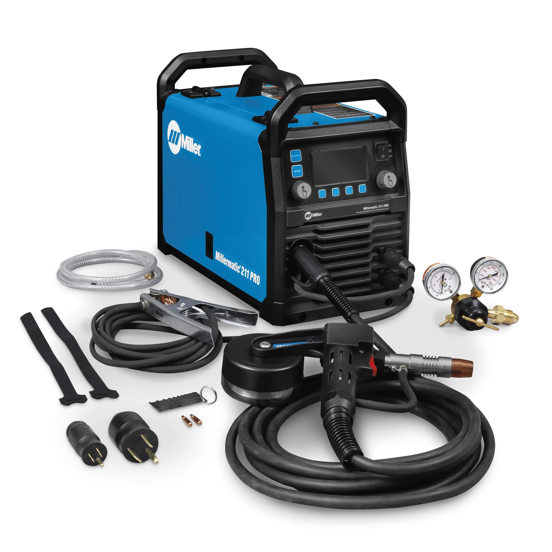

Fortunately, there is an easy solution for this issue — using a spool gun. This type of gun holds a spool of wire, so the feed path is short and straight. The Miller® Spoolmate™ 150 spool gun is a direct replacement for the gun on the Millermatic 211 PRO and requires no tools for installation.

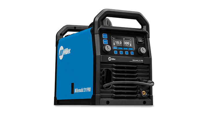

Once the spool gun is installed, load your spool, connect your gas and you’re ready to dial in the settings. The Spoolmate 150 integrates seamlessly with the Auto-Set™ feature on the Millermatic 211 PRO, allowing you to start simply by dialing in the material thickness and the wire diameter.

You can easily adjust the settings for wire feed speed and voltage with the dials on the machine’s front panel.

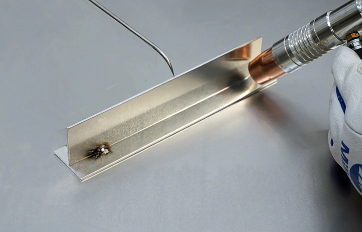

The first trial I did with the Spoolmate 150 gun was a fillet weld on 0.080-inch aluminum sheet, using 0.030-inch 4043 wire. I temporarily held the parts in the proper alignment and tack welded them together.

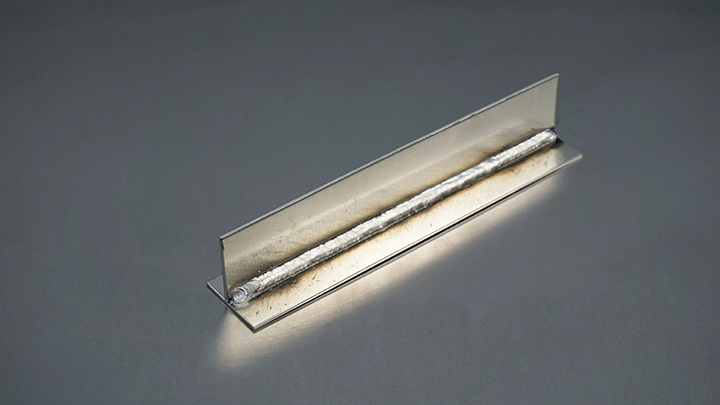

After several tests, I got the best results with the voltage set at 15.5-16.0 and the wire speed at 420-425 ipm, using 30 cfh gas flow. The best gun angle was 45 degrees from each side of the joint, with a 20-degree travel angle. I experimented with moving the gun faster and slower until I found the speed that gave me the best bead profile. You will often see a little black soot develop at the edges of an aluminum MIG weld. However, it was minimal at these settings. I removed the little soot left with one or two swipes of a wire brush.

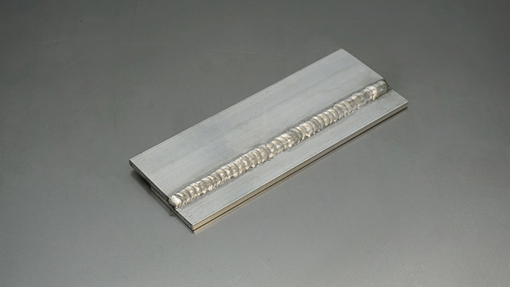

Next, I set up a lap joint on 3/16-inch plate. I did a few tests to find the settings and travel speed that would produce a bead that filled the step completely and leave a nicely rounded bead profile. I held the gun at 45 degrees from the work and used a 20-degree travel angle.

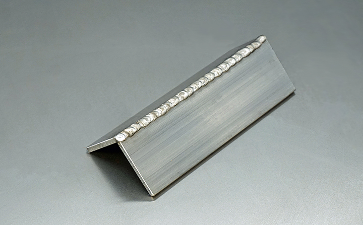

The next test I did was a corner weld on 1/4-inch aluminum plate. Fixturing the plates corner to corner, 90 degrees to each other, automatically created a small trough. I held the torch vertically while using a 20-degree travel angle. I also experimented with different travel speeds until I found what worked best. In the end, I got a nicely rounded weld bead that just filled the trough.

Millermatic 211 PRO Spoolmate 150 Package
All in all, I found the Spoolmate 150 spool gun quite easy to set up and use. The process is similar to using a traditional MIG gun, but aluminum has some unique properties that you’ll appreciate. Miller offers other spool guns, such as the Spoolmate 100, which is less expensive but has a shorter cable and lower duty cycle and is only recommended for 4000 series wire. The Spoolmate 150, compatible with both 4000 and 5000 series wire, is a better choice if you need high output capacity.
Exploring the full potential of advanced welding tools
The Spoolmate 150 integrates with several Miller welding machines, but to fully explore all its features, the Millermatic 211 PRO is an excellent option. The machine can run on either 120 or 240 volts by simply swapping ends on the multi-voltage plug (MVP™). For professional welders seeking a versatile and efficient solution for MIG welding aluminum, the Millermatic 211 PRO with the Spoolmate 150 spool gun offers and outstanding combination of performance and convenience.
