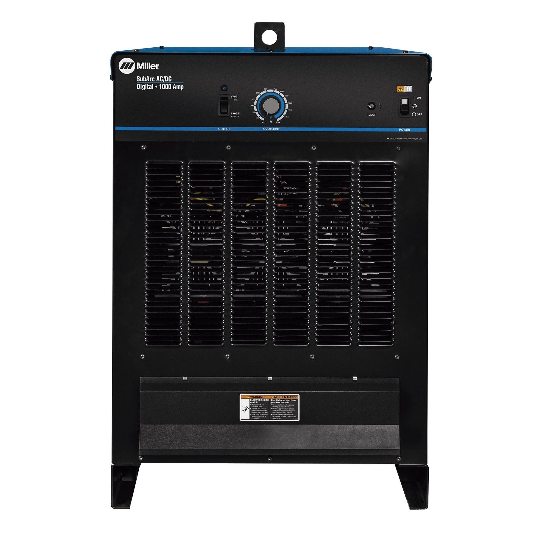

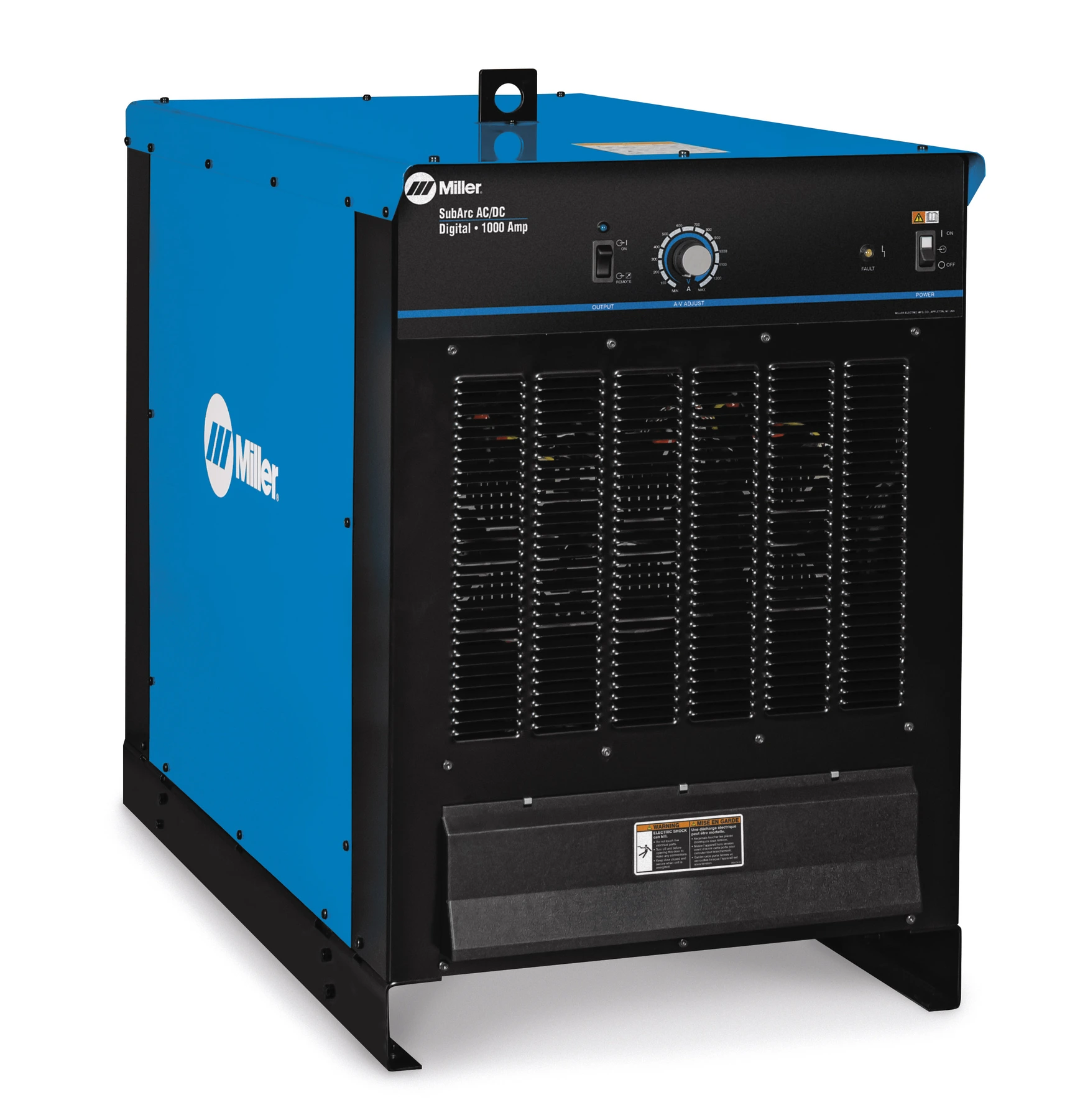

  • Miller's SubArc AC/DC Digital
    AC welding output enables the SubArc AC/DC to be used in tandem arc welding systems with a DC lead arc and AC trailing arc, or with AC / AC arc combinations. Using multiple arcs increases deposition rate, resulting in shorter welding cycles for thick weldments without compromising quality.
  • All AC balance control modes can be set.
    All AC balance control modes can be set on the SubArc Interface Digital. The easy-to-understand interface includes two DC modes and 12 best-practice AC balance settings. In multiple-arc configurations, the system automatically adjusts the phase shifting between power sources thereby eliminating arc interaction. There is no need to employ a laptop PC for complex wave shaping before operation.
    The easy-to-understand interface provides the operator with the necessary controls to set process parameters and control output. The power sources feature simplified parallel and tandem setups — just plug the cable into the appropriate connectors.
