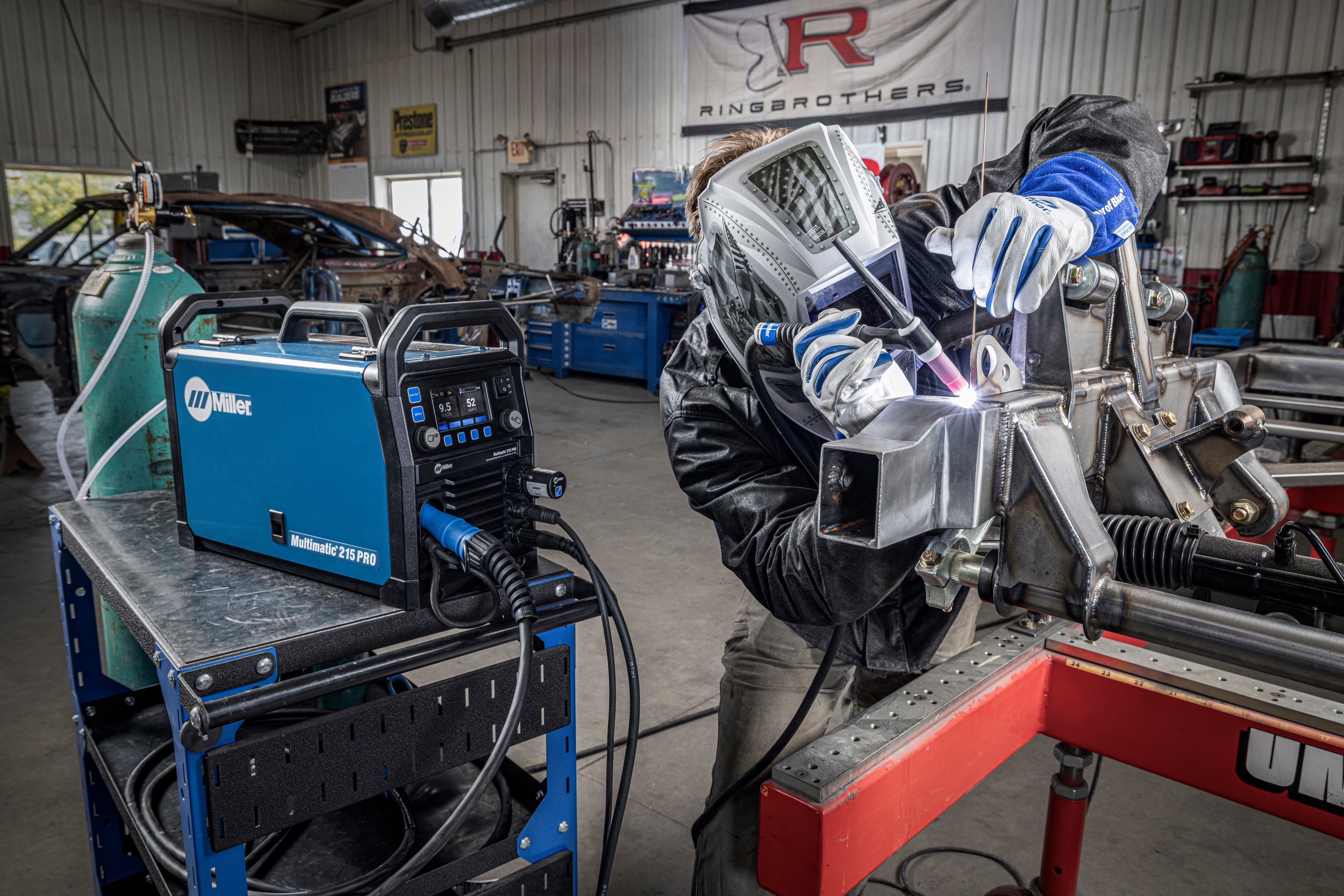

Multimatic® 215 PRO
This enhanced multiprocess welder gives you the flexibility to fuel your multi-hustle. Now equipped with Dyna-Pulse™ and more brand-new technologies, this enhanced multiprocess welder gives you the flexibility to fuel your multi-hustle.
Already have yours?
Stay up to date with the latest enhancements for free with a quick and easy software download.
Key Features and Benefits
Multiprocess
Quickly and seamlessly switch from MIG to TIG to stick.
Auto-Set™
Makes it easy to use on multiple materials and processes with the ability to fine-tune your settings.
Enhanced Portability
Each machine is lighter and more compact to make it easier to move with you.

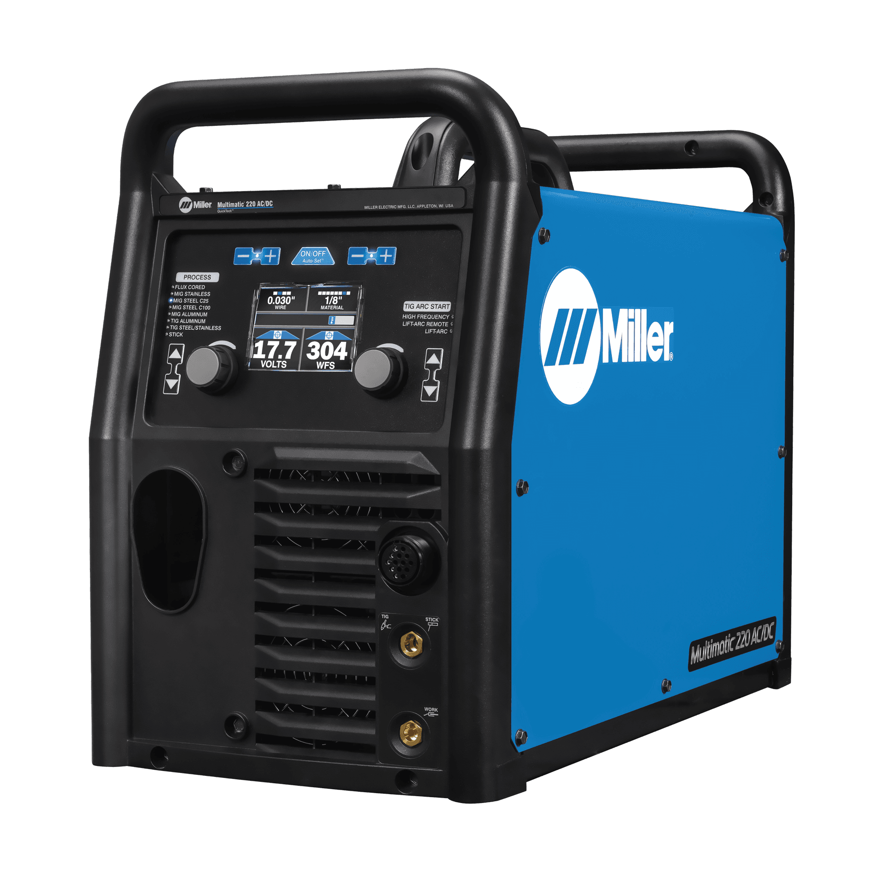

Compare All Multimatic® Products
Multimatic® CapabilitiesMultimatic® 215 PROMultimatic® 220 AC/DCMultimatic® 235Multimatic® 255
Welding Process
MIG/ Flux CoredXXXX
Pulsed MIGX  X
BeadVision™X
Memory SettingsX
DC StickXXXX
DC TIGXXXX
AC TIG X
DC Pulsed TIG XXX
Welding Capacity
Mild and Stainless Steel24 ga. min.
3/8 in. max.
24 ga. min.
3/8 in. max.
24 ga. min.
3/8 in. max.
24 ga. min.
1/2 in. max.
Aluminum18 ga. min
3/8 in. max
24 ga. min
3/8 in. max
18 ga. min
3/8 in. max
18 ga. min
1/2 in. max
Power
Input Power (V)120/240120/240240 or (204-276)208-575
Amperage Range (A)20-23020-23020-2355-350
