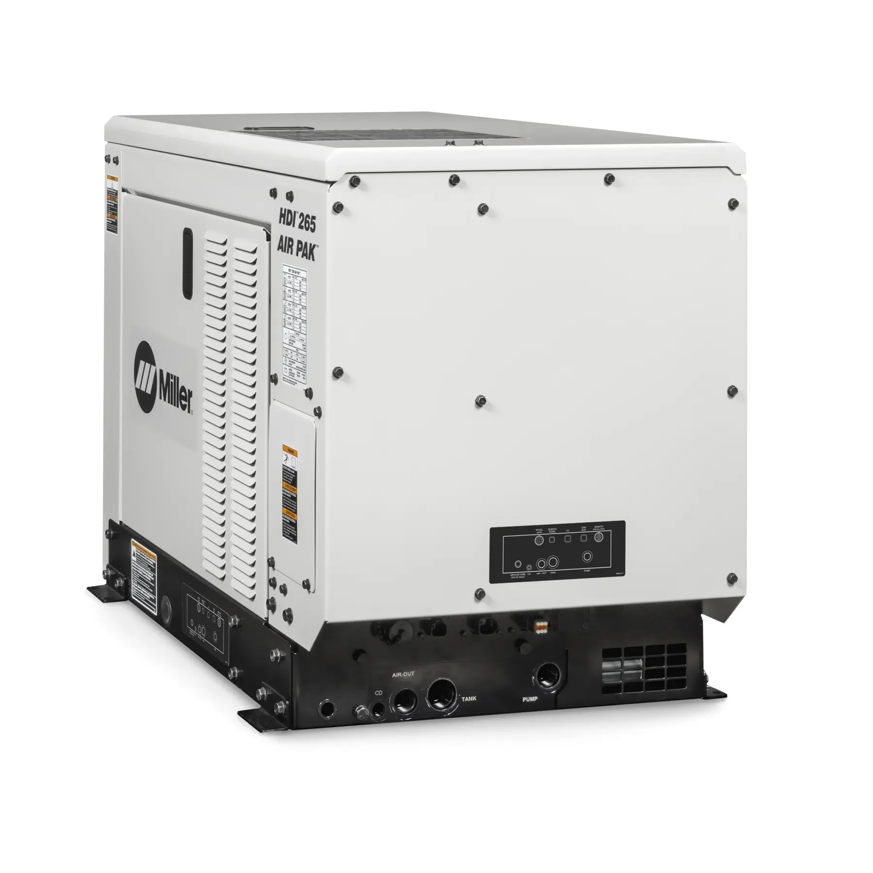

  • Air Compressor

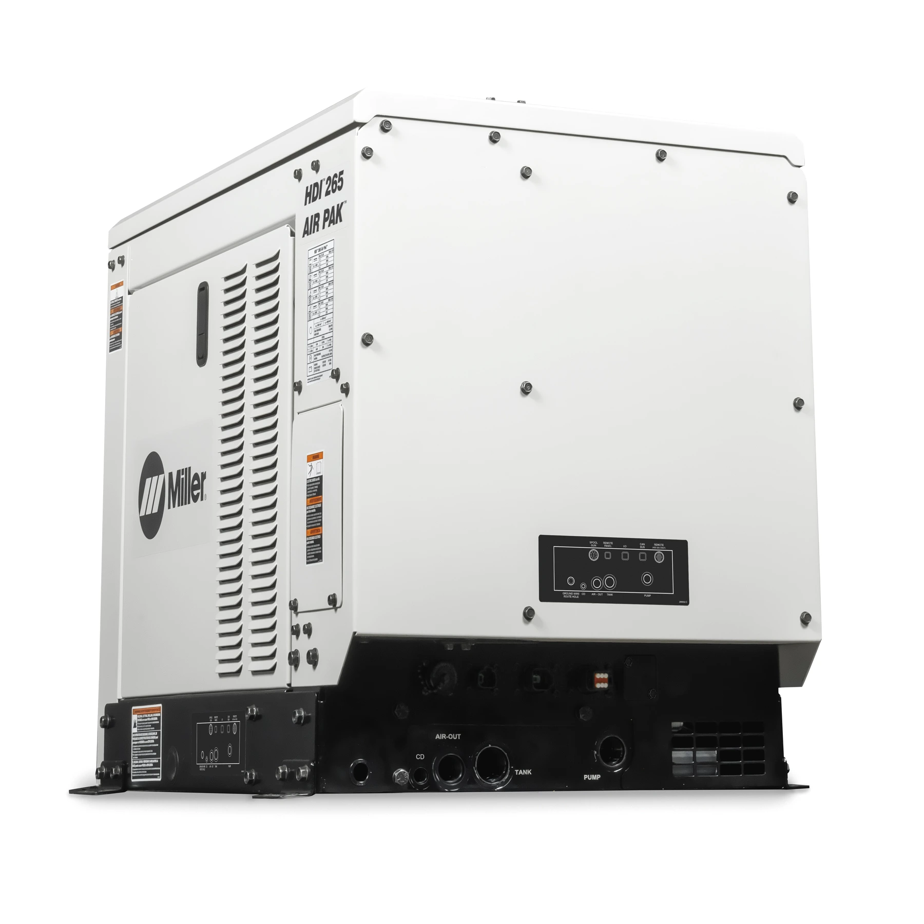

    Rotary-screw compressor with 40 cfm (265 model) or 60 cfm (325 model) can power virtually any air tool, including most one-inch impact wrenches. The rotary-screw compressor reliably provides air on demand. Compressor oil heater included.
  • Battery Charge/Crank Assist
    Produces up to 150 amps of DC current to quickly charge 12- and 24-volt batteries. It can provide jobsite equipment with weak batteries up to 300 amps of crank assist.
  • Generator power
    7,000-watt generator that can handle most jobsite electrical needs — electrical tools, lights, and more. The optional auxiliary power panel provides two 120-volt GFCI-protected duplex receptacles and one 120/240-volt receptacle with 60 Hz current.
  • Integrated Multiprocess Welding
    The HDI Air Pak provides multiprocess weld capabilities with 265 amps (265 model) or 325 amps (325 model) of output (100 percent duty cycle), so technicians are prepared for each welding job they encounter in the field.
  • Auto-Set™ Technology
  • Direct Spool Gun Connection
    Make it easy to weld aluminum. Expand the types of jobs you can take on. Adapters are no longer required with the integrated 10-pin connection. Optimized for Spoolmate™ and Spoolmatic® spool guns.
  • Hydraulic Cooling Only Mode
    When output capabilities are not needed, disable the drive motor of the HDI Air Pak to keep the cooling system operating and cool hydraulic fluid when only other auxiliary hydraulic equipment is needed.
