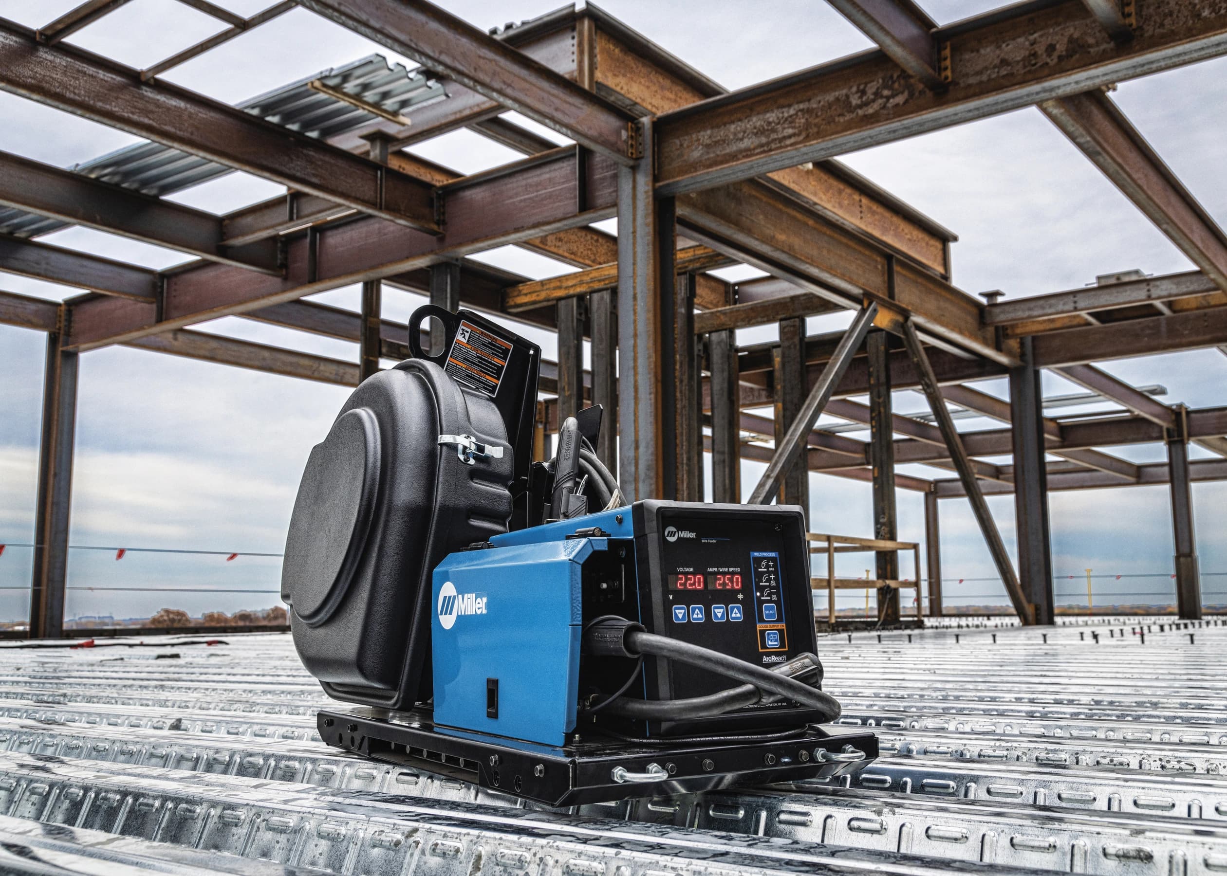

How does ArcReach technology help welders?
The technology makes it easier for operators to adjust parameters and processes at the weld joint so they can do their best work, without the hassle of frequent walks back to the power source. It also improves welder safety on the jobsite, since operators can stay put and avoid slip, trip and fall hazards. ArcReach technology offers point-of-use control (via a wire feeder or stick/TIG remote) without the need for a control cable. This allows the welder to make parameter adjustments, process changes and process selection at the weld joint. Operators can change parameters such as wire feed speed, voltage, amperage and arc control settings with the push of a button. In addition, ArcReach welding power sources that offer a polarity reversing model also allow operators to switch polarity with the push of a button where they are welding, so they don’t have to swap cables to change polarity. ArcReach systems detect electrode polarity and the connected ArcReach accessory and will set the power source to the correct process automatically.

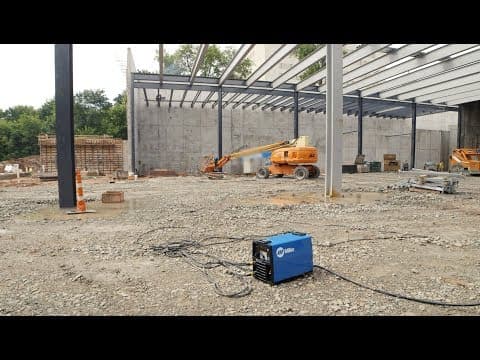

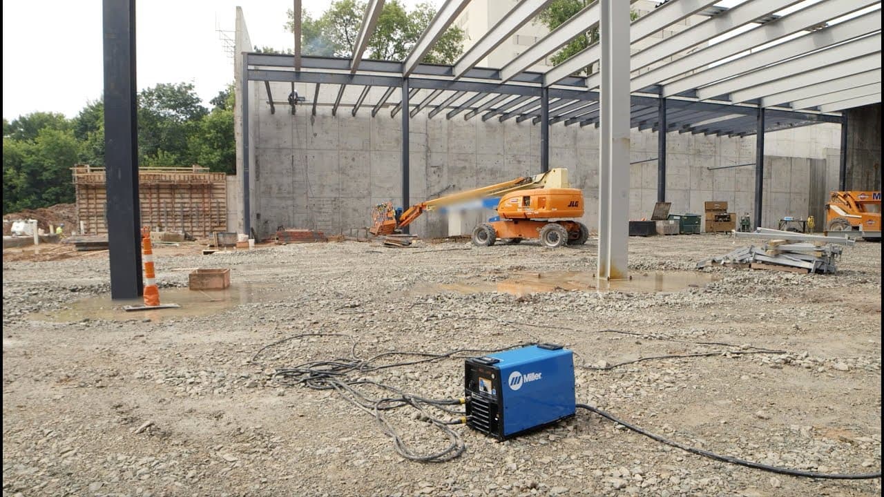

Do I need to be able to see the power source to use ArcReach technology, and how far away will it work?
The technology does not require line of sight between the power source and the accessory. This is because the remote control capabilities are provided by the weld cables as opposed to using radio waves, which can be disrupted by obstructions or distance. As long as the weld cables are properly sized for the job, they have the ability to communicate to the power source up to several hundred feet away even without a direct line of sight.

Can I use ArcReach accessories with non-Miller welding equipment?
ArcReach wire feeders function like volt-sensing wire feeders on non-ArcReach or non-Miller equipment. However, the ArcReach Stick/TIG Remote and ArcReach Heater accessories are not compatible with non-ArcReach power sources.
