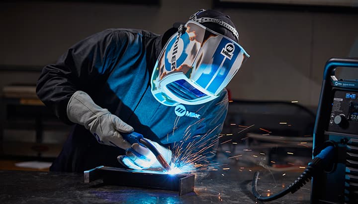

Proper personal protective equipment
A common safety fault when welding in the shop is not wearing the right PPE. Arc welding produces sparks and spatter — and emits intense rays that pose several hazards to unprotected skin and eyes.
Shorts, short sleeves and open collars leave you vulnerable to burns. Instead, wear flame-resistant clothing that covers your skin, button your cuffs and pockets, and avoid pant cuffs to prevent them from catching sparks.
When it comes to footwear, high-top leather shoes or boots offer the best protection. Tennis shoes and other cloth shoes are inadequate because they can catch a spark and smolder unnoticed. Plus, they can melt and stick to your skin.
Always wear proper gloves when welding or handling materials to protect your hands from burns. Mechanic-style gloves are not recommended for welding, as they are not flame resistant. There are many application-specific gloves available that provide the right protection, comfort and dexterity for welding.
According to the National Institute of Safety and Health (NIOSH), about 2,000 U.S. workers sustain an eye injury every day that requires medical treatment. The majority of these injuries result from small particles striking the eye and thermal burns that can happen while welding if not properly protected.
Even brief exposure to the arc’s radiation can cause a burning sensation or eye irritation commonly referred to as arc flash. Repeated exposure to arc rays can lead to permanent injury, so always wear proper face and eye protection including safety glasses underneath your welding helmet, even for a quick tack weld.
Auto-darkening helmets offer the best solution if you weld with different processes or parameters, and there are many types available. Some are more basic for the value-minded welder, and others have the latest technologies and features such as higher switching speeds, more arc sensors, grind modes or built-in grind shields, improved lens technology and more. Auto-darkening helmets must comply with the safety and protection requirements of the American National Standards Institute (ANSI).
