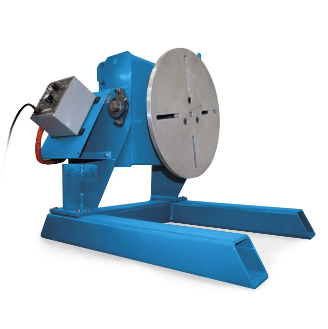

  • JP-500 Series Models
    JP-500A Speed range is 0.07 to 3.6 RPM through a 1-turn potentiometer JP-500B Speed range is 0.09 to 4.3 RPM through a 1-turn potentiometer JP-500C Speed range is 0.11 to 5.4 RPM through a 1-turn potentiometer JP-500D Speed range is 0.14 to 7.2 RPM through a 1-turn potentiometer JP-500E Speed range is 0.22 to 10.8 RPM through a 1-turn potentiometer
  • Specifications
    500 lb. (225 kg) weight capacity with faceplate in the vertical position at 4 in. center of gravity, 1000lb (450 kg) weight capacity with faceplate in the horizontal position at 4 in. center of gravity, 105-degree faceplate tilt from vertical to 15 degrees past horizontal, 18 in. diameter aluminum faceplate with 4 tooling slots, 5/8 in. ID spindle thru-hole, Forward and reverse toggle switch, 500 Amp ground, Weight: 350 lbs.
  • Options
    9 in., 3 jaw chuck, 14 in., 3 jaw chuck, On/off corded foot switch, Variable speed corded foot switch.
  • 3 Year Warranty
