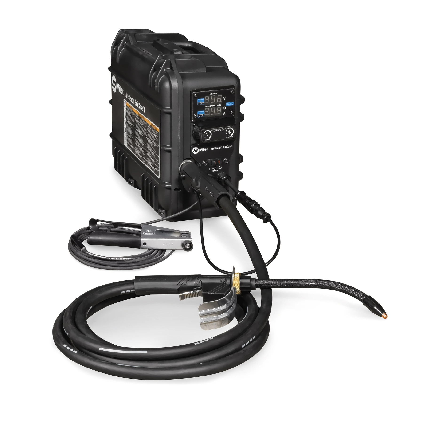

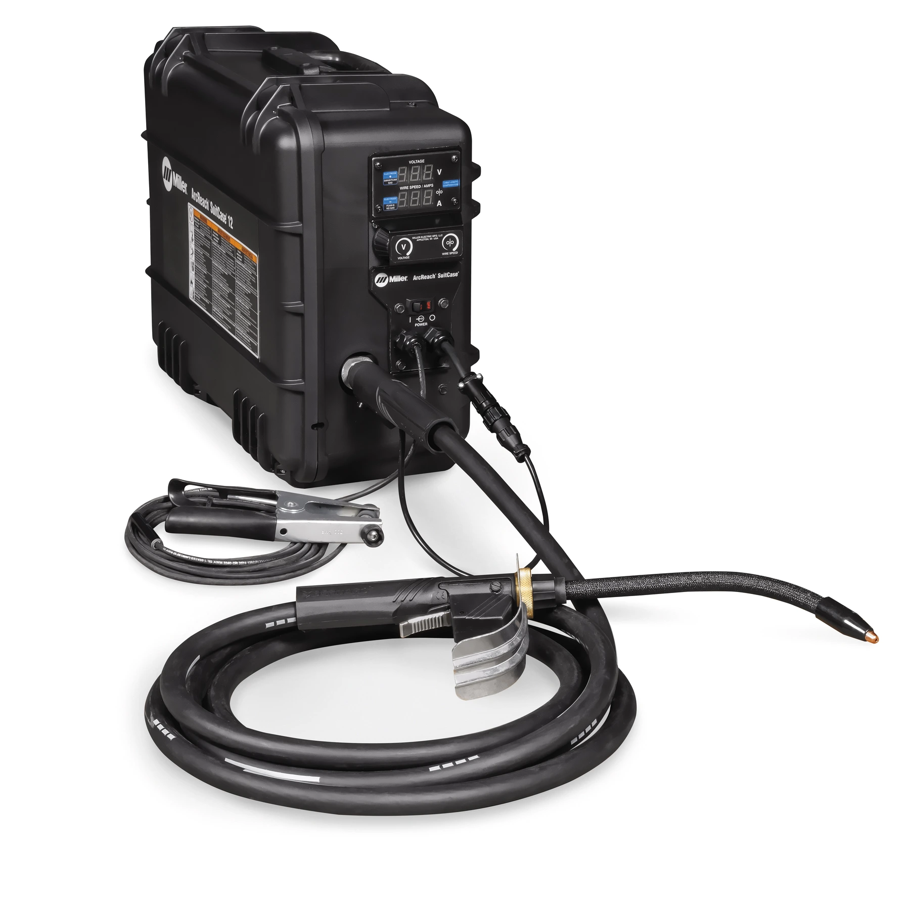

    12VS model is sized for an 8- or 12-inch spool of wire. 12-inch spools are the most common in structural steel and fabrication.
  • Extreme Reliability
    Potted and trayed main printed circuit board for the harshest environment adds exceptional reliability. Board has full-trigger isolation so a shorted gun trigger will not affect feeder operation. Gun locking tab works with guns having corresponding locking grooves to prevent gun from being pulled out if the feeder is dragged by the gun. Gas inlet recessed into back of case is protected from incidental contact by the weld cable, ensuring consistent and contaminant-free shielding gas delivery to the gun. Double-filtered gas valve helps keep dirt from clogging and affecting gas flow.
  • Unique and Durable Case
    Impact-resistant, flame-retardant case provides strength and durability, and protects components and welding wire from moisture, dust and other contaminants. Built-in slide rails allow you to drag the feeder into position for welding. Innovative feeder door design allows you to change wire while feeder is standing upright or laying down.
  • Scaled Wire Pressure Knob
    Provides easy adjustment and consistent pressure on the drive rolls and wire.
  • Digital Meters with SunVision™
  • Ultra-low Drag Inlet Guide Pins
    Makes loading the wire easy and does not deform the wire on the way into the drive rolls improving wire feeding performance.
