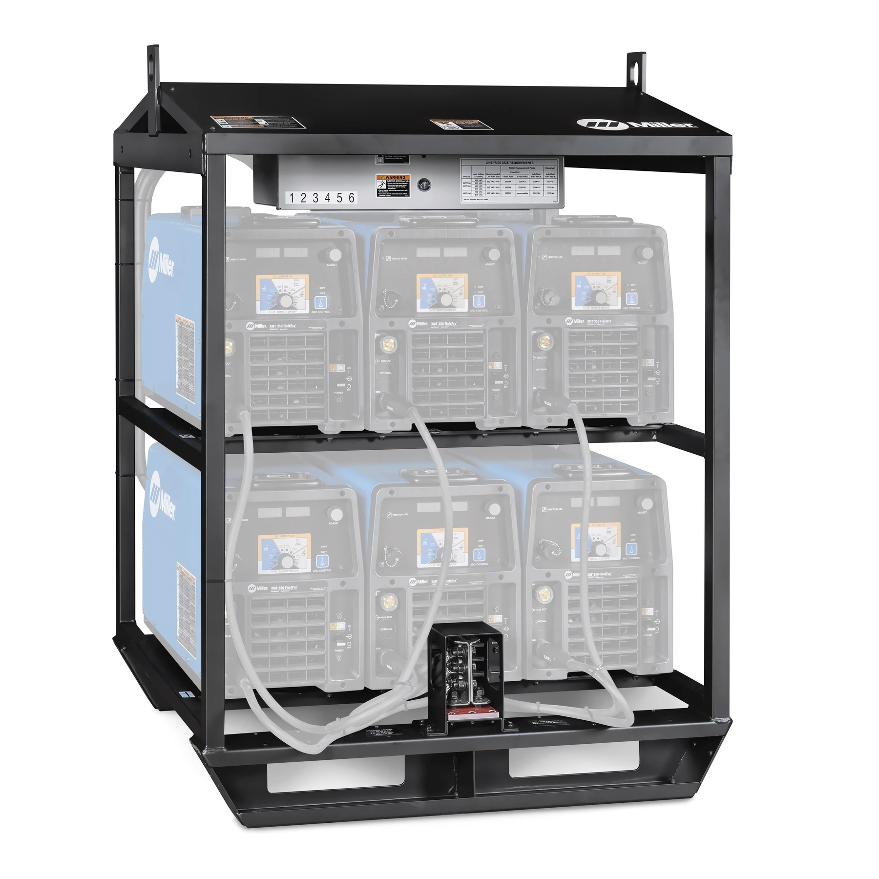

  • Customize Your System with Different XMT® Inverters
    Custom build your own system by mix and matching XMT® 304, 350, 450 CC/CV, 350 VS, 350 MPa and 450 MPa. Rack holds a maximum of four of the XMT 450 models.
  • Meets NEC requirements
    Meets NEC requirements when properly installed and utilizing recommended primary circuit protection and proper fuse selection for primary power applied to rack.
  • Fuses meet IP-20 finger safe rating
    Fuses meet requirements of IEC 60529 for IP-20 finger safe rating. Miller inverter racks are the only racks on the market to provide IP-20 finger safe rated fusing.
  • Simple Fuse holders
    Fuse holders are designed to accommodate fuses for both 300 A (208–575 VAC) and 450 A (380–575 VAC) inverters in all voltage ranges applicable to power source.
  • Optional Running Gear
    All racks can be equipped with optional running gear. The large five-inch diameter wheels enables the rack to be moved over grating and driveway gravel.
