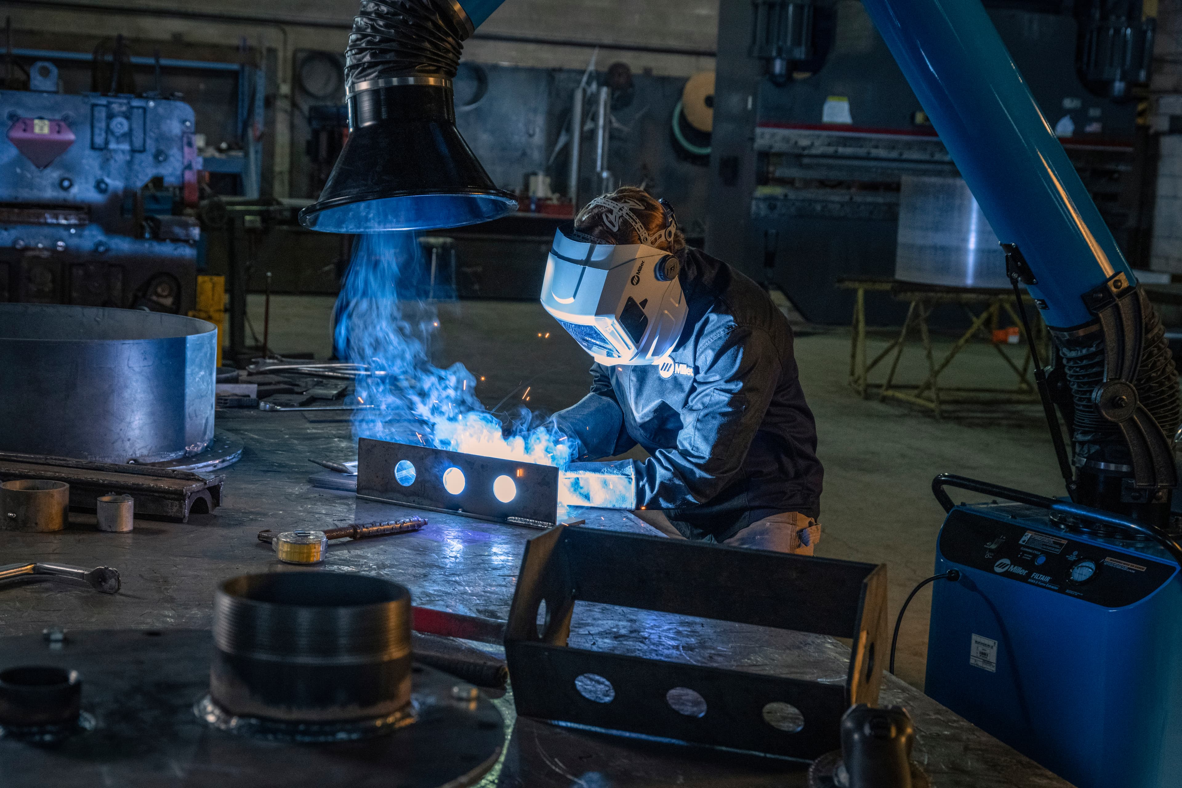

Best Practice #3: Use High-Vacuum Source Capture Whenever Possible
When process modifications cannot sufficiently reduce weld fumes, engineering controls are often the next step. One of the most effective engineering controls is source capture, which removes contaminants before they reach the welder's breathing zone.
Fume extraction guns capture fumes directly at the source, around the weld pool. These systems connect to high-vacuum extraction equipment designed to remove fumes very close to where they are generated, helping prevent contaminants from spreading throughout the facility.
Modern extraction guns have evolved to improve operator comfort and maneuverability while continuing to provide effective source capture. They are often best suited for flat, in-position welding applications.
Best Practice #4: Use High-Volume Source Capture for Larger Applications
For operations where fume extraction guns are not practical, low-vacuum/high-volume extraction systems offer another effective source capture solution. These systems use extraction arms, hoods or centralized ducted systems to pull fumes away from the operator's breathing zone.
Compared to high-vacuum systems, high-volume systems move larger amounts of air and provide larger capture zones. Options include mobile units, stationary systems and centralized extraction solutions connected to facility ductwork.
When using extraction arms, proper positioning is critical. The hood should generally be placed above the arc at an angle of approximately 45 degrees and positioned roughly 12 to 18 inches from the welding arc. As operators move throughout the weld, the arm should be repositioned to maintain capture effectiveness.
For automated welding environments, overhead hood capture systems can also help manage weld fumes and may be integrated into larger centralized extraction systems.
