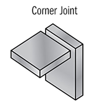

How to weld a corner joint
When pieces are joined at 90 degrees and take the shape of an L, they form a corner joint. These joints are easy to assemble and require little, if any, edge preparation. Corner joints are often used for projects that require a square frame, such as fabricating a weld table.
Proper fit-up is important. If your project requires a 90-degree angle, ensure the pieces are square and account for potential distortion during welding. Heat input can cause the angle to shift depending on how the joint is prepared. Using a jig or fixture to hold the parts in place is one effective way to maintain alignment and minimize distortion.
gjointdesignscornerjoin350
Choosing an open corner joint vs. a closed corner joint
The two types of corner joints are open corner and closed corner. In a closed corner joint, the edge of one piece lies flush against the edge of another. An open corner joint is when two edges meet at their corners and there’s an opening where you can see the thickness of each metal.
Choosing between an open and closed corner joint often comes down to material thickness and the strength required for the application.
With open corner joints, you may need to increase travel speeds when welding thinner materials to prevent burn-through. Open corner joints create a V shape and may require more weld deposit.
If you’re welding a closed corner joint, you can grind the weld face to create a smooth transition from the weld to the base material.
Tips for welding corner joints
Tip #1: Increase travel speeds on thinner materials with open corner joints to prevent burn-through.
Tip #2: Ensure proper fit-up to meet required angular dimensions and reduce distortion.
