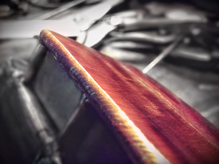

  • Less heat, less warping: Lower melting temps mean less heat, which equals less warping when compared to TIG with, say, an ER70 rod. The silicon bronze rod’s lower melting point makes it ideal for joining together thin sheet metal, galvanized steel, and nuts and bolts, too.
  • Better finish: After blazing, you can still sand and paint it just like the surrounding metal.
  • Fewer issues with galvanized steel: You won’t get the “popping” and tungsten blowouts that are normally associated with TIG welding galvanized steel because the silicon bronze flows at a temperature lower than the zinc-heavy coating. Zinc is relatively nasty stuff that causes a mess.

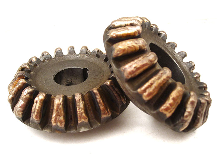

Silicon bronze offers excellent wear properties for dissimilar metals. For example, I rebuilt my dad’s snowblower using a “cold” braze — just warm enough for the silicon bronze to bond. After filing the teeth to fit, those gears have worked perfectly for five or six seasons.

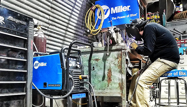

  • DC negative: Common choice for TIG brazing with silicon bronze, like TIG welding steel.
  • AC option: Alternating current’s cleaning process helps when brazing some materials.
Pro tip: Experiment with both settings to see what works best. Machines like the Multimatic® 220 AC/DC multiprocess welder offer flexibility for both AC and DC TIG.
