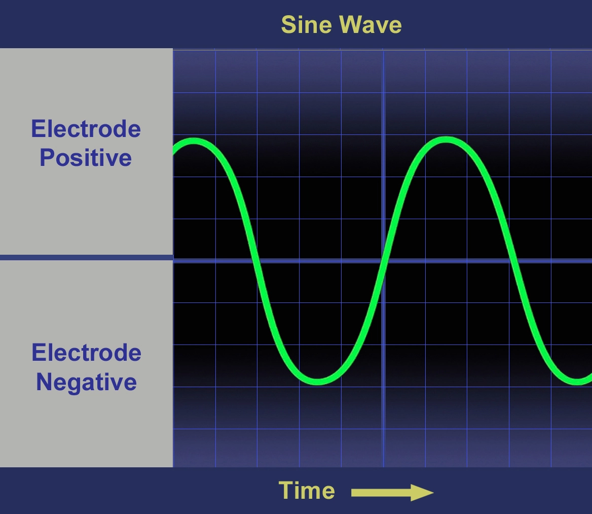

The generators that make power for the nation’s grid are timed at 60 Hz, and the current changes direction in flowing, ‘bell-shaped’ curves, or sine waves.
tig-wave-002
Sine waves produce a very ‘smooth’ welding arc, but it is sometimes beneficial to alter this basic waveform.

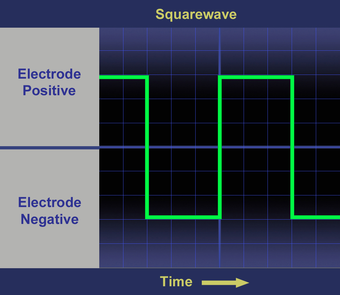

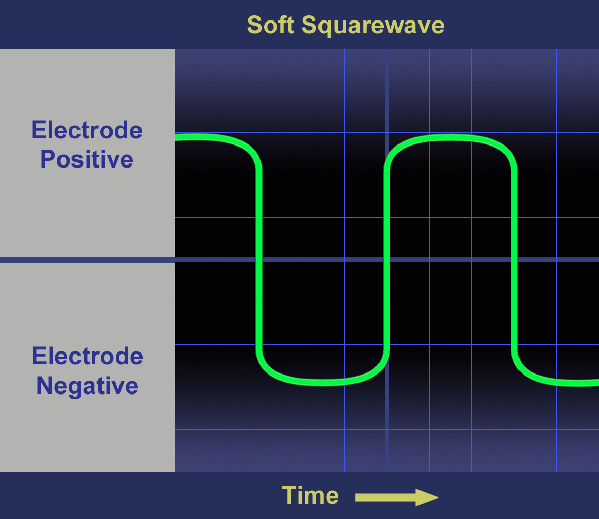

Square waves were the first alternative for the sine wave. The area inside the graph of the waveform represents the amount of heat put into the metal. It’s easy to see that a square wave transfers considerably more heat than a sine wave. Because the switching is nearly instantaneous, it eliminates the waxing and waning portions of the cycle.
When you’re welding, the square wave arc has a different ‘feel’ than a sine wave. Plus, the increased energy transfer allows for a faster travel speed.
tig-wave-003
tig-wave-004

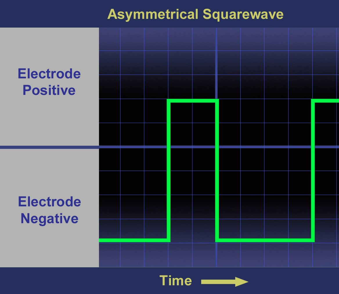

Initially the square wave waveform was symmetrical — having an equal amount of the current flow in both the EN and EP mode. Today, it's possible to independently vary the percentage of time the wave was in EN and EP. This allows the operator to easily change the ‘balance’ between the penetration developed in the EN portion of the cycle and the cleaning action of the EP portion. As the technology developed further, the amplitude of current in EN and EP could be adjusted independently too. Having precise control of these parameters enables the operator to optimize the arc for specific applications.

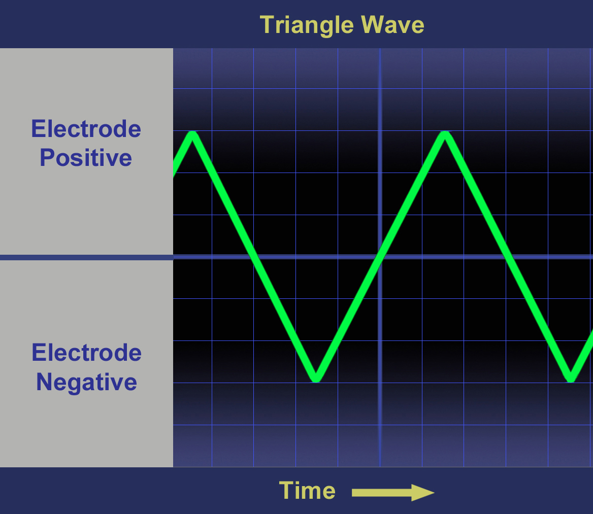

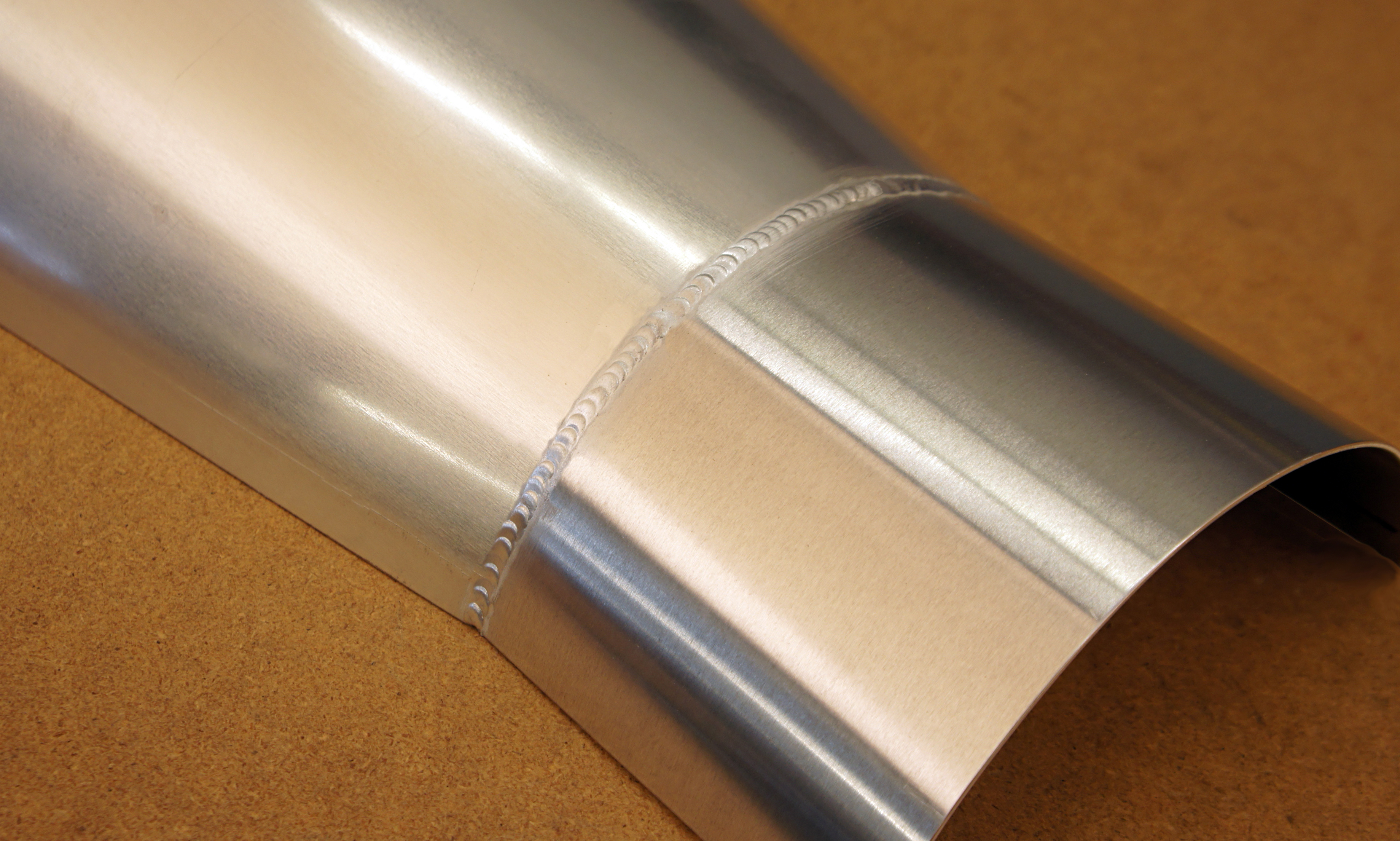

Inverter technology also makes another unique waveform possible: the Triangle wave. This waveform transfers an even smaller amount of heat into the material, which can help reduce distortion when welding very thin material.

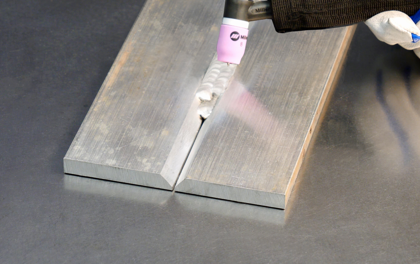

When welding metal at the upper limit of your machine’s capability, it may help to use an unbalanced cycle. By increasing the amount of time spent in the EN portion of the cycle, you can get a little more heat into the base metal, sometimes eliminating the need for preheating.
tig-wave-007

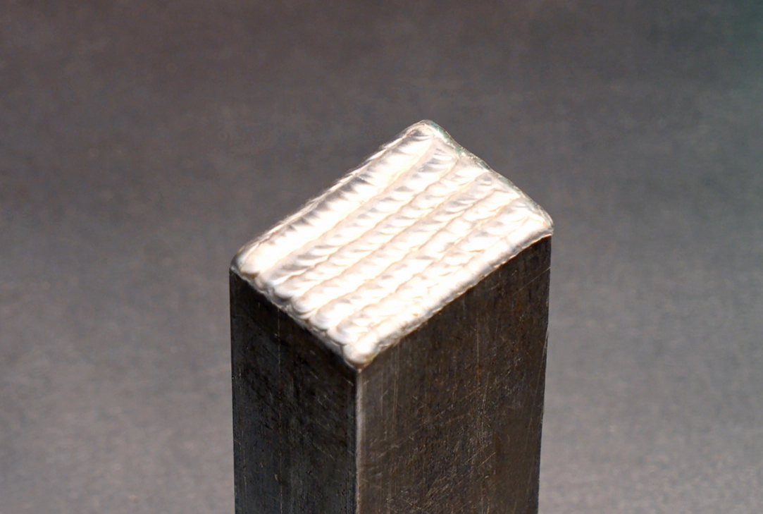

Another application where an unbalanced cycle helps is when you need to build up surface by welding. Boosting the EP portion of the cycle will result in a broad weld with shallow penetration.

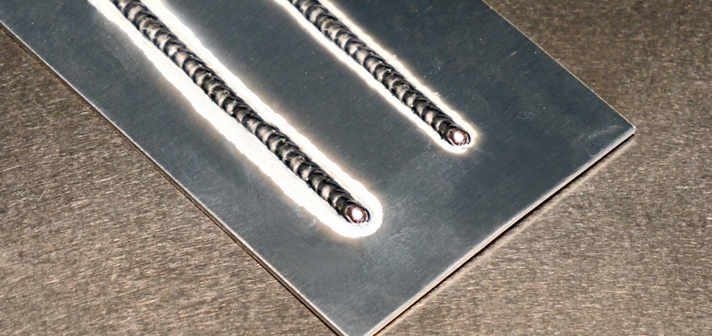

With all of the waveforms, you can change the balance between the EN and EP portion of the cycle. For most work, 75% EN is preferred, since 25% EP is usually sufficient for cleaning. Any more than that limits the total heat input, which could decrease the weld penetration.
There is a visual clue that shows how much EP cleaning action is present. If you look closely at an aluminum weld bead, you can usually see a ‘frosted’ area of metal right next to it. The greater the amount of EP current, the broader this frosted area will be. The photo below shows two extremes. I welded the bead on the right at 90% EN (10% EP), and made the bead on the left at 50%.
tig-wave-009
There is no benefit in using more EP than necessary, but impurities in or on the material can vary a lot, and a little experimentation will help you find the percentage that works best for a particular job. I use 75% EN for most of my aluminum welding, as seen in the photo below.
