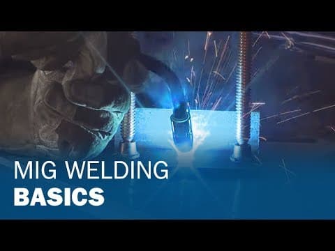

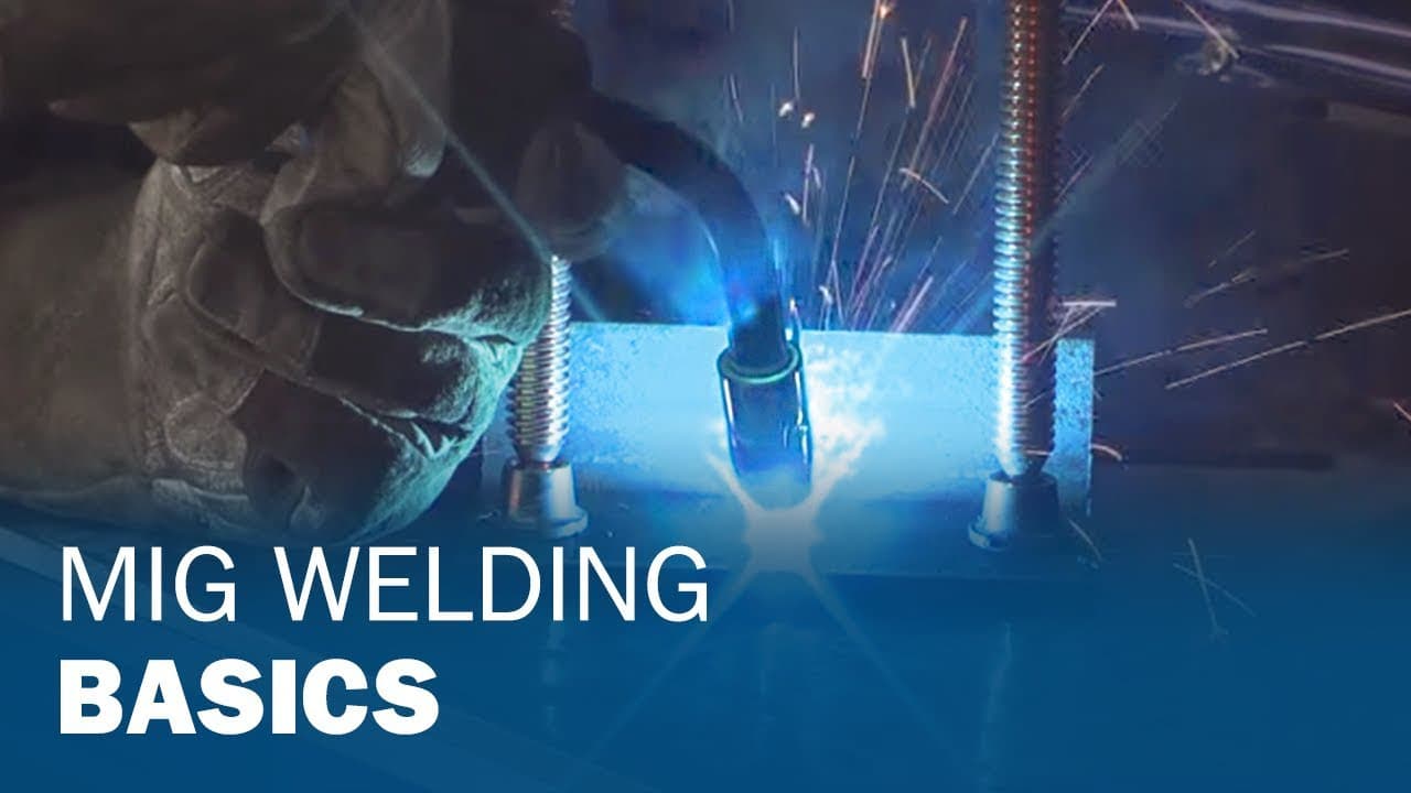

MIG Welding Basics
MIG power sources use a continuous solid wire electrode for filler metal and require a shielding gas delivered from a pressurized gas bottle. Mild steel solid wires are usually plated with copper to prevent oxidation, aid in electrical conductivity and help increase the life of the welding contact tip. The shielding gas protects the molten weld pool from contaminants present in the surrounding atmosphere. The most common shielding gas combination is 75% argon and 25% carbon dioxide. While welding outdoors, welders should use caution and prevent wind from blowing the shielding gas coverage away from the arc. Windshields may need to be used.

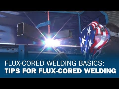

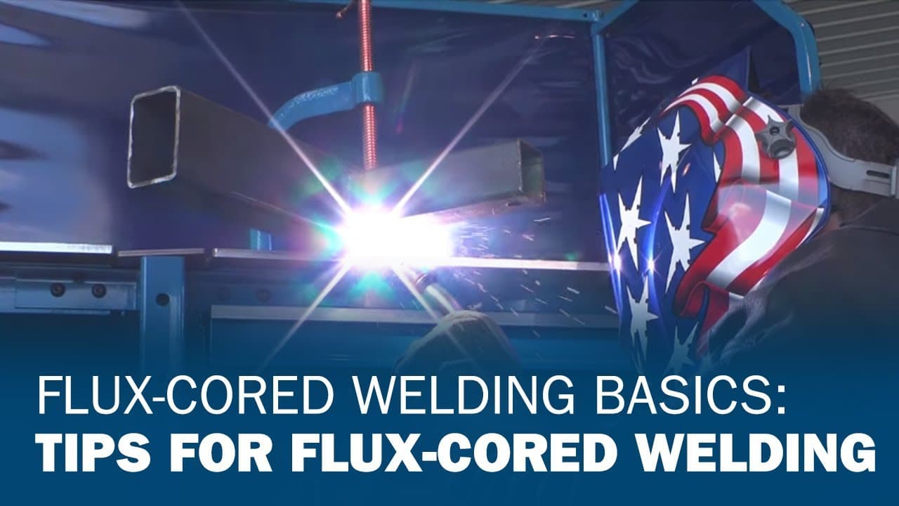

Flux-Cored Welding Basics: Tips for Flux-Cored Welding
Gas-shielded flux-cored wires require external shielding gas, and the slag is easy to remove. Consider using gas-shielded flux-cored wires when welding on thicker metals or in out-of-position applications. Gas-shielded flux-cored wires have a flux coating that solidifies more quickly than the molten weld material. As a result, it creates a shelf to hold the molten pool when welding overhead or vertically up.
Self-shielding flux-cored wire does not require external shielding gas because the weld pool is protected by gas generated when flux from the wire is burned. As a result, self-shielding flux-cored wire is more portable because it does not require an external gas tank.
