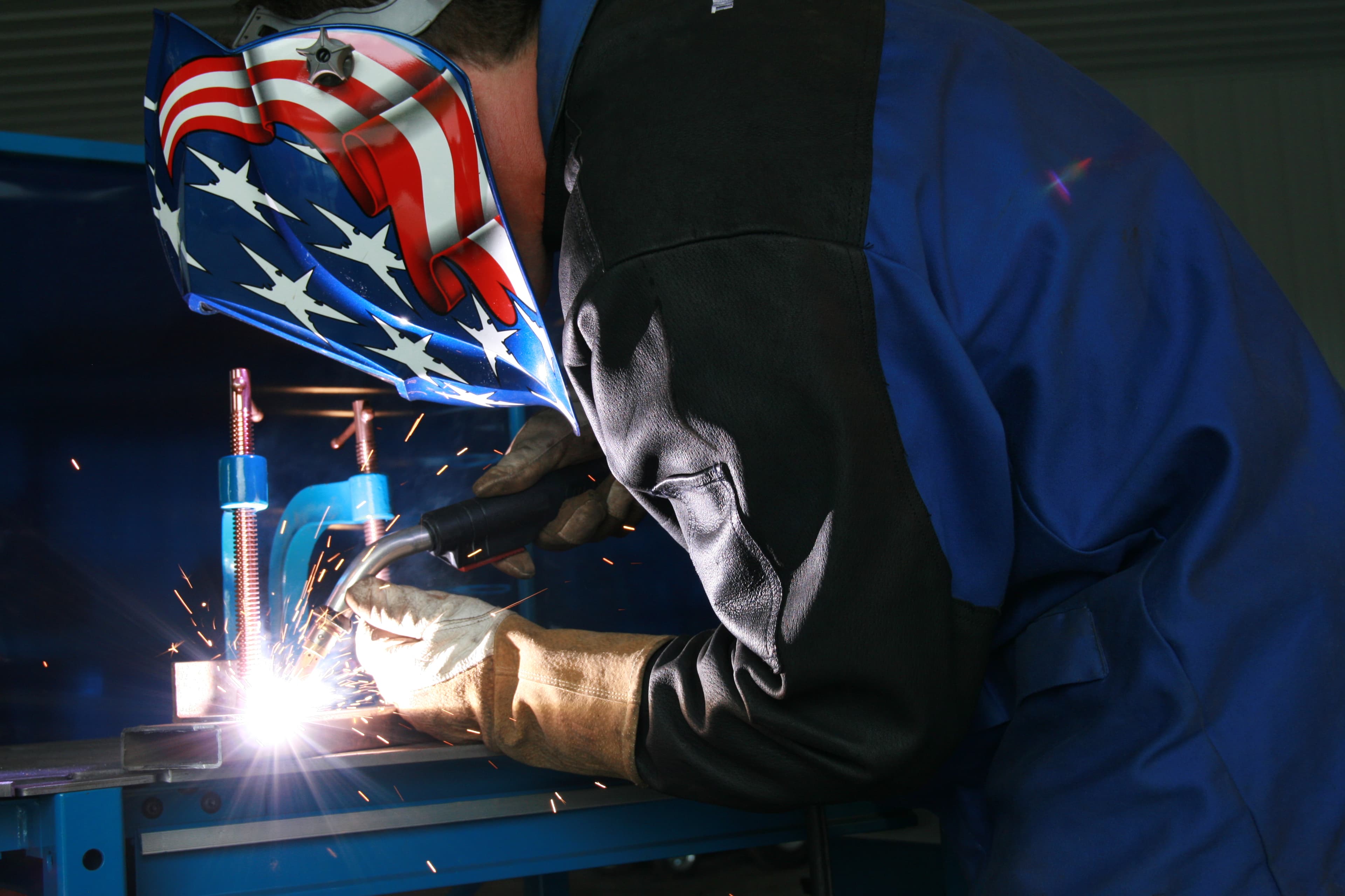

How to flux-core weld
Understanding positioning and angles is important to every welding process as these factors directly contribute to overall weld quality.
FCAW gun technique: push or drag?
With flux-cored welding, you should always use a drag (pull) technique. This involves pointing the tip of the welding gun back at the weld pool and dragging it away from the completed weld. An easy rule of thumb for remembering which technique to use is “If there’s slag, you drag.”
Use a standard travel angle
Travel angle is the angle relative to the gun in a perpendicular position within the plane of the weld joint. Normal welding conditions in all positions call for a travel angle of 5 to 15 degrees. Travel angles beyond 20 to 25 degrees can lead to more spatter, less penetration and general arc instability.
Correct work angles are relative to the welding position
The work angle is the gun position relative to the plane of the welding joint, and it varies with each welding position and joint configuration (see below).
Welding in a Flat Position
img9774jpg
For a butt weld (a 180-degree joint), hold the gun at a 90-degree work angle — the same angle from each workpiece. Direct the filler metal straight into the joint with a 5- to 15-degree travel angle. A small side-to-side motion with the gun can help fill a large gap or when making multiple passes. Pausing slightly at the sides of a weave bead can help avoid an undercut.

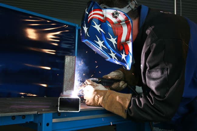

img9829jpg
For a T-joint (a 90-degree joint; the type of weld on this joint is called a fillet weld), position the gun at a 45-degree angle, or equal distance from each piece. When making multiple weld passes, adjust the work angles slightly toward one side and then the other to avoid uneven weld beads and undercuts.

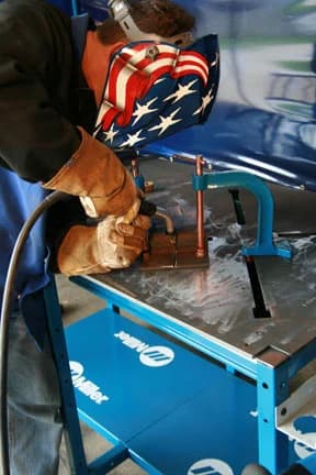

img9761jpg
For a lap joint (also a fillet weld), angle the gun between 60 and 70 degrees to direct more heat into the bottom piece of metal. The thicker the metal being welded, the greater the angle needed to ensure proper penetration and weld quality.

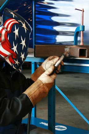

Horizontal position
Because of gravity, the gun work angle must be lowered slightly, by 0 to 15 degrees, so that the welding gun points upward toward the top piece of metal. Without changing the work angle, the filler metal may sag or roll over on the bottom side of the weld joint.
The travel angle generally remains the same as for a weld joint in the flat position.
When making multi-pass welds on thick metal or to bridge a slight gap where fit-up is poor, a slight weave may be used to fill a weld joint. A slight hesitation at the top toe of the weld helps prevent undercut and ensure proper tie-in of the weld to the base metal. Voltage and amperage settings for flux-cored welding in the horizontal position are usually the same or slightly less than settings for welding in the flat position.

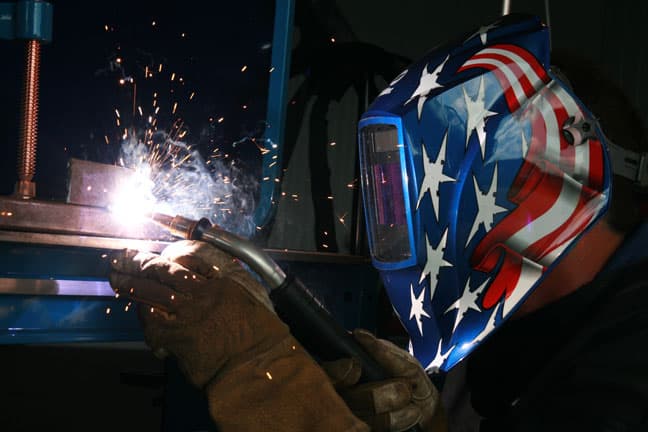

Vertical positions
Vertical welding, both up and down, can be difficult. This makes pre-weld setup very important for producing high-quality welds. Since you are fighting gravity, consider reducing the voltage and amperage 10 to 15 percent from the settings for the same weld in the flat position.
Vertical down technique: When welding vertical down, begin at the top of a joint and weld down, weaving slightly side to side. For thin metal where burn-through is a concern, keep the electrode wire on the leading edge of the weld puddle. This technique helps when welding thin metals because the arc penetrates less due to the faster travel speed.
Vertical up technique: This is like vertical down but can provide better penetration on thicker materials (typically 1/4 inch or more). The travel angle of the gun is a 5 to 15 degree drop from the perpendicular position. Use a slight weaving motion.

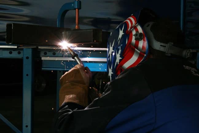

Overhead position
An overhead weld is the most difficult weld to make, and it should be avoided if possible. If you cannot avoid welding in the overhead position, try using the smallest wire possible, lowering your welding parameters by 15 to 20 percent, keeping your weaving to a minimum and maintaining a fast travel speed. Even following these tips, it still may be difficult to achieve a sound overhead weld.
