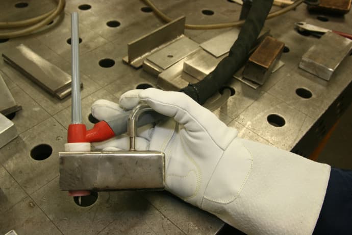

Gas lenses and trailing shields help protect the weld pool during cooling
Two components that you may not generally use in other TIG welding applications but are critical to the shielding process are a gas lens and trailing shields. A gas lens replaces the standard collet body and improves the flow and coverage of the shielding gas around the tungsten, arc and weld pool. Trailing shields can either be purchased or fabricated to match specific joint configurations and provide a continuous secondary shielding gas source to ensure the weld puddle and heat-affected zone stay protected until each drops below the 500- to 800-degree window.
Use a clean, nonporous plastic hose to transport all shielding gases as rubber absorbs oxygen that could contaminate the weld. Some welders will also use oversized cups to achieve additional coverage surrounding the weld, but this is only necessary within practical means.
