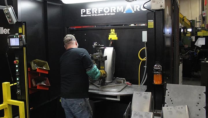

Welding automation
The trend toward automation has been on the rise for several years. It continues to gain momentum as companies seek greater throughput and a more competitive edge, at times with fewer employees. Increased Lean initiatives also support this shift, as companies seek ways to reduce bottlenecks, optimize workflow and create a more efficient welding operation.
Equipment manufacturers are making it easier than ever before to implement automation. Pre-configured weld cells allow companies to adapt the systems to a wide range of applications and welding operation sizes. In addition, readily available operator training and engineering software programs help simplify programming and the process of designing automation-ready parts. All of these factors make it easier to implement robotic welding.
Businesses of all sizes and capabilities can benefit from these pre-configured robotic welding cells. This includes large and small companies, those familiar with the technology and seeking to expand, and those new to automation. The result is the same: cycle time and utilization efficiencies gained through arc on-time and deposition rates that deliver faster overall production, with less variability and improved quality.
Additional benefits include:
  • A reduction in over-welding
  • Improved first-pass weld quality
  • Precision for complex welds or materials
  • Less scrap and rework
  • Lower overall costs
