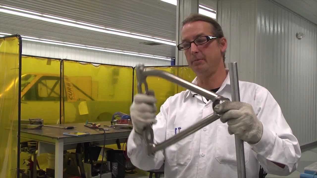

Upper control arms: Typical materials for these projects are mild steel and 4130 chromoly. The recommended welding process is DC TIG, with filler metals ER70S-2 for mild steel and ER80S-D2 for 4130.
Lower control arms: Mild steel and 4130 chromoly are the materials most often used in these projects. Recommended welding processes are MIG or DC TIG. Recommended MIG filler metal is .030 to .035-inch ER70S-6 for mild steel, and recommended TIG filler metals are ER70S-2 for mild steel and ER80S-D2 for mild steel/4130.
Spindles: Typical materials for these projects are mild steel, 4130 tubular fabricated and 4140 chromoly solid. Recommended welding process is MIG or DC TIG. Recommended MIG filler metal is .030 to .035-inch ER70S-6 for mild steel and recommended TIG filler metals are ER70S-2 for mild steel and ER80S-D2 for 4130 and 4140.
How to Build an Upper Control Arm: Part 1

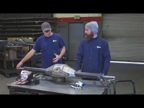

Wheelie bars (drag): Typical materials for these projects are 4130 chromoly and grade 9 titanium. The recommended welding process is DC TIG, with recommended filler metals ER80S-D2 for 4130 and ERTI-9 for titanium.

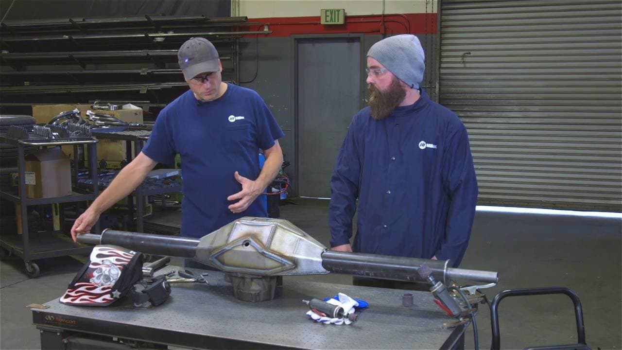

Lower control arms, trailing arms and track bars: Material for these projects is typically mild steel, with MIG or DC TIG as the recommended welding process. Recommended MIG filler metal is .030 to .035-inch ER70S-6, and recommended TIG filler metal is ER70S-2 or ER80S-D2.
Rear axle housing: Mild steel is most commonly used, with MIG or DC TIG as the recommended welding process. Recommended MIG filler metal is .035-inch ER70S-6, and recommended TIG filler metal is ER70S-2 or ER80S-D2.
Welding a Rear End Housing at Camburg Engineering with New Multimatic 215 Multiprocess Welder
