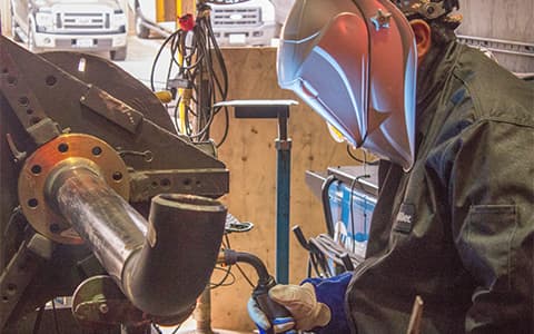

Welders have SIM cards with preprogrammed settings that they take from booth to booth. They insert the card into any machine for quick and easy setup. That’s important in a pipe shop that runs multiple shifts of operators each day.
“It was an everyday occurrence where we were losing about a half an hour per operator just to get that machine set to where the operator wanted to run it,” Koprivnak says. “Now, you just put in your SIM card, your parameters are already set, you pick what number you want and you’re off and welding. It’s really not even minutes — it’s almost down to seconds now.”
The machines also offer easy process changeover. Exterran welders can switch from MIG to flux-cored with the quick push of a button, since they use RMD for the stringer (another term for the root bead) and flux-cored for the cap pass.
