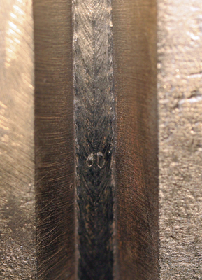

Note that using the RMD™ process without a backing gas does produce a small amount of oxide scale on the backside of the weld, which usually flakes off as the weld cools. While within the standards for oil and petrochemical applications, it does not meet the “high purity” standard found in the pharmaceutical, semi-conductor or food industries.
rmdrootbeadjpg
The RMD™ process creates a root bead that matches the quality of a GTAW root bead. Unlike GTAW, which requires a high learning curve, the new GMAW process enables an apprentice operator to make production-quality welds after two days of training.
