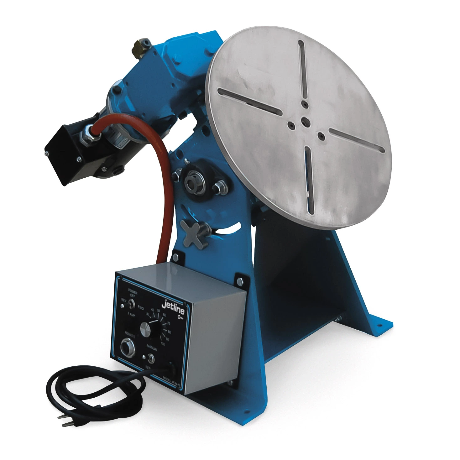

  • ZB-300 Series
    ZB-300A is designed for manual and automated welding applications. Speed range is 0.2 to 11 RPM through a 1-turn potentiometer. ZB-300B is designed for manual and automated welding applications. Speed range is 0.07 to 3.6 RPM through a 1-turn potentiometer. ZB-300C is designed for manual and automated welding applications. Speed range is 0.4 to 24 RPM through a 1-turn potentiometer. ZB-300XC is designed for precision, automated welding applications with speed accuracy +/- .1%. Includes 9700T Control and integrated encoder. Three Speed ranges available: 0.024 to 12 RPM, 0.03 to 16 RPM, or 0.04 to 24 RPM.
  • Options (sold separately)
    5 in., 3 jaw chuck, 9 in., 3 jaw chuck, 14 in., 3 jaw chuck, On/off corded foot switch, Variable speed corded foot switch.
  • Specifications
    300 lb. (136 kg) weight capacity with faceplate in the vertical position at 4 in. center of gravity, 450 lb. (204 kg) weight capacity with faceplate in the horizontal position at 4 in. center of gravity, 90-degree faceplate tilt from vertical to horizontal, 12 in. diameter aluminum faceplate with 4 tooling slots, 5/8 in. ID spindle thru-hole, Forward and reverse toggle switch, 500 Amp ground, Weight: 75 lbs.
