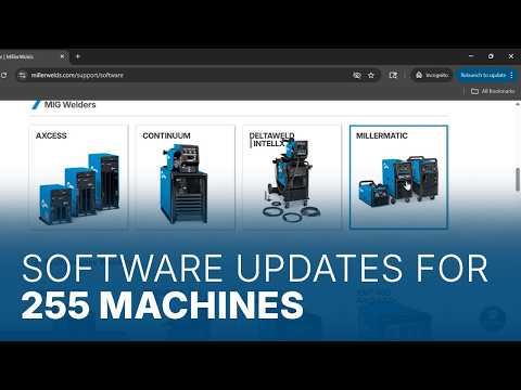

Video
How to Update Multimatic 255 and Millermatic 255 Software
