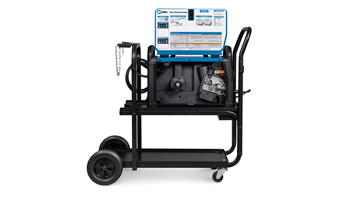

millermatic-211-pro-on-cart-side-01-open_720x410

Voltage and wire speed settings
Voltage and wire speed depend on numerous variables, including metal thicknesses, type of metal, joint configuration, welding position, shielding gas and wire diameter speed (among others).
Miller provides two tools to simplify setting proper voltage and wire speed:
1. A convenient reference chart, located on the inside of the door housing the wire feed system.
2. Miller® Auto-Set™ technology, which is a feature on Millermatic and Multimatic models, like to Millermatic 211 PRO. Using either method will get you in the ballpark. From there, you can fine-tune the welding arc to your personal preferences. For more detail on setting your parameters, check out this article.
