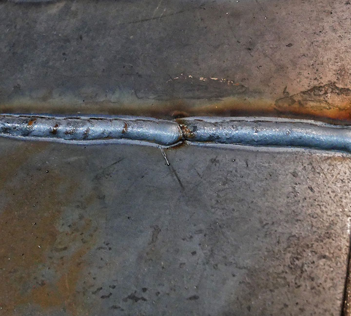

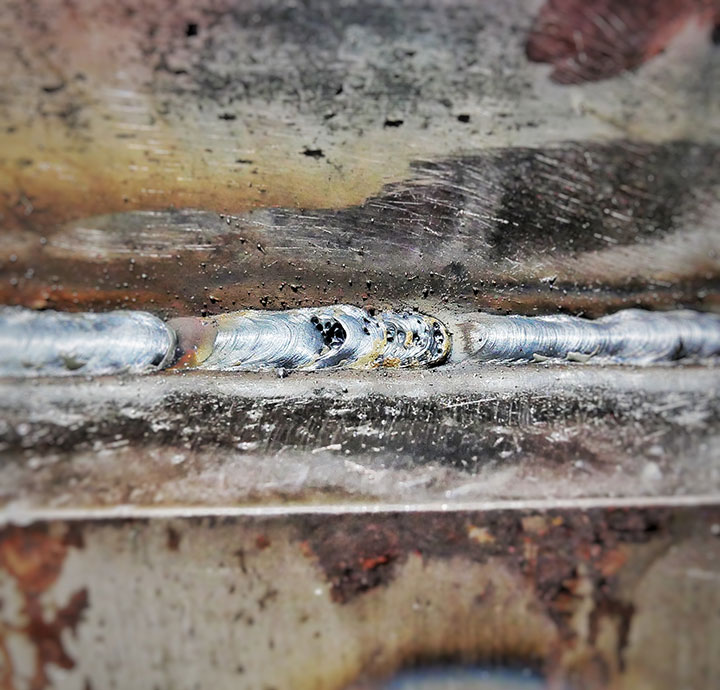

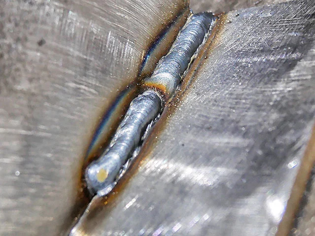

Porosity in welding
Porosity, one of the most common MIG welding defects, is the result of gas becoming trapped in the weld metal. Inadequate shielding gas coverage is among the biggest culprits, and this can be addressed in several ways. First, check the regulator or flow meter for adequate gas flow, increasing it as necessary. Check the gas hoses and welding gun for possible leaks, and block off the welding area if drafts are present.
To promote proper shielding gas coverage, it’s also important to use a large enough nozzle to shield the weld pool fully with gas, keep the nozzle clean and free of spatter, and follow the manufacturer’s recommendation for proper contact tip recess.
Other causes of porosity include:
  • Dirty base material.
  • Excessive gun angle.
  • Extending the wire too far from the nozzle. A good rule of thumb is to extend the wire no more than 1/2 inch past the nozzle.
  • Wet or contaminated shielding gas cylinders. Replace damaged cylinders immediately.

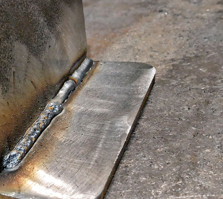

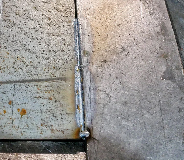

Lack of fusion and cold lap
The terms cold lap and lack of fusion are often used interchangeably. However, they are slightly different and can happen independently or in conjunction with one another in MIG welding.
Lack of fusion is the result of the weld metal failing to fuse completely to the base metal or to the preceding weld bead. It’s caused primarily by improper welding gun angle or incorrect travel speed. Avoid this problem by maintaining a 0- to 15-degree gun angle during welding and keeping the arc on the leading edge of the weld pool. It’s sometimes necessary to increase travel speed to maintain correct arc position. Insufficient heat in the weld can also cause lack of fusion. This can be remedied by increasing voltage settings or wire feed speeds.
Using incorrect travel speeds can also result in cold lap, which causes the weld to overfill and essentially overlap on the toes of the weld. Increasing travel speed helps prevent this problem.

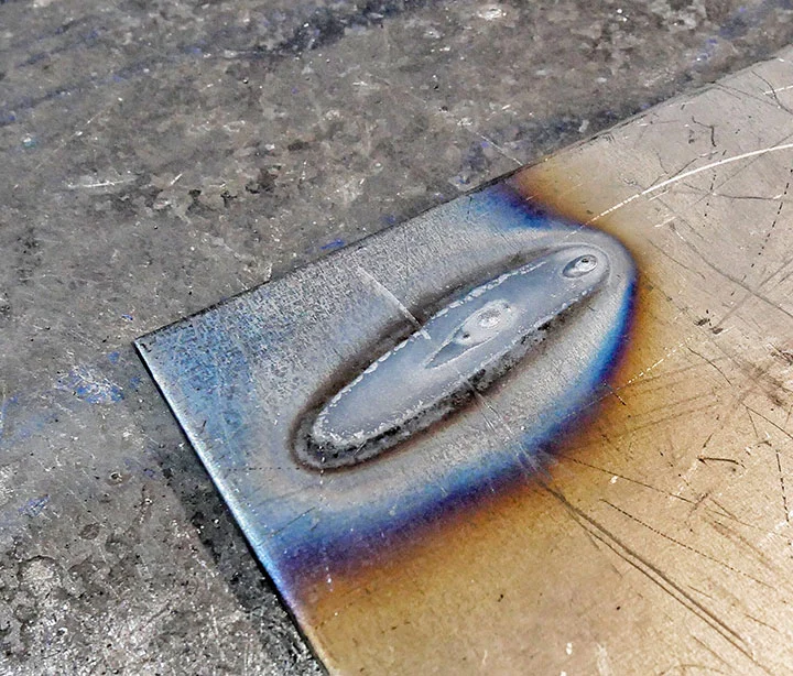

Burn-through
Burn-through, which happens when the weld metal penetrates completely through the base material, is especially common when welding thin materials less than 1/8 inch or about 12 gauge. Excessive heat is the main cause of burn-through, and this can be fixed by reducing voltage or wire feed speed. Increasing travel speed may also help, particularly when MIG welding on materials especially prone to heat buildup like thin aluminum.

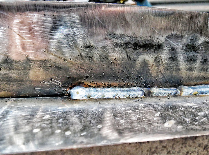

Excessive spatter
Several issues in the MIG welding process can contribute to excessive spatter, including:
  • Insufficient shielding gas
  • Dirty base materials, contaminated or rusty weld wire
  • Voltage or travel speeds that are too high
  • Excessive wire stickout
Ensuring proper shielding gas flow, cleaning base materials thoroughly, lowering the weld parameter settings and using a shorter stickout are ways to avoid excessive spatter accumulation.
For self-shielded flux-cored wires, be certain to weld with straight polarity (electrode negative) and use a drag technique to minimize the opportunity for spatter buildup. When using flux-cored or metal-cored wires, low voltage can also produce an excessive amount of spatter. If you see spatter accumulating, increase voltage as needed.
The wrong size contact tip, a worn contact tip or the wrong contact-tip-to-nozzle recess can also cause excessive spatter.
excessivesplatter
