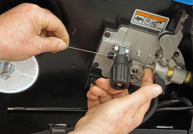

To complete the circuit, a work clamp connects the base material to the power supply. There is a spool of wire, usually housed inside the power supply case, along with a drive mechanism to feed the wire through the cable, toward the gun.

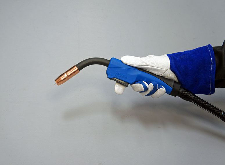

The hand-held gun is the “business end” of a MIG machine. The gun has a trigger that controls several functions simultaneously:
  • Energizes the welding wire.
  • Starts the motor drive to feed the wire automatically.
  • Controls the flow of shielding gas.

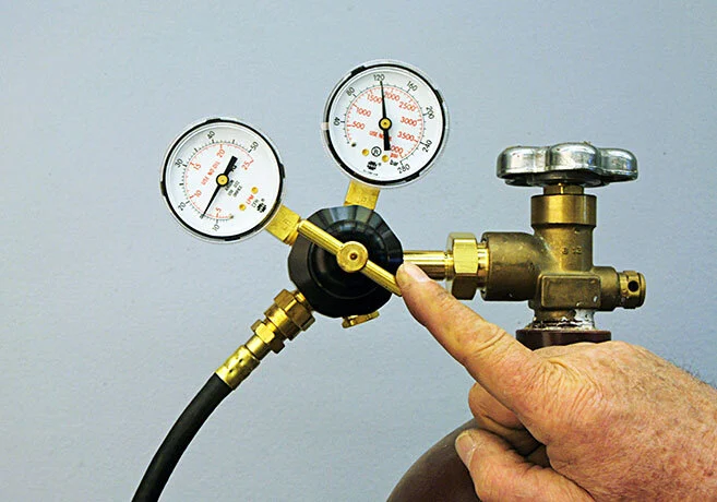

Shielding Gas
Most MIG welding applications require shielding gas. The most common choices are carbon dioxide and argon/CO2 mixes. The gas bottle has a regulator or flowmeter to set the gas flow.
For light-duty welding, a good starting point is 20 cubic feet per hour.
As you gain experience, you can fine-tune the flow rate to suit your needs.

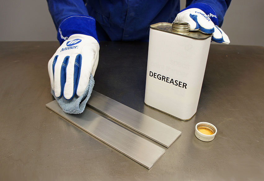

Preparing metal for MIG welding
The material needs to be clean to get a good weld; remove any grease or oil before using abrasives. MIG welding is more tolerant of minor surface contaminants than TIG welding, but the cleaner the metal, the fewer problems you’ll have. I often use sanding disks or a non-woven abrasive for cleaning rust, paint or scale off the metal.

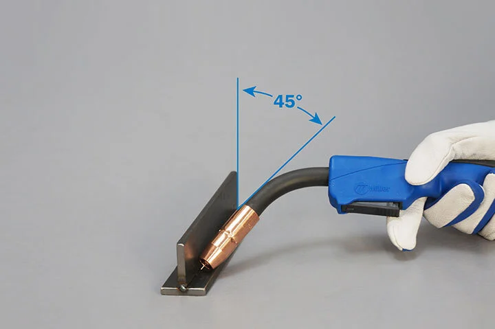

Finding the correct welding angle

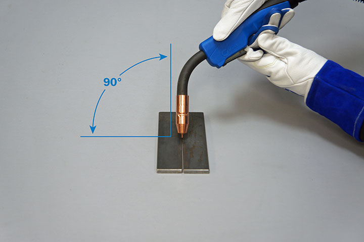

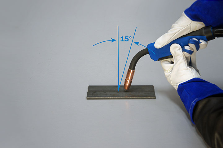

Welding technique plays a big role in weld quality. I normally push the puddle when I weld. Since I’m right-handed, that means the motion of the gun is toward my left. In most cases, you should angle the gun slightly in the direction of motion—this is called the travel angle, and 15 degrees is a good place to start.
When looking at the gun from the end of a seam, the angle of the gun to the work is called the work angle. Here are some common setups:
Butt joint: Hold the gun at 90 degrees to the workpiece.
mig-009
Fillet welds: Use a 45-degree angle.
mig-010
Inverted T joints: Angle the gun slightly away from the vertical element to prevent burn-through, since the vertical part can’t dissipate heat as effectively.
mig-011

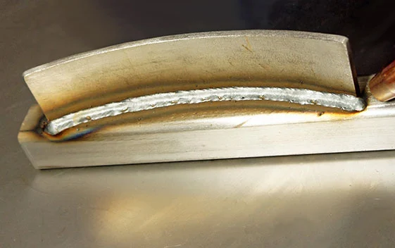

Ideally, the weld bead should be slightly crowned, with the toes or edges of the bead flowing nicely into the base metal. There should be full penetration, but not so much that there is excessive bleed-through on the back of the joint. The width and height of the bead should be fairly consistent, and there should not be any craters or voids. Many people test their practice welds by holding a welded part in a vise and bending the joint until it breaks. Ideally, the metal NEXT to the weld should fracture before the weld bead does.
It takes a lot of practice to get your welds to meet all these criteria. But by following these MIG welding tips and spending time with your helmet down, your welds will only get better!
