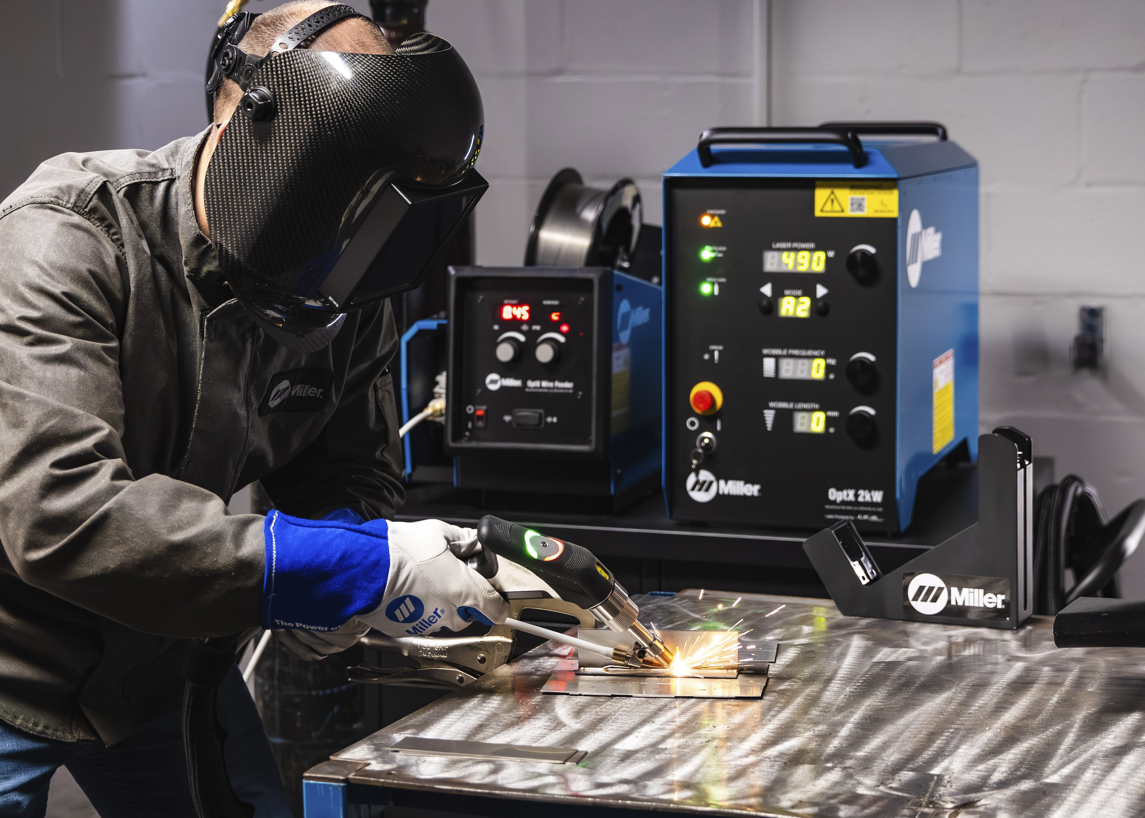

Many welders describe laser welding as holding automation in your hand. The process manages most of the variables, and the operator steers the weld along the joint. That shift is what makes laser welding both appealing and unfamiliar at first.
Handheld systems, such as OptX™ handheld laser welders, are designed to bring this type of process into fabrication environments without requiring a fully automated cell. The intent is not to replace skill, but to apply it in a different way.

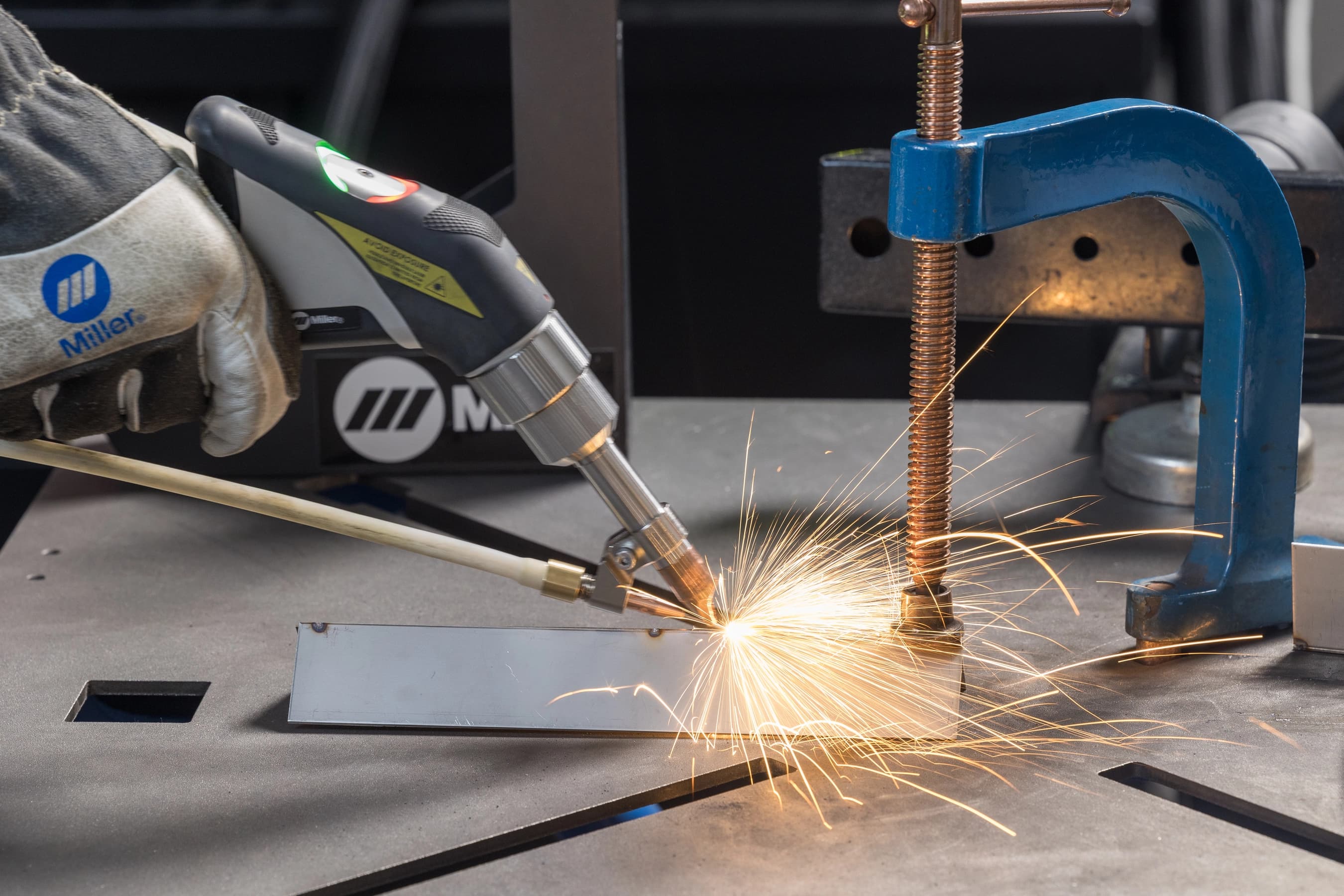

A useful comparison is a magnifying glass in sunlight. When light is focused tightly enough, it generates intense heat. In laser welding, that heat melts the base material, and when filler wire is added, the joint is fused together.
Because the energy is so concentrated, the weld pool stays small and controlled. Travel speeds increase, and surrounding materials have less time to absorb heat. In handheld laser welding, the nozzle is typically rested on the workpiece to satisfy the safety system, giving operators a familiar feel similar to a plasma torch’s drag tip, though instead of removing material, the weld metal is fused.

Laser welding does not eliminate heat. Instead, it delivers heat very quickly. The weld puddle forms and solidifies before heat can spread far into the surrounding material. That faster thermal cycle changes what happens after the weld is complete.
Parts are less likely to warp. Stainless steel shows less bluing and discoloration. Aluminum is less prone to distortion. In many shops, the biggest efficiency gain does not come from welding faster, but from having far less grinding, polishing or rework. On thin material especially, this difference can be significant.
