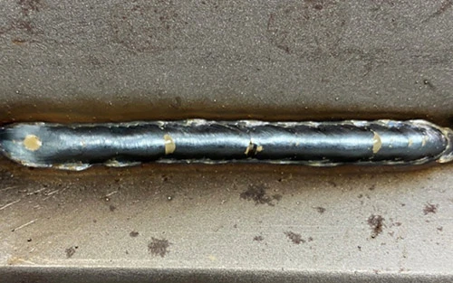

Why do weld appearances look poor and fail inspection?
A weld profile that is visually bad is often the main culprit. The beads may be ropey, have undercut or lack fusion at the weld toes, or be inconsistently or improperly sized.
Potential causes of poor weld appearance are:
  • Puddle that’s too cold: The puddle must be hot enough to achieve good fusion and produce a good bead profile.
  • Improper travel speed: Going too fast and getting too far ahead of the puddle will cause a strung-out puddle that doesn’t flow at the toes.
  • Incorrect work angle, travel angle or electrode stickout: Producing good weld beads also requires proper technique, including travel angle and electrode stickout. The work angle should be approximately 45 degrees. When running a pulsed or spray transfer process, contact-tip-to-work-distance should be about 3/4 inch. When running a short-circuit transfer process, it should be about 3/8 inch. Also, with pulsed or spray transfer modes, a 10- to 15-degree travel angle is recommended with a push travel method. Either a drag or push angle is fine with short-circuit transfer mode.

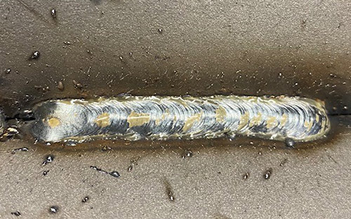

How can I reduce weld spatter and post-weld cleanup?
The transfer mode plays a key role in how much spatter is produced. If you’re welding very thin material or out of position, for example, it may require a short-circuit transfer mode. However, this will produce much more spatter than other transfers. Short-circuit transfer can also limit puddle fluidity and result in lack of fusion or penetration on thicker materials. A switch to pulsed MIG will produce a flatter, more fluid bead and greatly reduce spatter levels. In addition, pulsed MIG is able to maintain a clean arc transfer regardless of the wire speed setting.
spatter_resized
Excess spatter can also be caused by improper parameters and using the wrong shielding gas.
