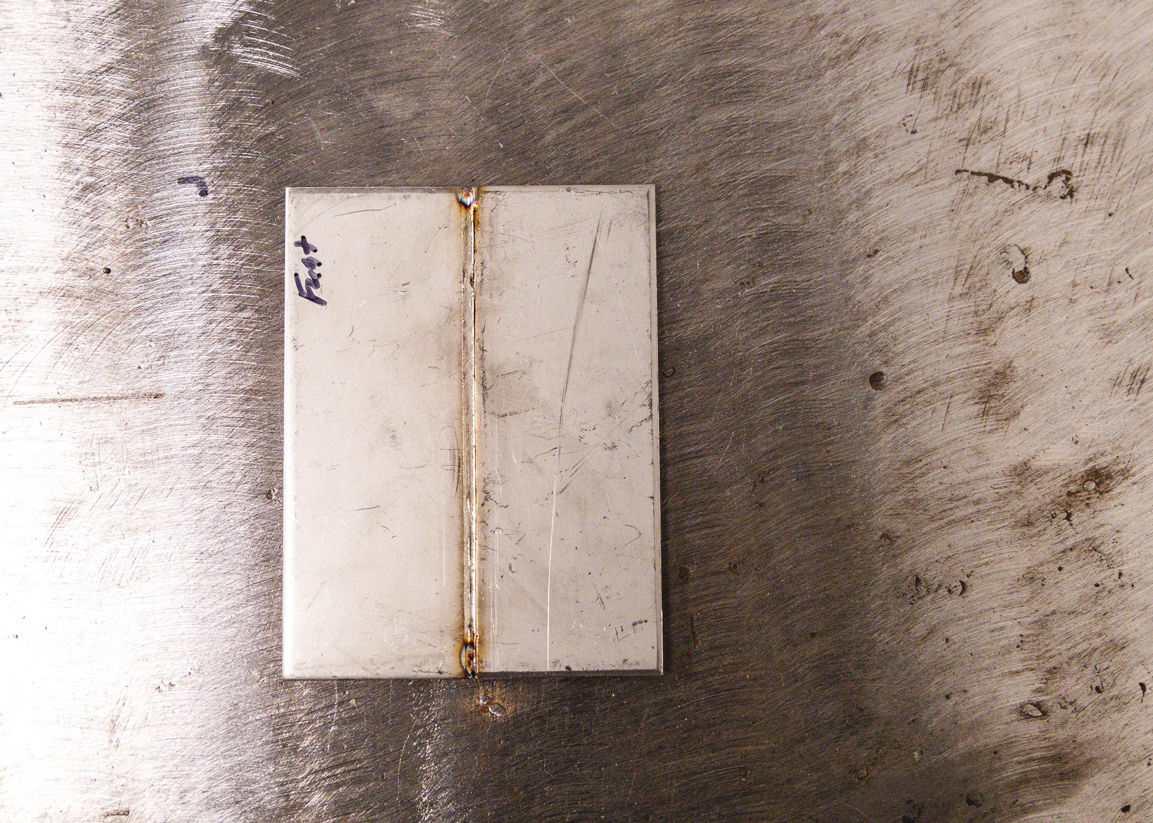

Heat Tint on Stainless Steel Welds
Heat tint on stainless steel welds is more than a cosmetic concern. The colored oxide bands adjacent to the weld bead indicate oxide thickness and chromium depletion at the surface. Light straw coloring suggests minimal oxidation, while darker blues and grays signal more severe depletion.
What heat tint means for sanitary fabrication
In food-grade service, heat tint creates two problems. Oxidized areas are less corrosion‑resistant than fully passivated stainless and are more susceptible to pitting. In addition, the roughened surface can harbor microorganisms that resist cleaning. As a result, most sanitary fabrication standards require removal of all visible heat tint, typically through acid pickling, electrochemical cleaning or mechanical polishing, all of which add labor, cost, chemical hazard and schedule time.
While some level of heat tint is unavoidable when welding stainless steel in air, its severity can be reduced. Slower welds with higher heat input — such as manual TIG welding on thin sheet — often produce wide, dark oxide bands.
How to prevent heat tint
Faster, lower‑heat processes generate significantly lighter tint. Laser welding combines high travel speeds with a tightly focused heat source, reducing the size and intensity of the affected zone. Stainless laser welds often display only faint straw coloration or remain nearly silver with minimal visible oxide.
In one documented manufacturing application, transitioning to a laser welding process substantially reduced post‑weld finishing time by minimizing heat tint and distortion. For any light discoloration that remains, some modern handheld laser systems, including the OptX™ 2kW with integrated cleaning functionality from Miller, offer a cleaning mode that removes oxide films and restores a bright, passivated surface without chemicals or abrasives. This capability can eliminate traditional acid baths and associated hydrogen gas exposure from the workflow.

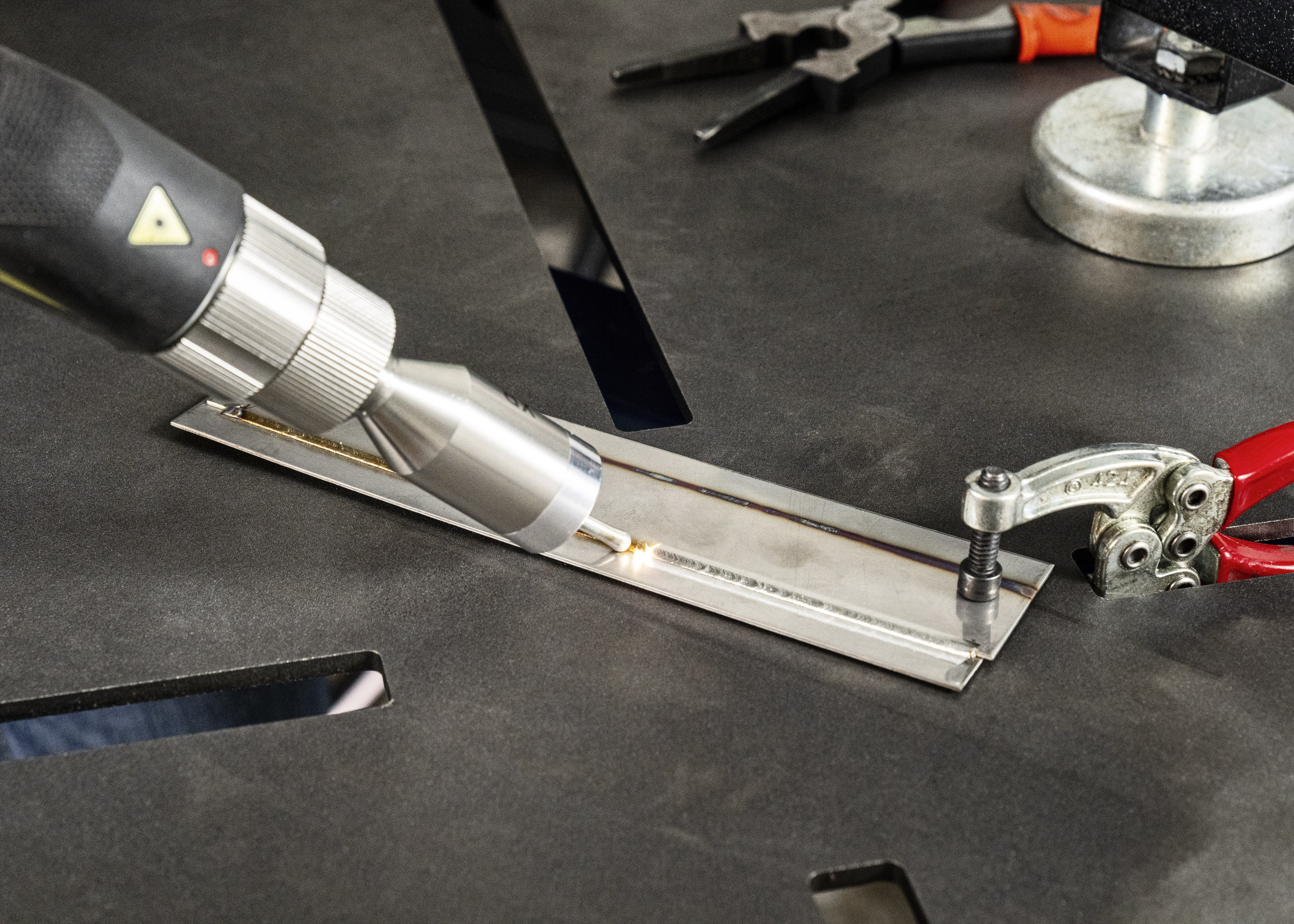

What are the effects of welding distortion?
Weld distortion and surface roughness can create practical sanitary problems even though they are not metallurgical defects. Warped or buckled panels leave crevices that are difficult to clean, misaligned joints create ledges that trap debris, and scattered spatter or large convex beads require grinding before the surface can meet food-contact standards.
What causes distortion in stainless welds?
These issues arise primarily from excessive heat input on thin components. Stainless steel has relatively high thermal expansion, so if a large amount of heat is introduced into a seam, cooling contraction will often leave a permanent bend or twist.
How laser welding prevents distortion
By introducing roughly 50% less heat into 18-gauge stainless compared with TIG or MIG, laser welding dramatically reduces distortion. Assemblies stay flat and true, fixtures can be simpler and the finished product fits together tightly without gaps that become bacterial harborage sites.
Laser welds also produce a narrow, smooth bead profile with no spatter. There are no scattered metal droplets to chip off, no splatter-induced scratches on adjacent surfaces and no pronounced weld ripples to grind flush. The as-welded surface is often smooth enough for food contact with only a light wipe or electropolish, in contrast to the heavy grinding and repolishing that conventional welds may require.
