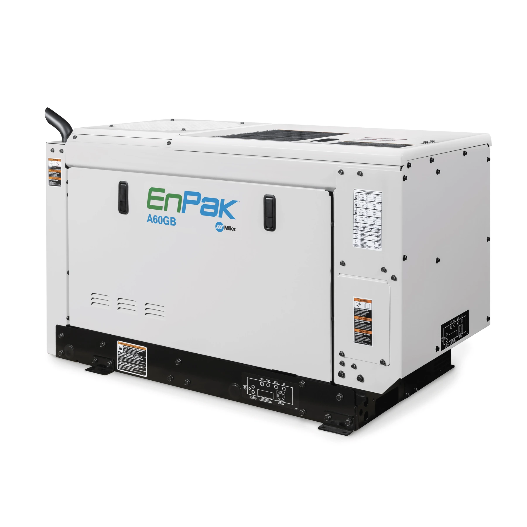

Integrated, High-Output, Multiprocess Welder
Legendary Miller weld quality and reliability with up to 325 amps of output for line boring, structural repair, bucket repair, carbon arc gouging and more.

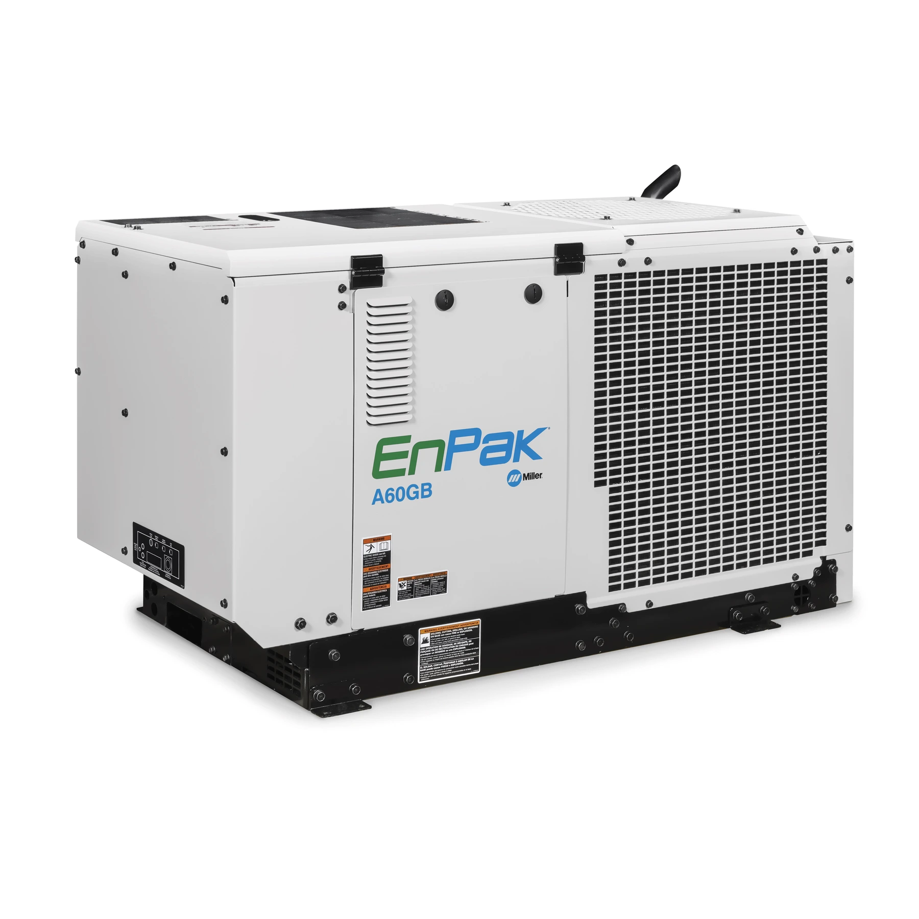

Integrated, Up-to-16-gpm Hydraulic Pump
Well-regulated hydraulic fluid flow for fast and precise crane operation.

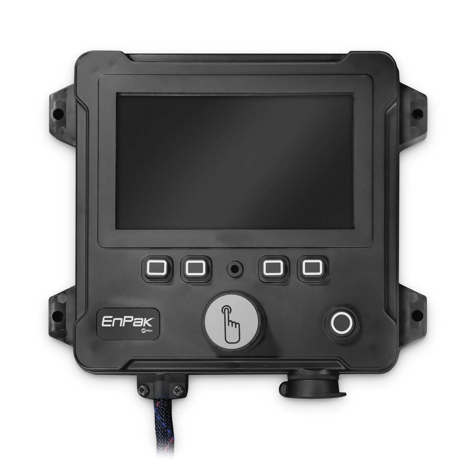

Intuitive Visual Dashboard
Shows key performance indicators of all EnPak® systems; allows operators to change settings and configurations easily and quickly.

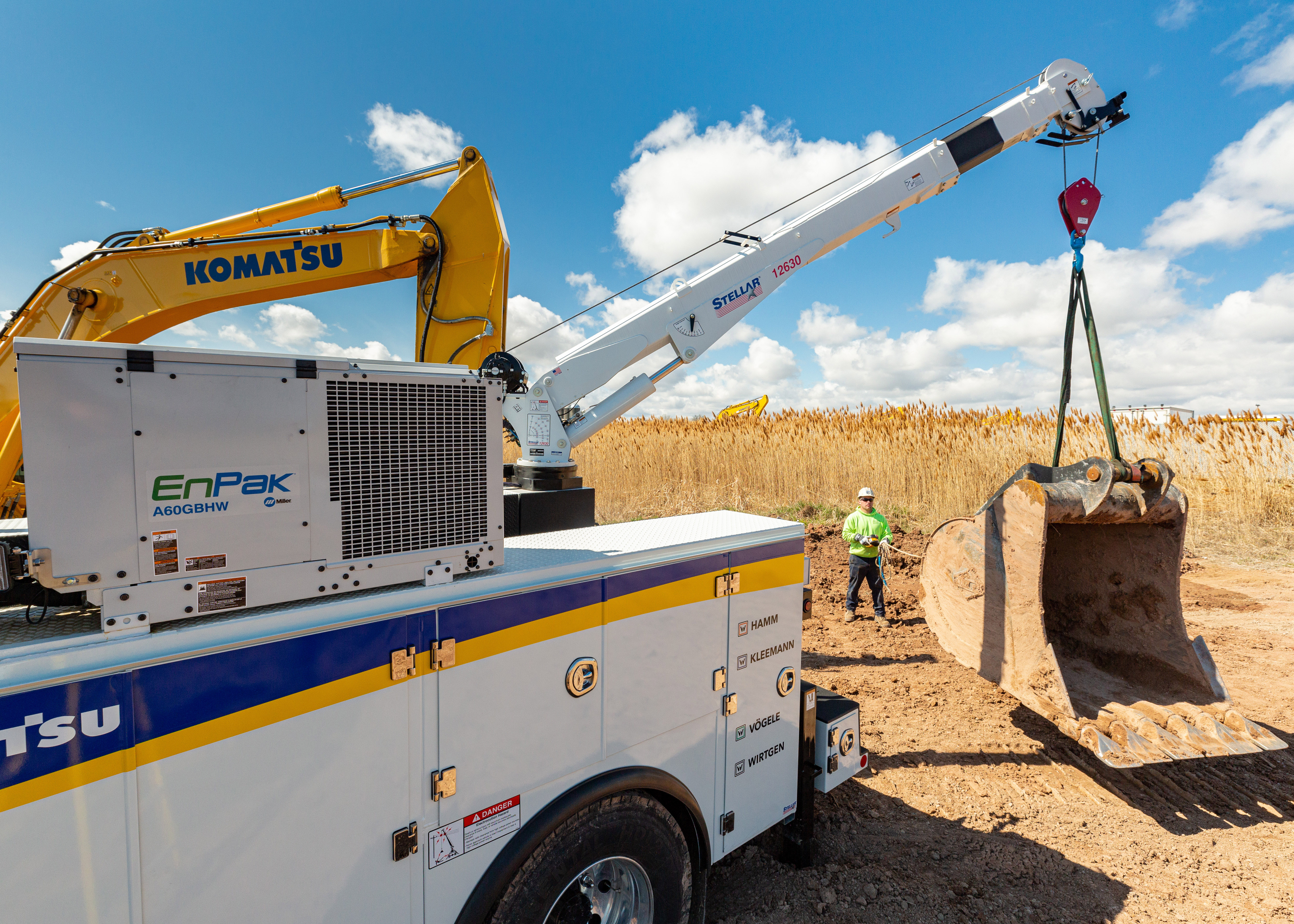

Two individuals inspect the compartment of a utility truck marked with 'Ascendum' branding in an outdoor setting.
How Ascendum Transformed Its Fleet With the EnPak® A60
See how Ascendum used the EnPak® A60 to improve fuel efficiency, reduce maintenance costs, and streamline fleet operations.
  • Air compressor
    The EnPak A60 features a 60-cfm rotary-screw compressor that can power virtually any air tool, including most one-inch impact wrenches. The rotary-screw compressor reliably provides air on demand.
  • Generator power
    7,000-watt generator that can handle most jobsite electrical needs — electrical tools, lights, and more. The optional auxiliary power panel provides two 120-volt GFCI-protected duplex receptacles and one 120/240-volt receptacle with 60 Hz current.

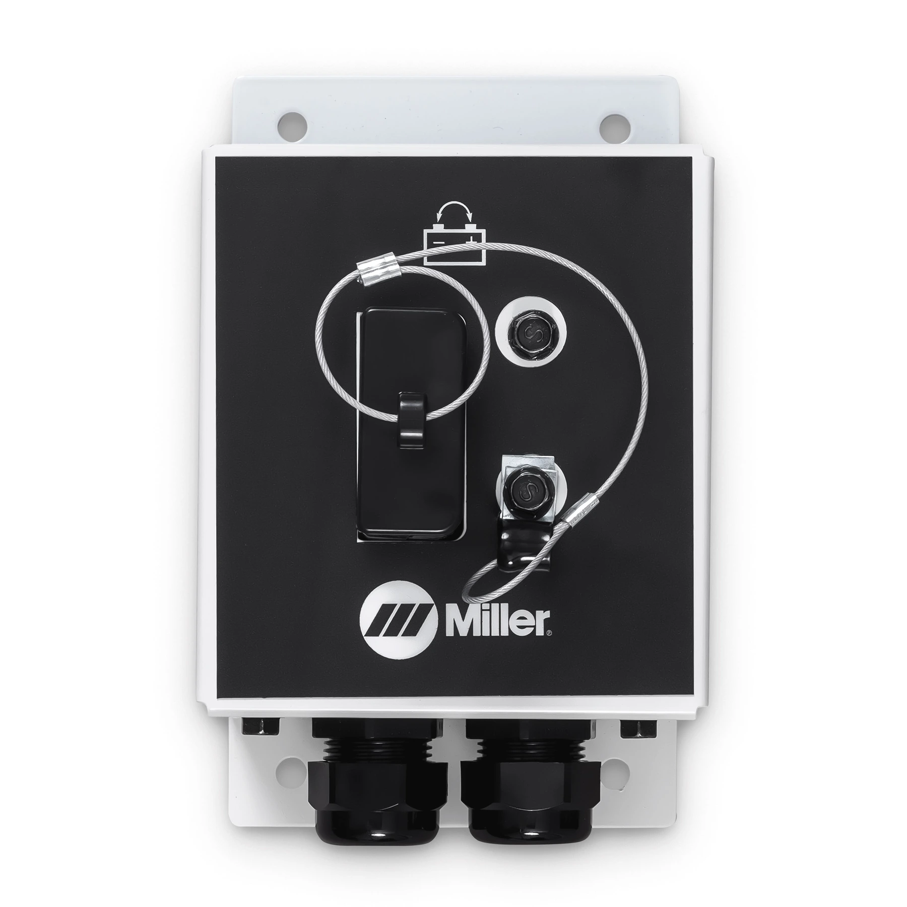

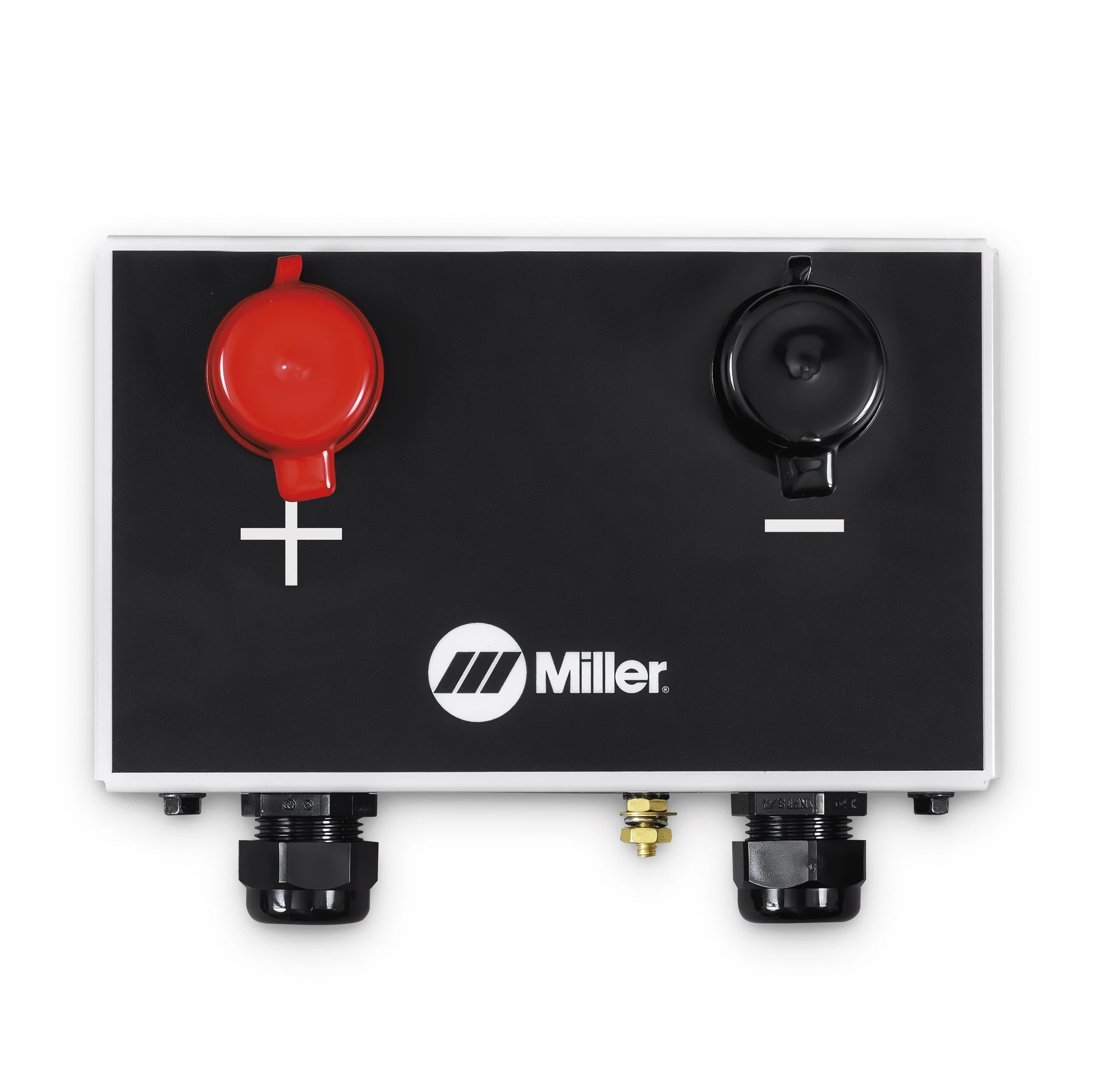

  • Battery Charge/Crank Assist
    Produces up to 150 amps of DC current to quickly charge 12- and 24-volt batteries. It can provide jobsite equipment with weak batteries up to 300 amps of crank assist.

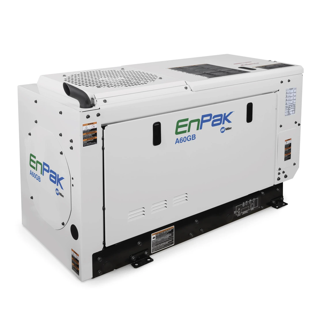

  • Turbocharged engine
    The EnPak A60 utilizes a turbocharged diesel engine, delivering more power at lower speeds (2,800 rpm). It outperforms in every environment — even at high elevations — so operators have the power they need to work anywhere.
  • Auto Start/Stop
    Automatically turns the EnPak engine on and off based on demand, reducing fuel consumption and noise — which enhances safety and improves the work environment.
  • Auto-Speed™ technology
    Advanced Auto-Speed technology automatically adjusts engine speed to match compressed air, battery charge and weld demands — reducing fuel consumption, maintenance costs and noise for a safer, more efficient jobsite.
  • Remote panels
    The EnPak A60 has a new innovative LCD user interface panel that improves the user experience, provides full visibility to the system and empowers technicians to manage their power needs. The EnPak A60 also includes a battery charge/crank assist panel, weld output panel and an optional auxiliary power panel.
