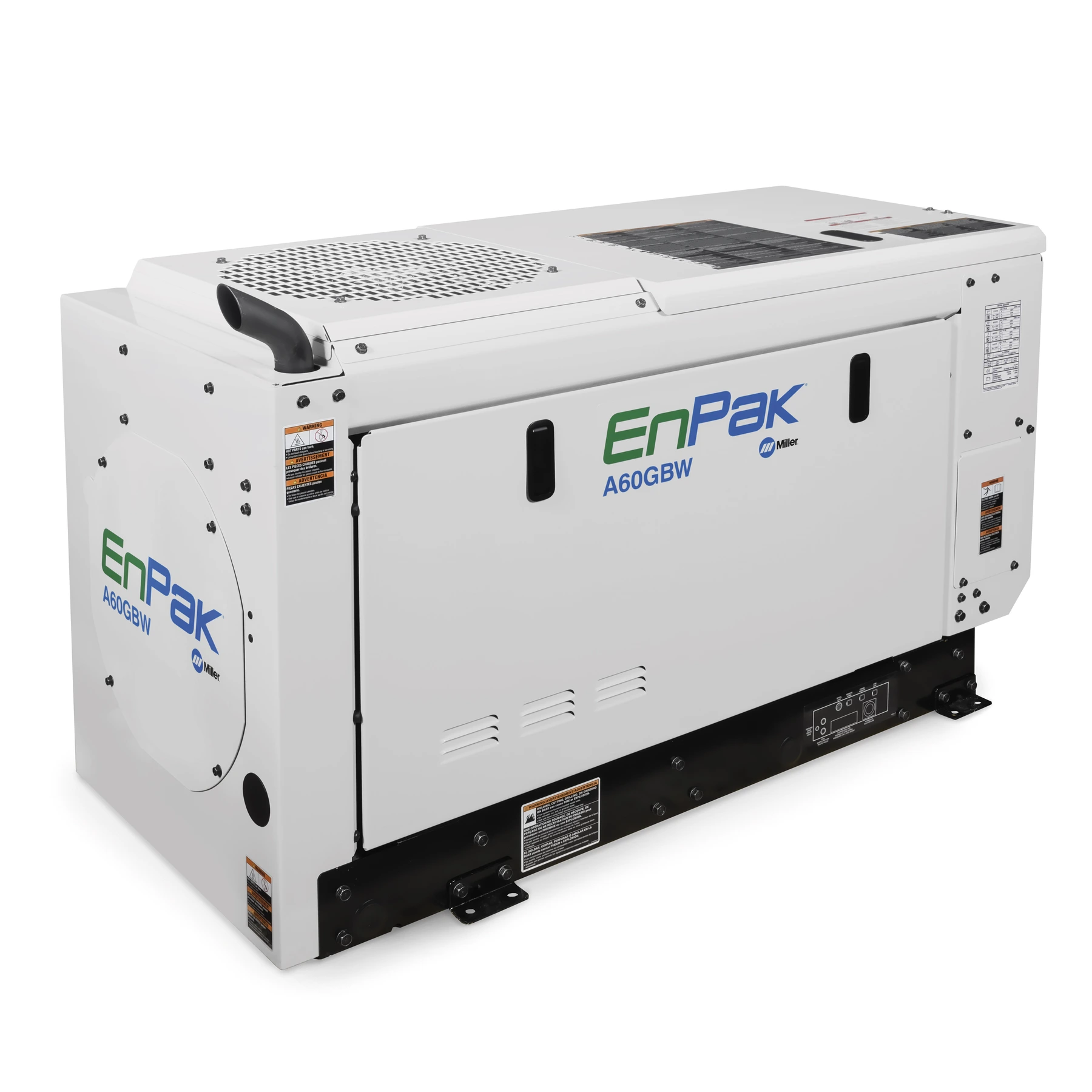

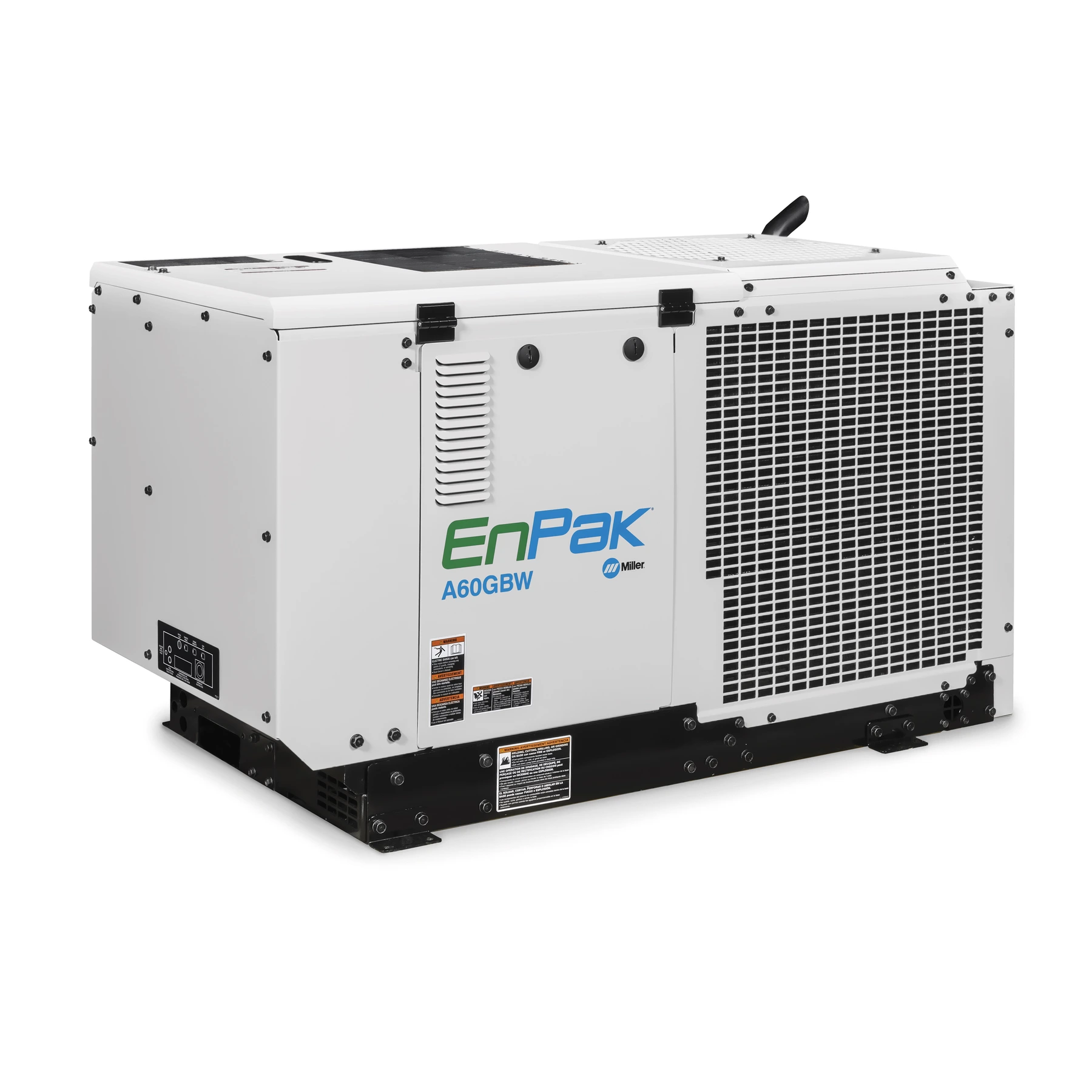

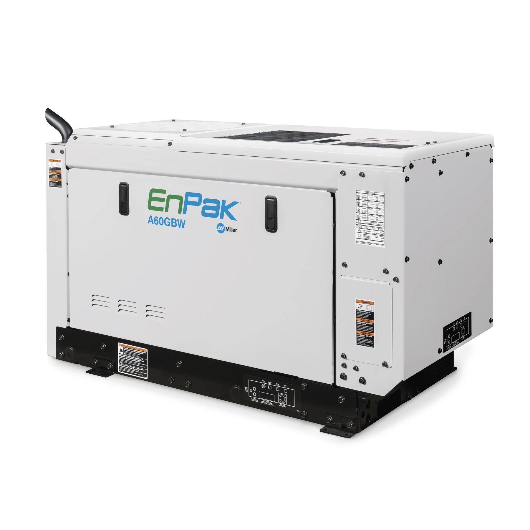

  • Air compressor
    The EnPak A60 features a 60-cfm rotary-screw compressor that can power virtually any air tool, including most one-inch impact wrenches. The rotary-screw compressor reliably provides air on demand.
  • Generator power
    7,000-watt generator that can handle most jobsite electrical needs — electrical tools, lights, and more. The optional auxiliary power panel provides two 120-volt GFCI-protected duplex receptacles and one 120/240-volt receptacle with 60 Hz current.
  • Battery Charge/Crank Assist
    Produces up to 150 amps of DC current to quickly charge 12- and 24-volt batteries. It can provide jobsite equipment with weak batteries up to 300 amps of crank assist.
  • Welder with multiprocess capabilities
    The EnPak A60 provides multiprocess weld capabilities including carbon arc gouging (A60GBHW model only) with 325 amps of output (100 percent duty cycle) so technicians are prepared for each welding job they encounter in the field.
  • Chassis power
    Integrated into the truck, chassis power monitors the battery and automatically charges it as needed. Technicians can turn off their truck without worrying about jobsite tools draining the battery — leaving them stranded.
  • Turbocharged engine
    The EnPak A60 utilizes a turbocharged diesel engine, delivering more power at lower speeds (2,800 rpm). It outperforms in every environment — even at high elevations — so operators have the power they need to work anywhere.
  • Auto-Speed™ technology
    Advanced Auto-Speed technology automatically adjusts engine speed to match compressed air, battery charge and weld demands — reducing fuel consumption, maintenance costs and noise for a safer, more efficient jobsite.
  • Auto Start/Stop
    Automatically turns the EnPak engine on and off based on demand, reducing fuel consumption and noise — which enhances safety and improves the work environment.
  • Remote panels
    The EnPak A60 has a new innovative LCD user interface panel that improves the user experience, provides full visibility to the system and empowers technicians to manage their power needs. The EnPak A60 also includes a battery charge/crank assist panel, weld output panel and an optional auxiliary power panel.
  • CAN bus connectivity
    Allows the EnPak to connect to a telematics system so you can monitor engine data, machine loads and usage. Track service intervals, schedule maintenance proactively and improve diagnostics of your EnPak power system.
