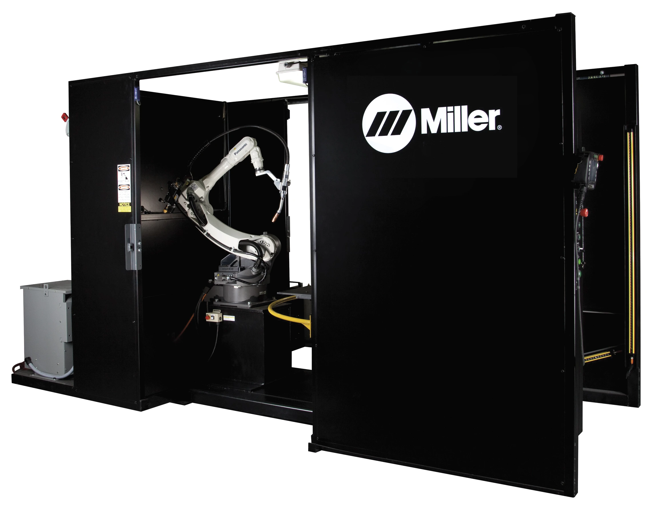

PerformArc™ 1100SS
Flexible high mix-low volume manufacturing solution with dual servo stations, multi-robot capability, and 1100 lb payload for welding aluminum, steel, and specialty metals.
Setting the standard in the welding industry for quality, reliability and productivity since 1996. The PerformArc is backed by Miller today and tomorrow.
Support Hotline (630-653-6819) provides customer service and parts support.
Completely pre-wired and pre-assembled, eliminates assembly time. Easy to locate and connect the utilities. Easy to move with forklift access from the front or rear of the cell.
Control panel and full color teach pendant provide full system control, diagnostics and programming capability in one central location.
High performance AC servo motors for precision indexing, load balancing and quick stopping capability.
Wide configuration allows a second robot to be added, theoretically doubling throughput without increasing floor space requirements. Easy to slide teach access doors keep the system slim and allow for tight stacking to maximize production and minimize floor space. GMAW and GTAW applications.
Designed in accordance with ANSI/RIA R15.06-2012, UL1740, NFPA 79 and CSA Z434. L-shaped light curtains, interlocked safety gates, dual channel safety circuit, rotating arc flash barrier and solid sheet metal wall panels.
AccuPulse, AccuCurve, SP-MAG II, 100% CO2, RMD, Active Wire Process -low energy short circuit and zero spatter. GMAW-P, GTAW -with and without filler, Aluminum -low pulse, dual pulse, synchronized weaving, Sevo Push-Pull Torch, Arc Data Monitoring, Offline Programming -DTPS.
