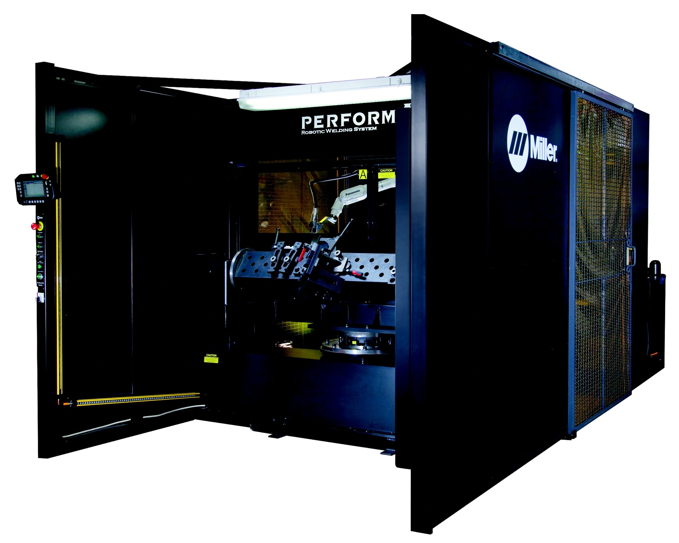

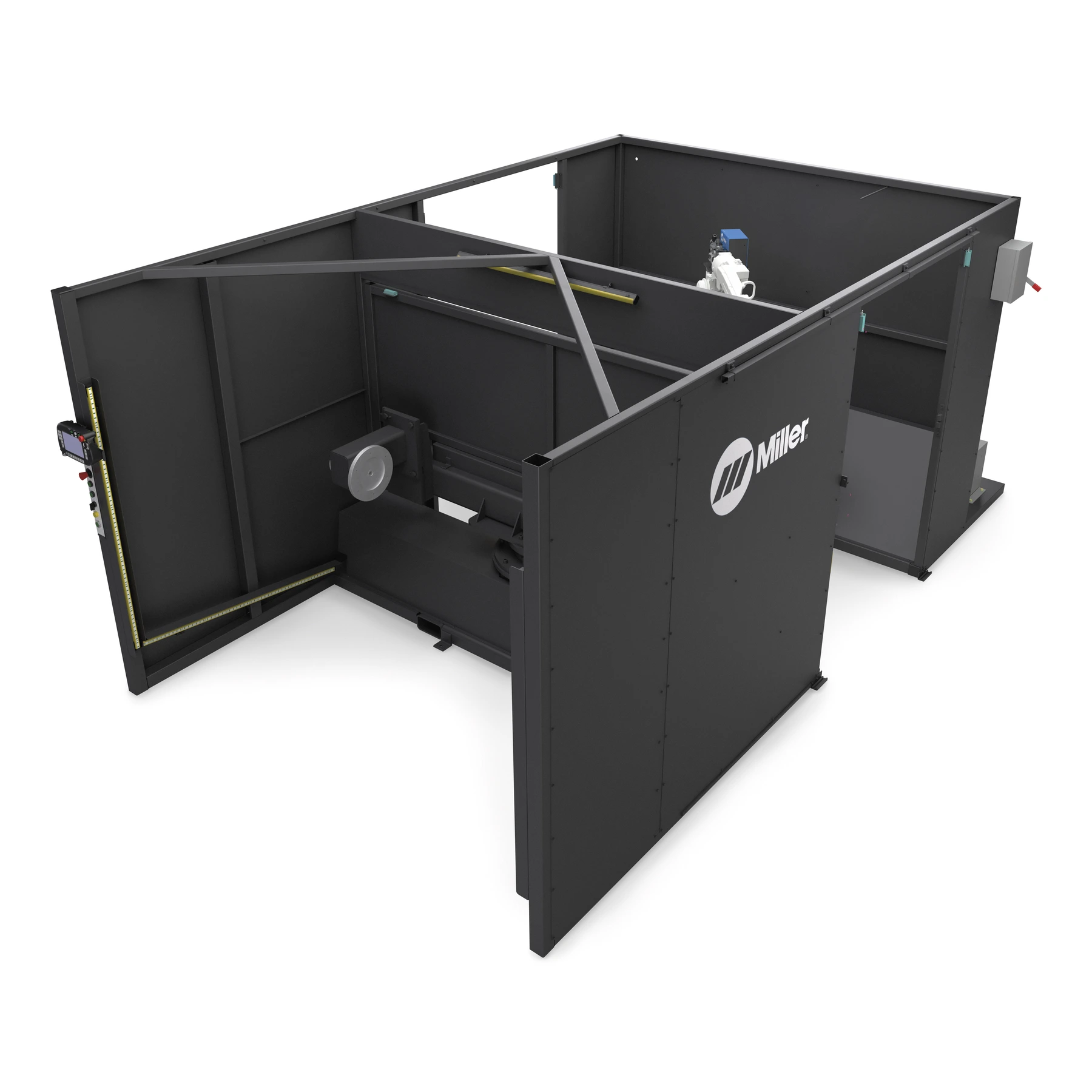

  • High Production, Small Footprint System , Wide Configuration
    60" span between the head and tail stock with 1100 lb. capacity on each side. Wide configuration allows a second robot to be added, theoretically doubling throughput with no additional floor space required. Hinged access doors for teaching; one includes a laser safe viewing window. Process Viewing Package includes video monitor of robot work zone.
  • Coordinated Motion
    Outboard Servo Positioners allows the parts to be rotated into the desired welding position, maximizing torch access and welding quality. High performance AC servo motors for precision indexing, load balancing and quick stopping capability.
  • Quick Assembly
    A fully welded frame, pre-wired and pre-assembled ships in three sections for quick assembly.
  • Manufacturing Flexibility
    Large rotation diameter and heavy payload capacity allow multiple or progressive fixtures. Provides flexible platform for changing production needs.
  • Long Term Support and Reliability
    Setting the standard in the welding industry for quality, reliability and productivity since 1996. The PerformArc is backed by Miller today and tomorrow.
  • 24/7/365 Support Line
    Support Hotline (630-653-6819) provides customer service and parts support.
  • Full Range of Welding Processes
    AccuPulse, AccuCurve, SP-MAG II, 100% CO2, RMD, Active Wire Process -low energy short circuit and zero spatter. GMAW-P, GTAW -with and without filler, Aluminum -low pulse, dual pulse, synchronized weaving, Sevo Push-Pull Torch, Arc Data Monitoring, Offline Programming -DTPS.
  • Safety and Performance
    Designed in accordance with ANSI/RIA R15.06-2012, UL1740, NFPA 79 and CSA Z434. L-shaped light curtains, interlocked safety gates, dual channel safety circuit, rotating arc flash barrier and solid sheet metal wall panels.
