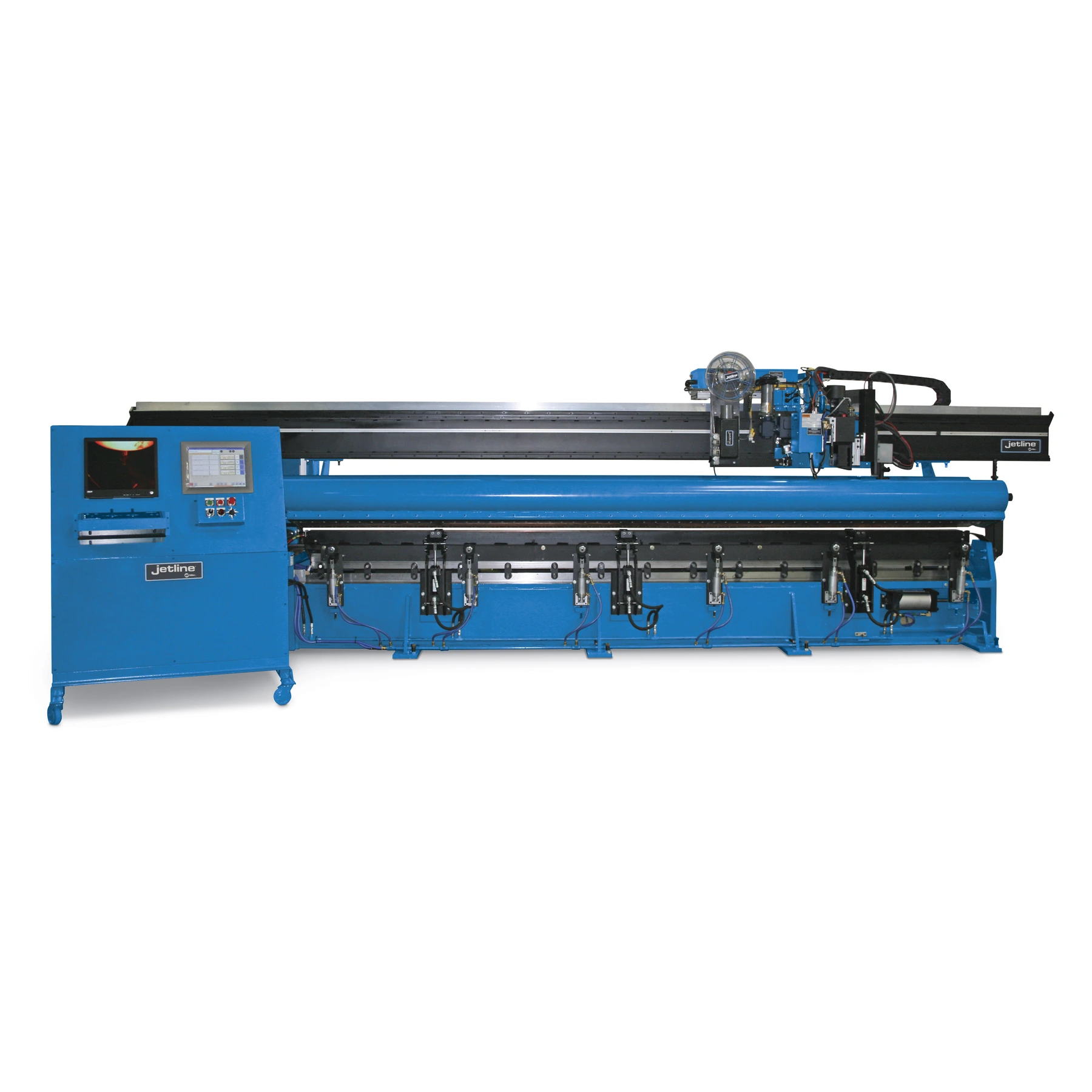

LWI Series seam welders are for flat sheets and internal welds on large diameter cylinders.
Optional Pneumatic centering devices ease alignment of the first edge of flat sheets.
Optional plate roller assemblies can be supplied and mounted to the base of the LWI style seam welders. The rollers are used as an aid in part loading and unloading. The rollers are pneumatically operated and will retract below the pass though height of the insert. Control of each bank is through an electrical solenoid valve and the up and down buttons will be mounted near the finger clamping buttons.
Inserts are quickly and easily interchanged into the Backup Mandrel to accommodate a variety of material types and thicknesses. Copper inserts dissipate heat generated during the welding process. Additional inserts are available to cover a wide range of material types and thicknesses. Inserts are available with or without gas back-up capabilities.
Designed to support the part being welded and hold the back-up inserts. Droop mandrels are available to ease loading and unloading of parts. Optional Water-cooled mandrels are available.
Copper tipped, aluminum hold down fingers are standard on all Jetline Seam Welders, The copper tipped hold down fingers assist in the chilling the weld joint. Copper tooling absorbs and dissipates heat through the use of additional thermal mass, operating under pressure against the work piece.
Jetline systems are available with 9900 Series computer based or 9700 Series micro-processor based controllers to meet your application requirements.
