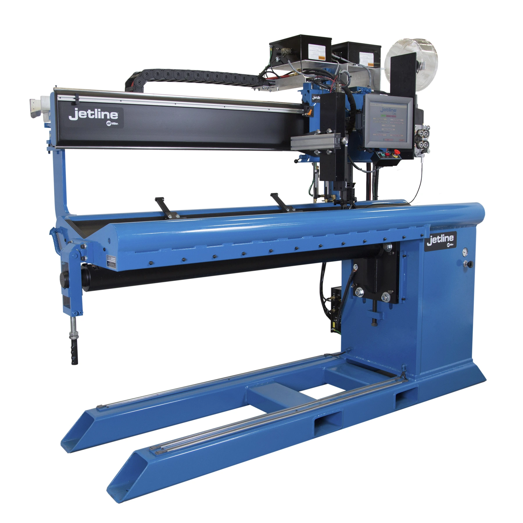

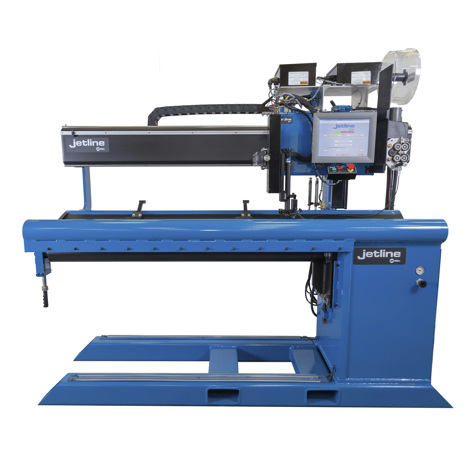

    Jetline LW Series External Seam Welders are designed for external welds on cylinders and flat sheets. LW Series Seam Welders are available in three levels of accuracy to optimize your seam welding application: LWS - Standard, LWP - Precision, LWX - Extra-Precision.

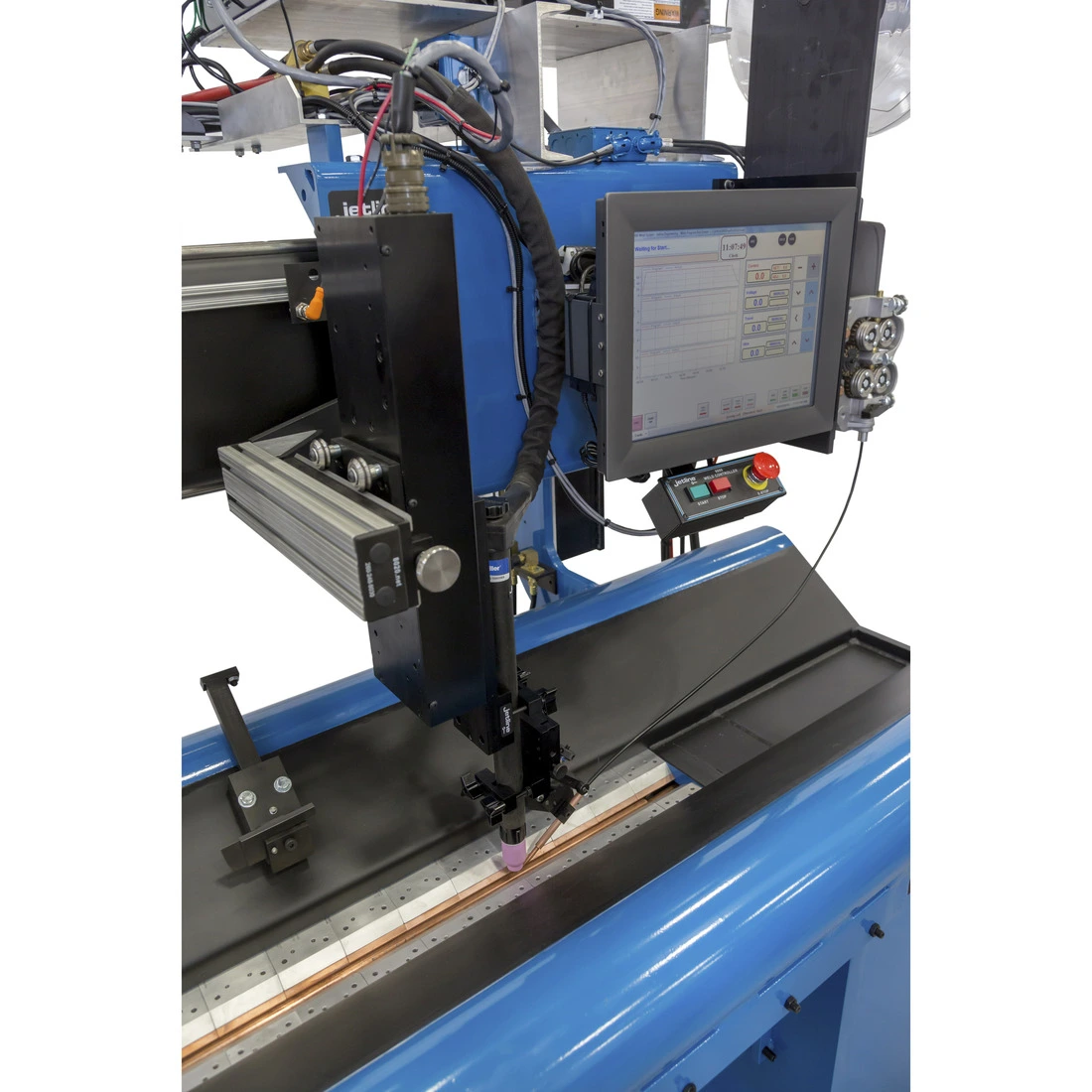

  • Copper tip clamping fingers
    Copper tipped, aluminum hold down fingers are standard on all Jetline Seam Welders, The copper tipped hold down fingers assist in the chilling the weld joint. Copper tooling absorbs and dissipates heat through the use of additional thermal mass, operating under pressure against the work piece.

  • Back-up insert
    Inserts are quickly and easily interchanged into the Backup Mandrel to accommodate a variety of material types and thicknesses. Copper inserts dissipate heat generated during the welding process. Additional inserts are available to cover a wide range of material types and thicknesses. Inserts are available with or without gas back-up capabilities.
