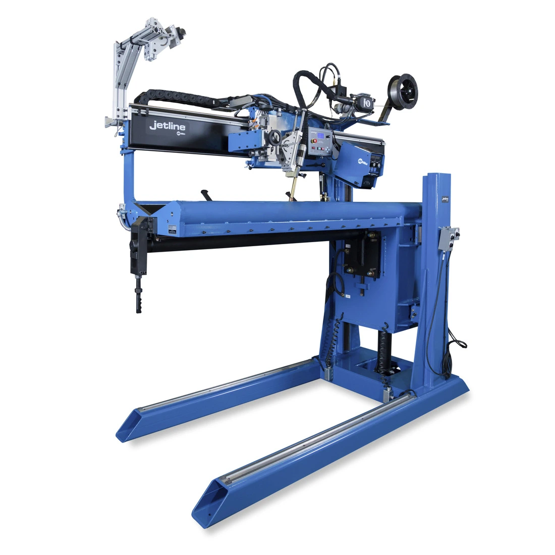

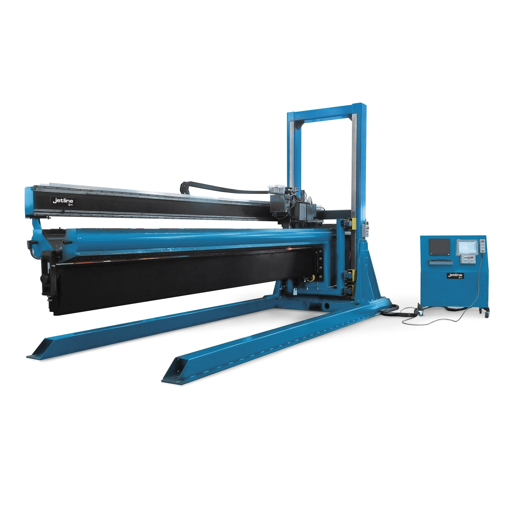

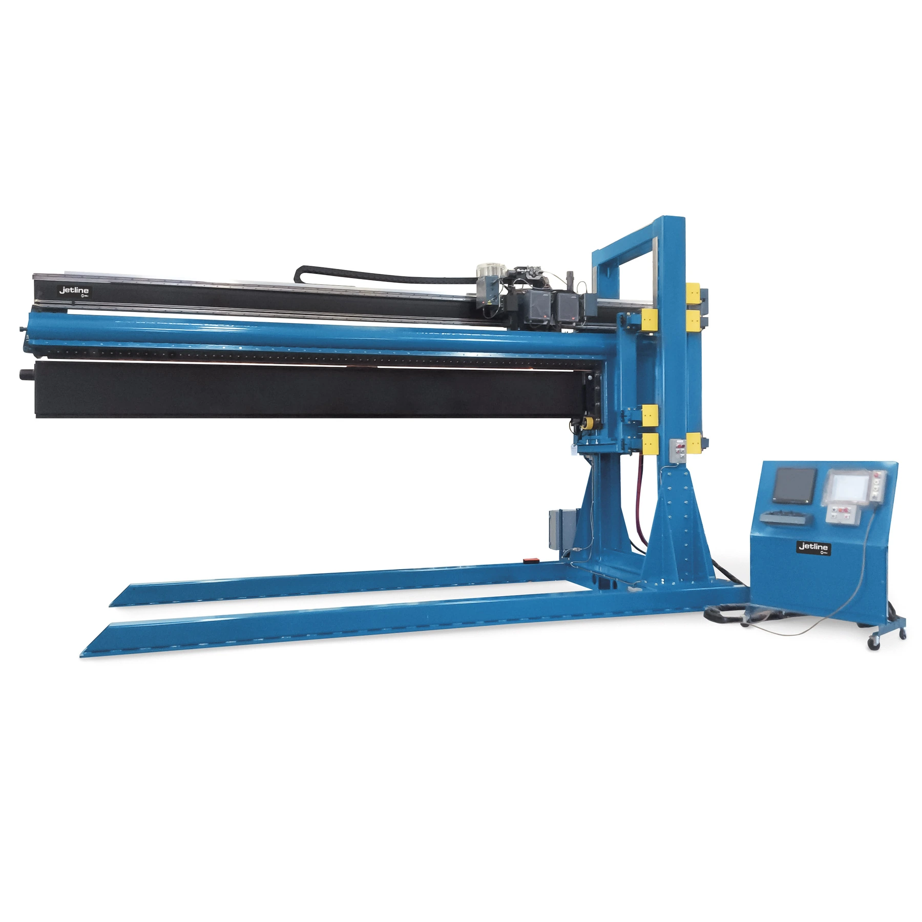

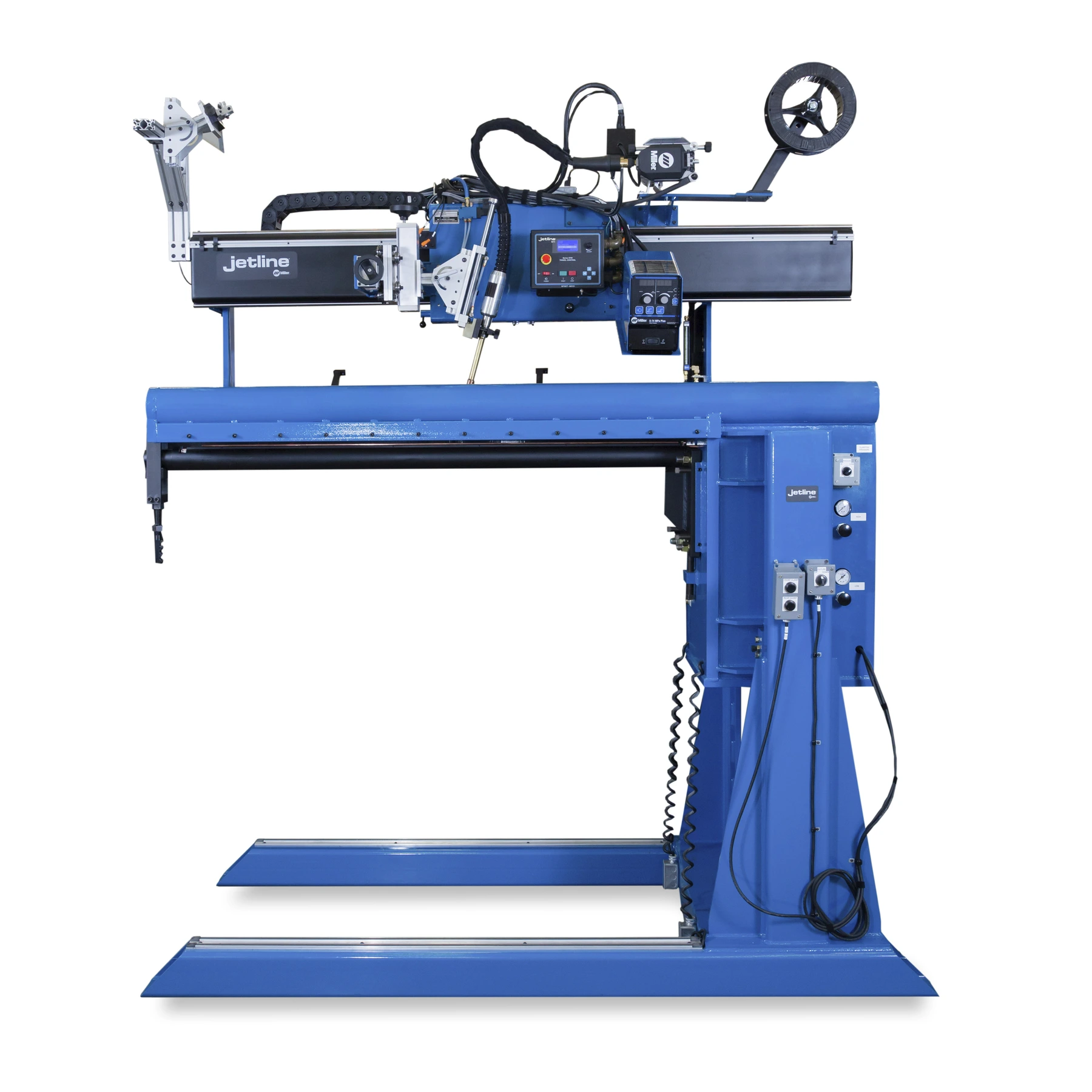

The LWH Seam Welders allow welding on large and small diameter cylinders and other shaped parts. The elevating style seam welder is essentially a variation of our standard LWS External Seam Welders. Instead of a fixed height, the tabletop and mandrel on the elevating models are mounted on support structure, allowing the seam welder can be moved up or down. Movement is through the use of a hydraulic cylinder with special fail-safe valves to ensure that the unit remains in position, even in the event of a power failure.

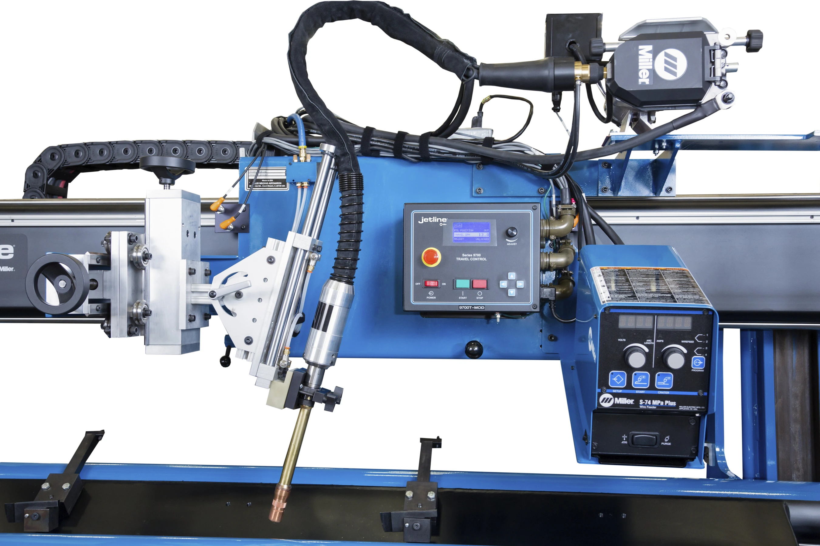

Copper tipped, aluminum hold down fingers are standard on all Jetline Seam Welders, The copper tipped hold down fingers assist in the chilling the weld joint. Copper tooling absorbs and dissipates heat through the use of additional thermal mass, operating under pressure against the work piece.
Jetline systems are available with 9900 Series computer based or 9700 Series micro-processor based controllers to meet your application requirements.
