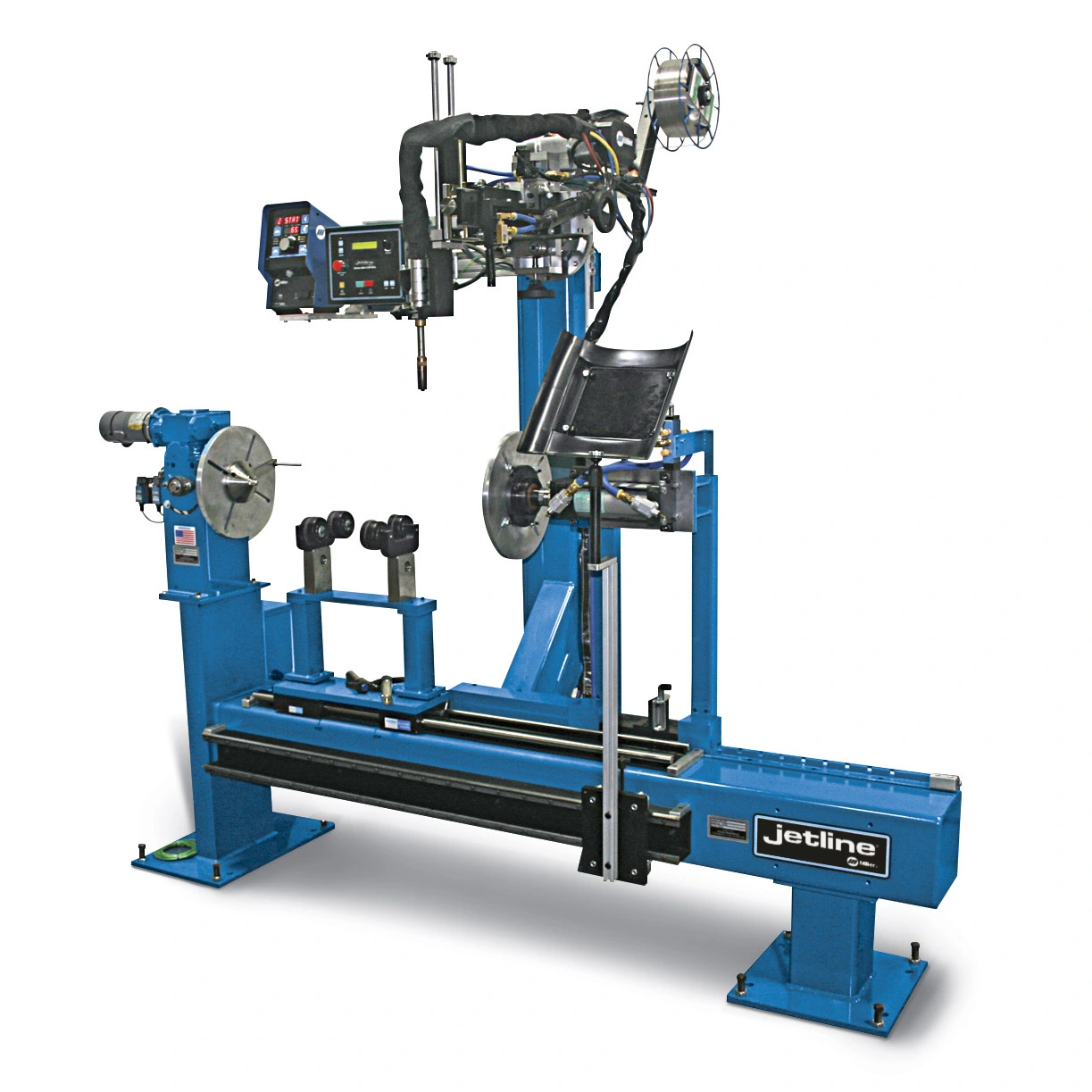

  • CWB Series
    Light duty circumferential welding system that accommodates parts up 1,000 lbs. The design of the CWB system is in two parts, the headstock and tailstock which holds and rotates the part to be welded. The equipment mounting post can be repositioned along the bed and can be locked at any point to position the welding equipment. The post can carry most types of welding heads having a weight not exceeding 200 lbs. (90 kg).
  • 3 Year Warranty
  • Pneumatic tailstock
    Tailstock is air-operated and applies a constant clamping pressure to the part throughout the welding cycle.
  • Adjustable Weld Head Positioning
    The weld head is adjustable along the length of the part, to accommodate different weld locations.
  • Multi Process Capable
    Systems can be designed with more than 1 weld process.
  • Adjustable tailstock
    All Jetline circumferential welding fixtures include a machined base. This permits the tailstock to be easily relocated for different length parts.
  • Cradle lifts
    Optional Cradle lifts are available to assists in loading the part. Cradle lifts are manufactured specifically to suit the diameter range of the parts to be welded.
