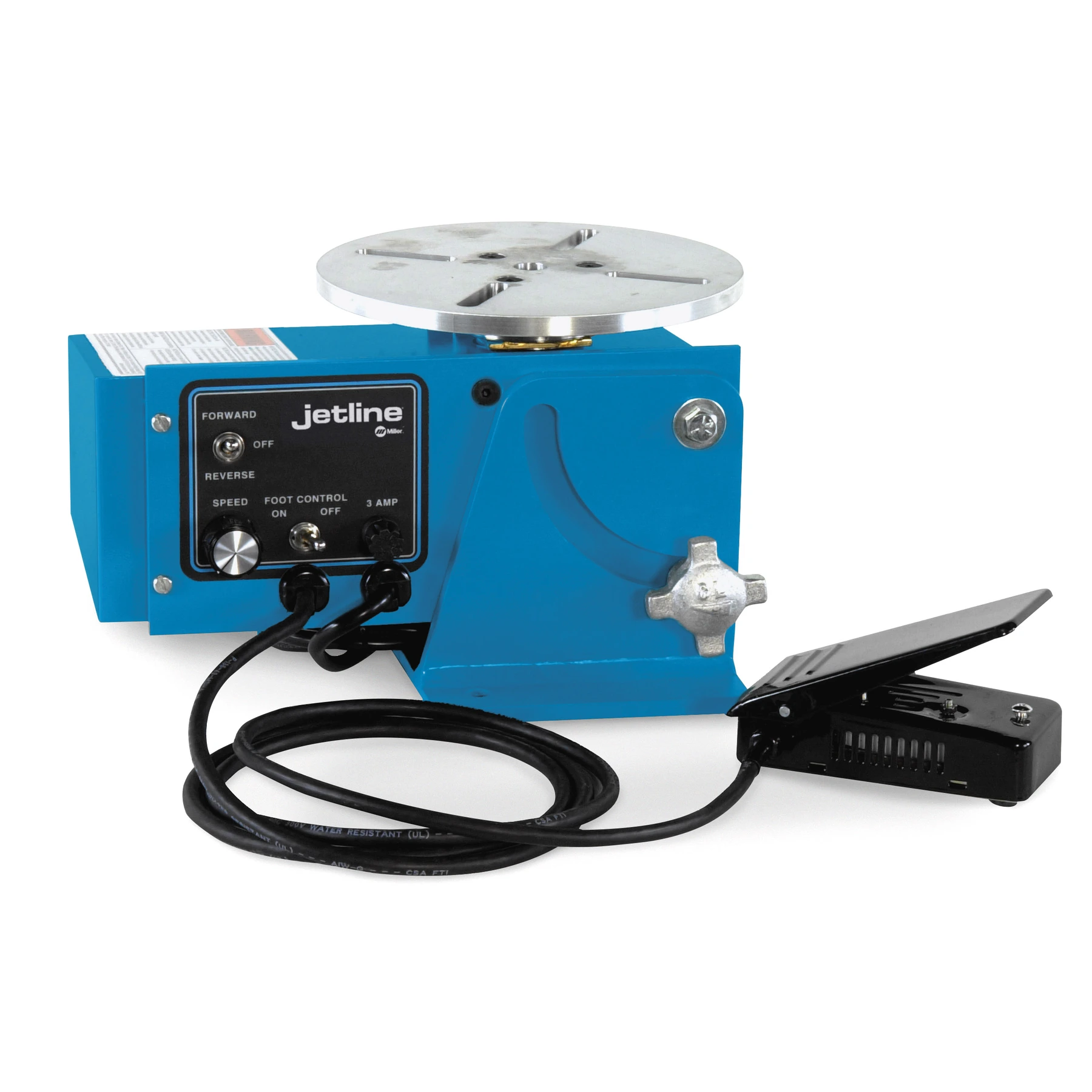

    ZB-75ACA is designed for manual welding applications. RPM range is 0.5 to 7.5. Includes variable speed foot switch. Designed for manual and automated welding applications. RPM range is 0.3 to 10 through a 1-turn potentiometer. ZB-75DCB is designed for manual and automated welding applications. RPM range is 0.1 to 3.2 through a 1-turn potentiometer.
  • Specifications
    75 lb. (34 kg) weight capacity with faceplate in the vertical position. 100 lb. (45 kg) weight capacity with faceplate in the horizontal position. 90-degree faceplate tilt from vertical to horizontal. 8 in. diameter aluminum faceplate with 4 tooling slots. High Frequency Protection. Forward and reverse toggle switch. RPM is set through a 1-turn potentiometer. 300-amp ground. Weight: 28 lbs.
  • Options (sold separately)
    5 in., 3 jaw chuck. On/off corded foot switch for ZB-75DCA & ZB-75DCB only.
