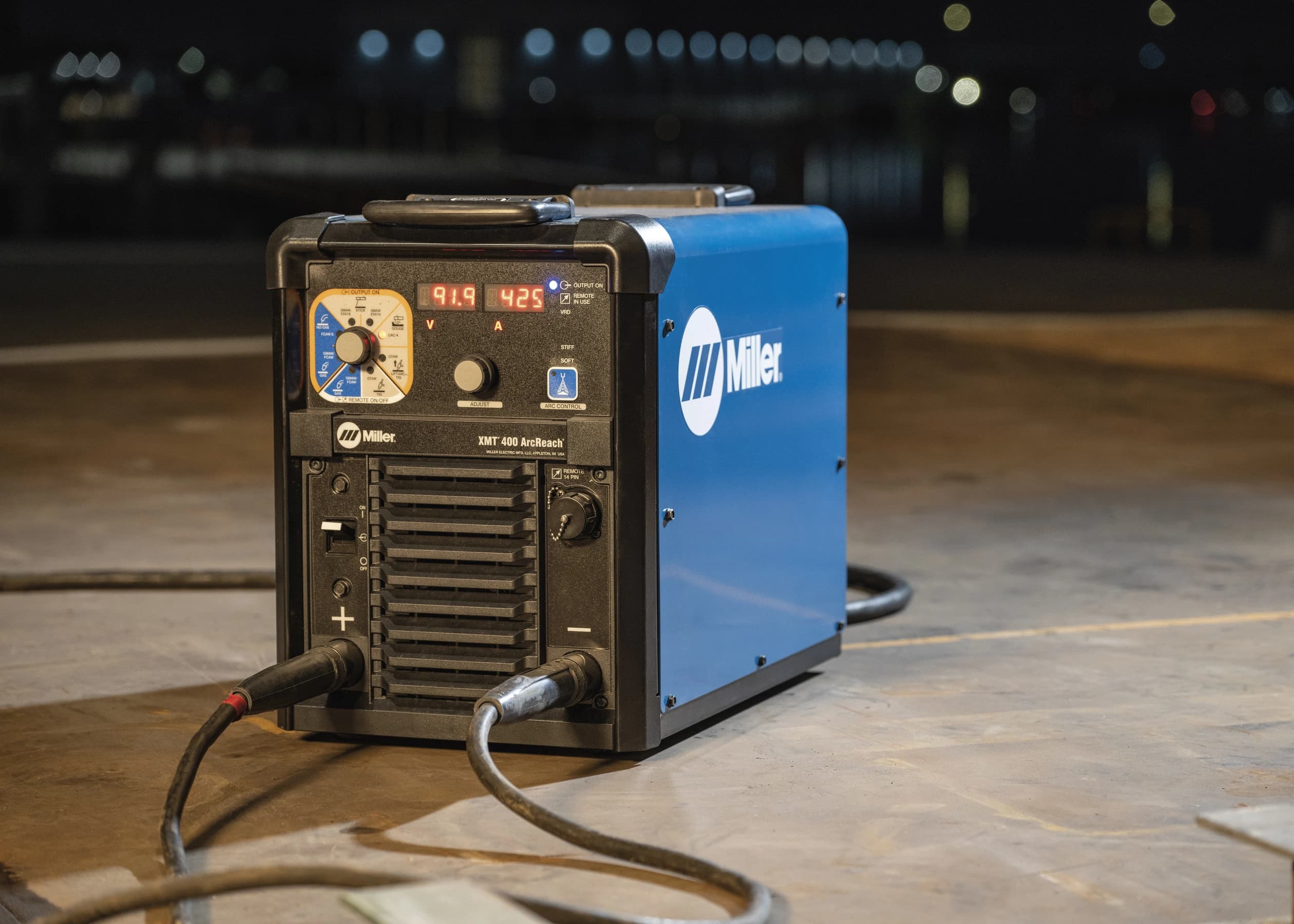

3. Use an XMT® multiprocess welder — designed for confab applications
Created specifically for confab operators, these machines provide portability, versatility and excellent arc performance no matter the job, making them essential equipment for welders. The newest model in the XMT lineup is the XMT® 400 ArcReach. It’s the lightest and smallest machine in its amperage class and has a rating of 400 amps at 60% duty cycle to achieve bigger, longer welds with a larger diameter wire and rods. It’s also enhanced with new features and technologies that help operators work harder and smarter — along with more jobsite flexibility, fewer space requirements and more portability.
This multiprocess welder includes ArcReach, Auto-Line and CLC technologies, and its dedicated weld processes include gas-shielded flux-cored, TIG, self-shielded flux-cored, stick and gouge so operators can dial in whatever they need whenever they need it. Additionally, a front panel lockout disables the power source interface when connected to an ArcReach accessory to avoid inadvertent changes to the power source, keeping arcs stable. Combined, all of these technologies help amplify productivity and push job performance to a new level.
The XMT 400 is a great addition for its lightness to help round out the XMT series, which spans the needs of every amperage class. The portability and flexibility of the XMT 450 makes it an industry favorite, delivering up to 600 amps and available in ArcReach and non-ArcReach models. It has the core multiprocess capabilities and the flexibility for 14-pin spool guns, feeders and remote controls. The XMT® 650 series, which is also available in ArcReach and non-ArcReach models, is ideal for structural fabrication operations. It delivers up to 815 amps for larger wires and optimized gouging to remove more material per pass. This system can handle larger diameter wires and 16-inch diameter coils when paired with the ArcReach 16 feeder, improving deposition rates and productivity. Systems with ArcReach capabilities give operators the power to change the voltage at the feeder — eliminating a trip to the power supply and increasing productivity.
