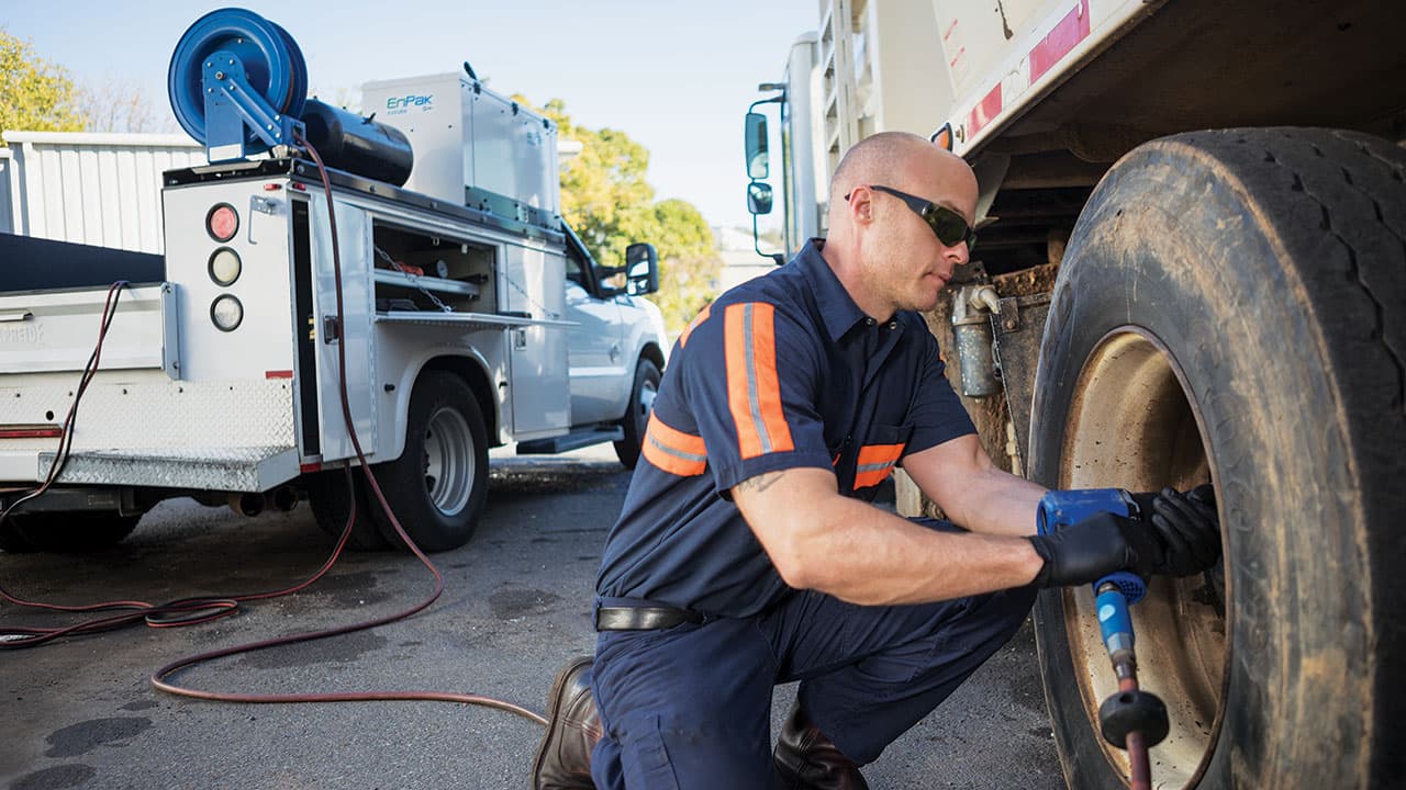

Work trucks that carry multiple engine-driven machines have less available payload and, therefore, less room for important tools. Instead of carrying two or three separate machines, such as an air compressor, generator and welder, using an all-in-one can maximize capabilities while reducing weight and freeing up space. This provides more available payload space on the truck for other important items that may be needed on the job.
Learn more about how power systems deliver space and weight savings on work trucks while also providing benefits for reduced downtime, fuel savings and extended chassis life.
PTO-driven systems can’t operate unless the truck engine is idling. But an all-in-one solution can provide compressed air, generator power, battery charging/crank assist, welding and power to support 12-volt DC needs — all with the truck engine turned off.
The compact design of all-in-ones can reduce truck weight by up to 500 pounds and increase available payload by up to 24 cubic feet compared to using multiple engine-driven machines. This weight savings helps save fuel, extend chassis life and reduce the risk of costly overweight fines.
