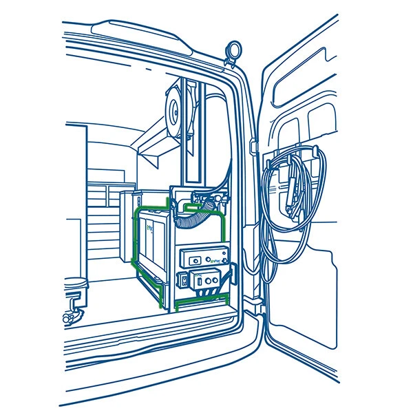

Tip #1: Don’t bury the unit
enpak_installed_1_resized
Using an all-in-one inside an enclosed truck requires proper ventilation around the unit to ensure airflow of cold air in and hot air out. If the all-in-one system doesn’t have enough airflow, the machine can overheat. This negatively impacts performance and machine life. An under-deck installation is an option worth considering on some chassis.

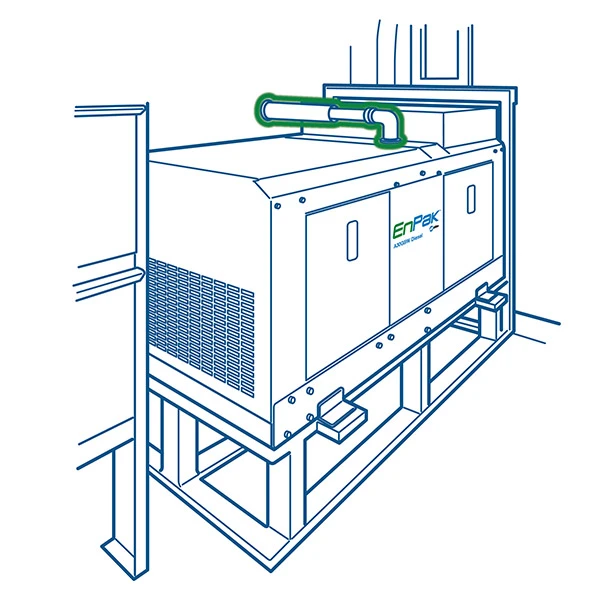

Tip #2: Duct directly to the outside
enpak_installed_2_resized
Think of the enclosed truck body as a closed system. Engines and other components produce heat, so proper cooling requires adequate air circulation. Fresh, cool air must be brought in, and hot air must be removed. The best way to prevent recirculation of the hot air created by an all-in-one is to either duct the hot air directly to the outside or duct cool air into the air intakes.
In addition, engine exhaust fumes contain carbon monoxide, so they must be ducted to the outside. Never use an EnPak all-in-one inside a home or garage, even if doors and windows are open. Always read and follow all labels and the Owner’s Manual carefully.
Avoid using exhaust pipe extensions or extra elbows to duct the exhaust fumes. This will cause back pressure in the engine exhaust and reduce flow through the combustion chamber. This compromises engine performance and can cause exhaust emissions issues.
Ideally there would be no exhaust pipe extensions. Keep extensions to a minimum when they must be used. Any extensions require the use of larger-diameter tubing — at least one and a half times the diameter of the stock exhaust pipe.
Routing exhaust through the floor of the truck is discouraged. It requires at least two additional bends and several feet of exhaust pipe — resulting in excessive exhaust back pressure. Instead, route exhaust through the closest sidewall or straight up through the roof for units mounted on a stand.

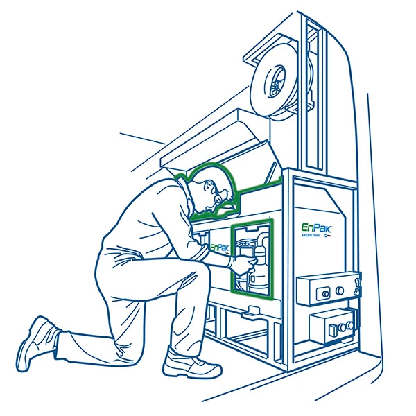

Tip #3: Ensure access for service
enpak_installed_3_resized
There needs to be enough clearance on all sides of the all-in-one unit to ensure accessibility for routine service and troubleshooting, which may require access to multiple sides of the unit.
Space in enclosed trucks is at a premium. It’s not uncommon for a custom enclosure to be built around the all-in-one unit. These enclosures must accommodate the required ventilation and be removable so the unit can be accessed for service.
The recommended amount of space on each side of the unit varies by model. Find this information in the unit’s owner’s manual.

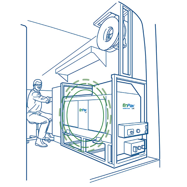

Tip #4: Choose a machine with lower noise levels
enpak_installed_4_resized
When equipment is running inside an enclosed truck body, noise can be a big issue affecting technician comfort and hampering productivity.
Look for an all-in-one unit that delivers quiet operation. A combination of industry-leading technologies on Miller EnPak all-in-one solutions help reduce noise:
  • Auto Start/Stop automatically turns the EnPak engine on and off based on demand, so it’s not constantly running.
  • Auto-Speed technology automatically adjusts engine speed to match demand — reducing noise.
  • Chassis Power, which is integrated into the chassis battery, monitors voltage and automatically charges it as needed. This allows technicians to turn off their truck to reduce jobsite noise.
