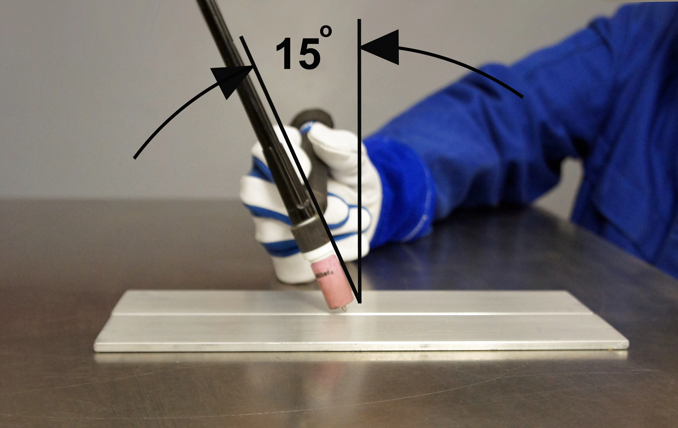

Dial in the TIG torch angle for cleaner deposition
The angle between the torch and the base metal is important, too. Here’s what to keep in mind:
  • Start around a 15-degree angle: This slight tilt lets you see the puddle and gives room for the filler rod.
  • Avoid steep angles: At 45 degrees or more, you lose shielding gas coverage and create a long, narrow puddle.
Tip direction matters: The electrode should point forward, in the direction of motion.

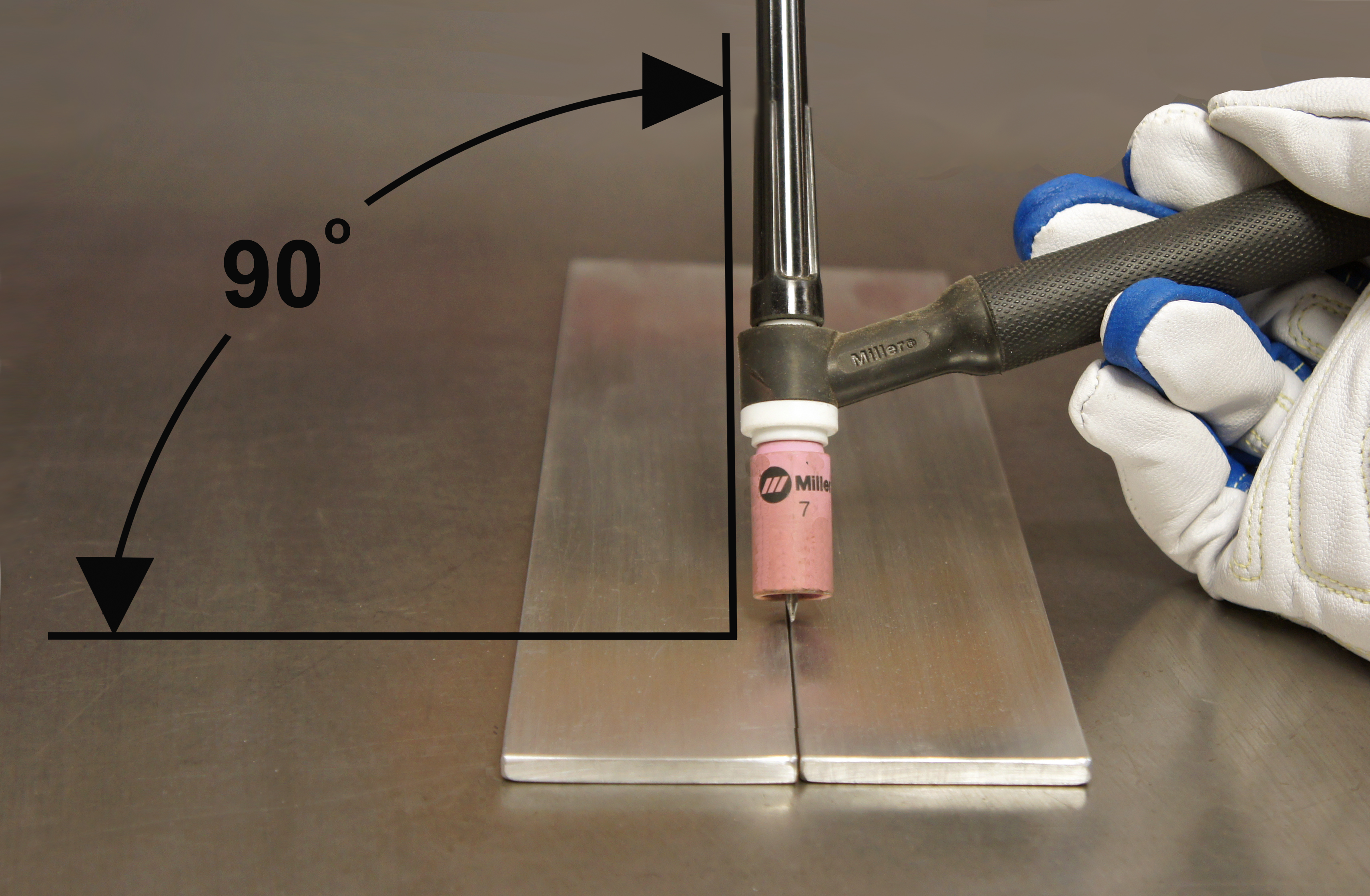

tig-005

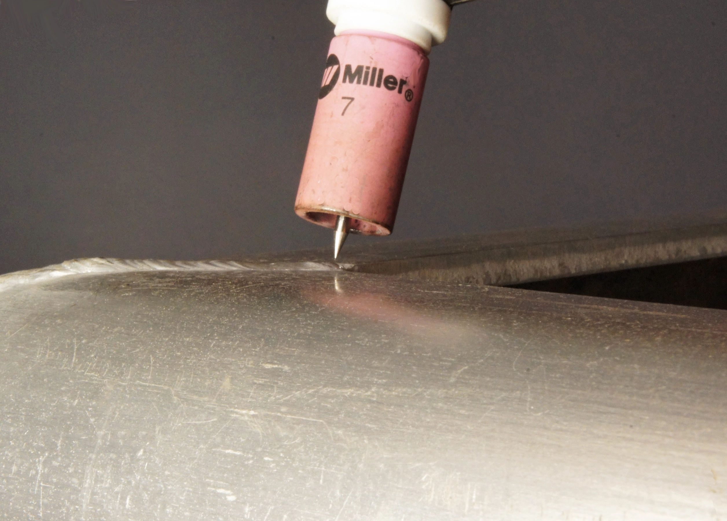

The “work” angle of the torch is also important. With a butt weld, the torch is normally at 90 degrees to the metal, as viewed from the end of the joint.
tig-006

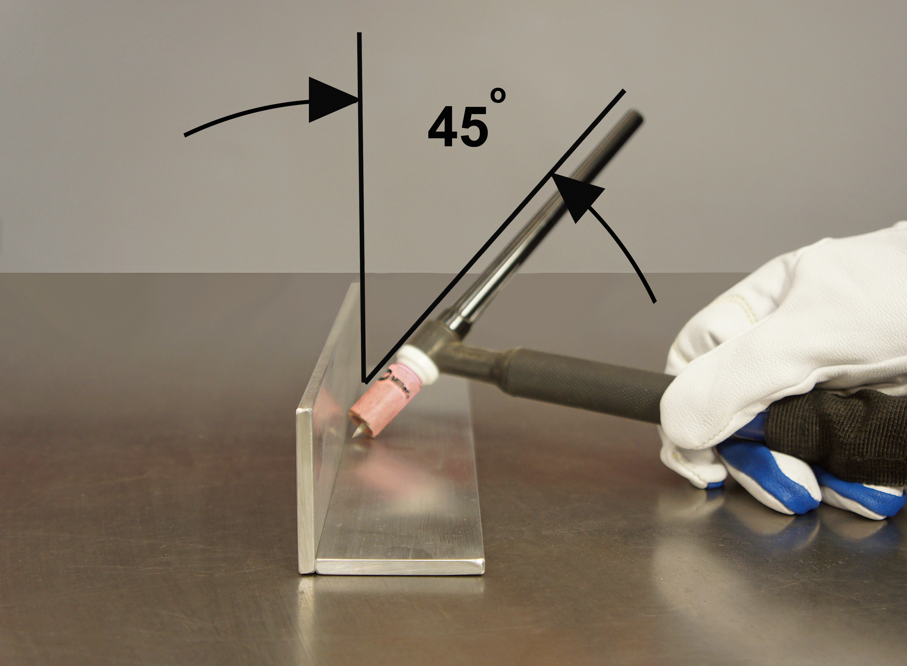

For making a fillet weld, where the pieces being joined are perpendicular, the work angle is usually 45 degrees, although you may need to modify this sometimes — like when joining metals of different thickness.
tig-007

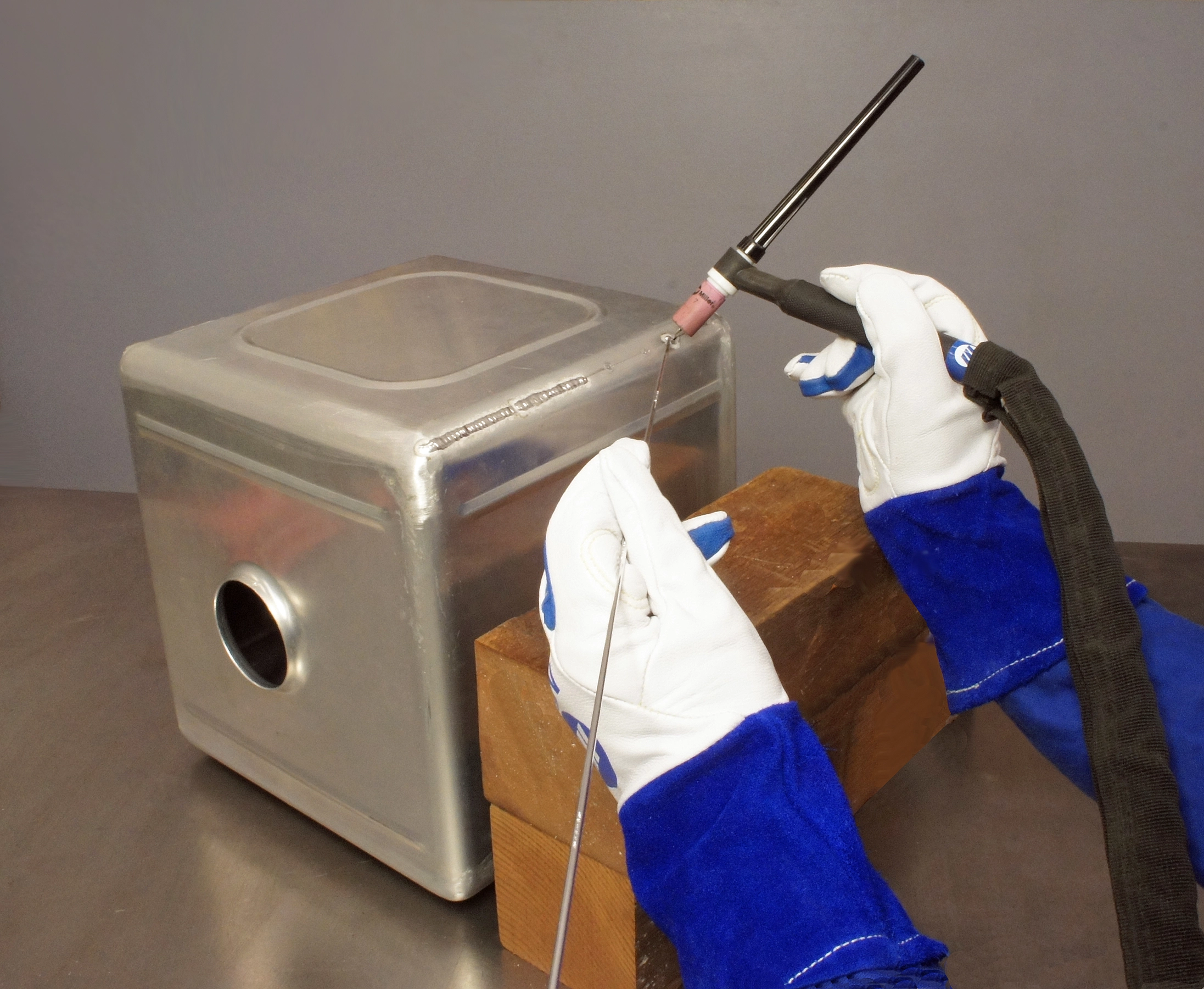

Tip #2: Look for ways to support your hands while using the torch.
Having good support for your hands or arms is crucial for moving the torch with precise control.
  • Rest wrists on the part being welded or use blocks for stability.
  • Keep wood or metal blocks handy for positioning.
  • Some welders use support bars to slide their torch hand along the joint.
  • For awkward positions, use elbows, forearms or even your hip for support.

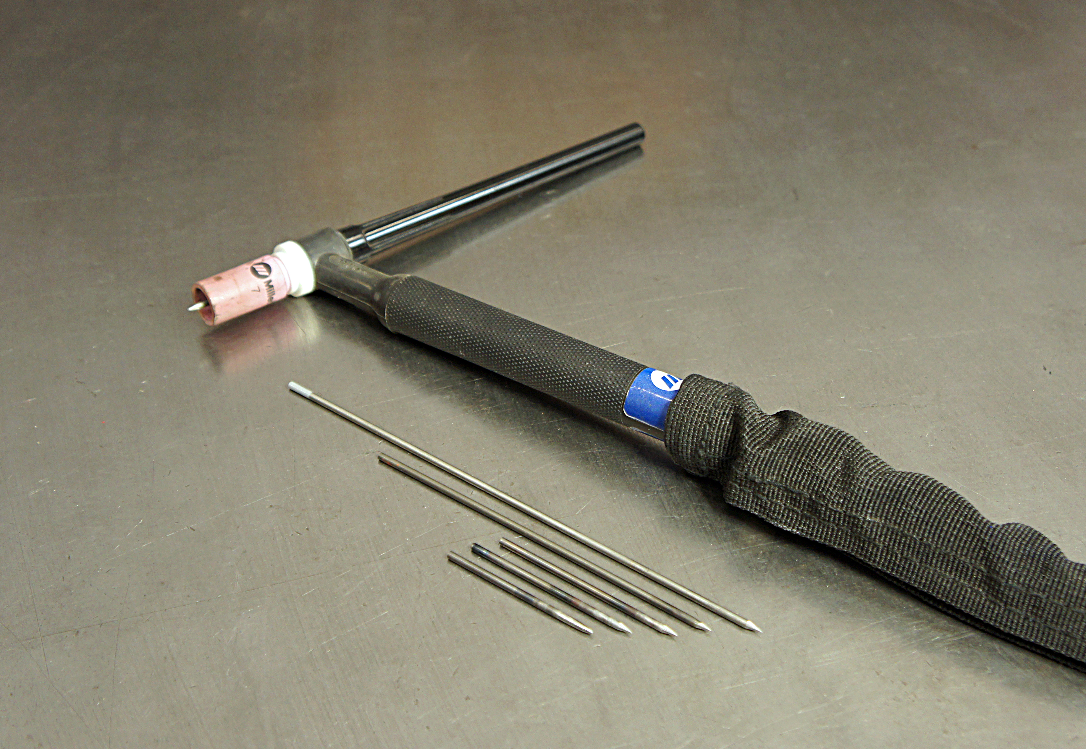

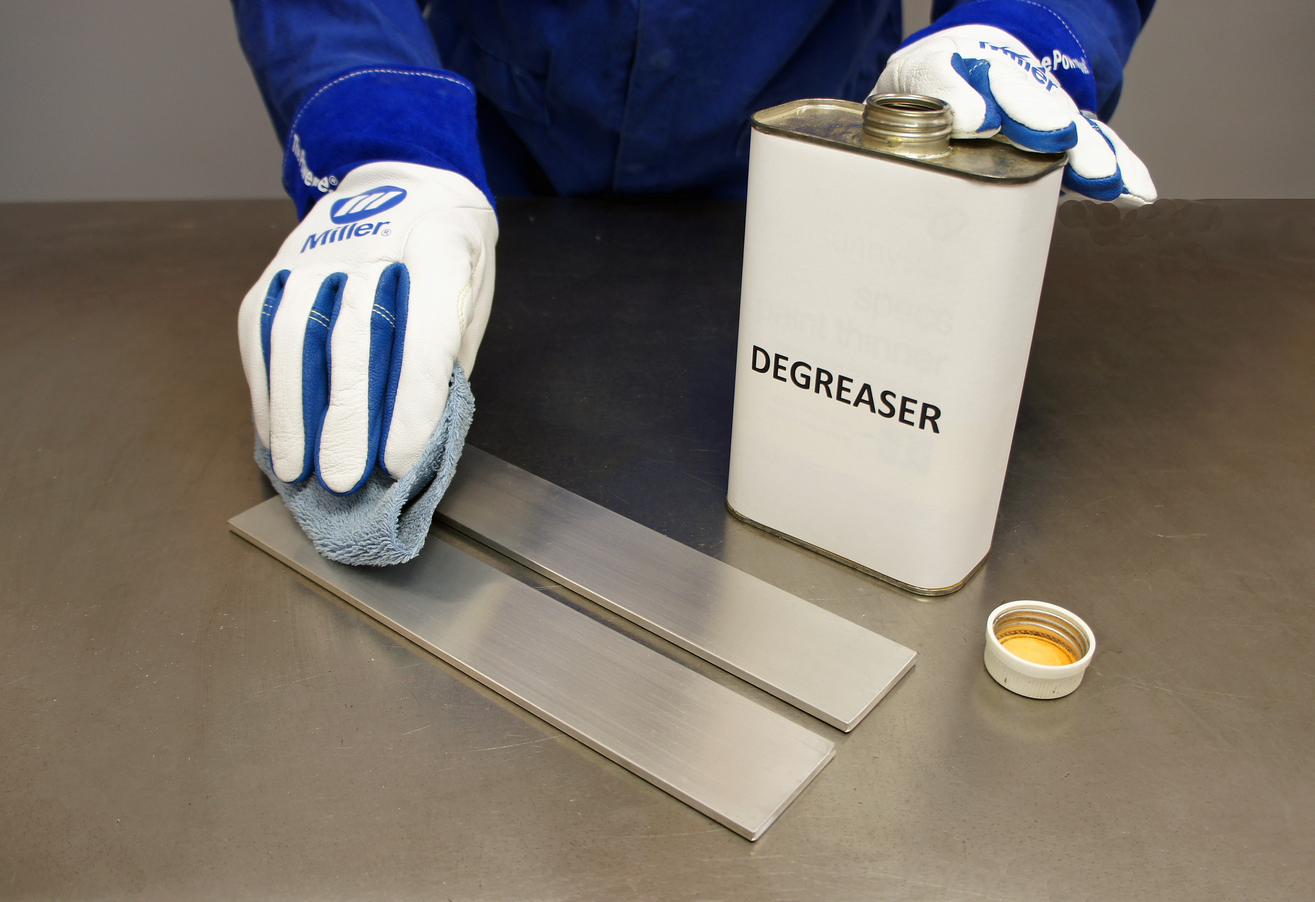

Tip #4: Clean a contaminated electrode immediately!
Every welder will contaminate their electrode at some point, but it’s essential that you replace it immediately. Keep a group of pre-sharpened electrodes handy and swap them out as needed.

Clean your metals well and prevent contamination. Contamination weakens the weld, and TIG welds are particularly sensitive to contamination.
