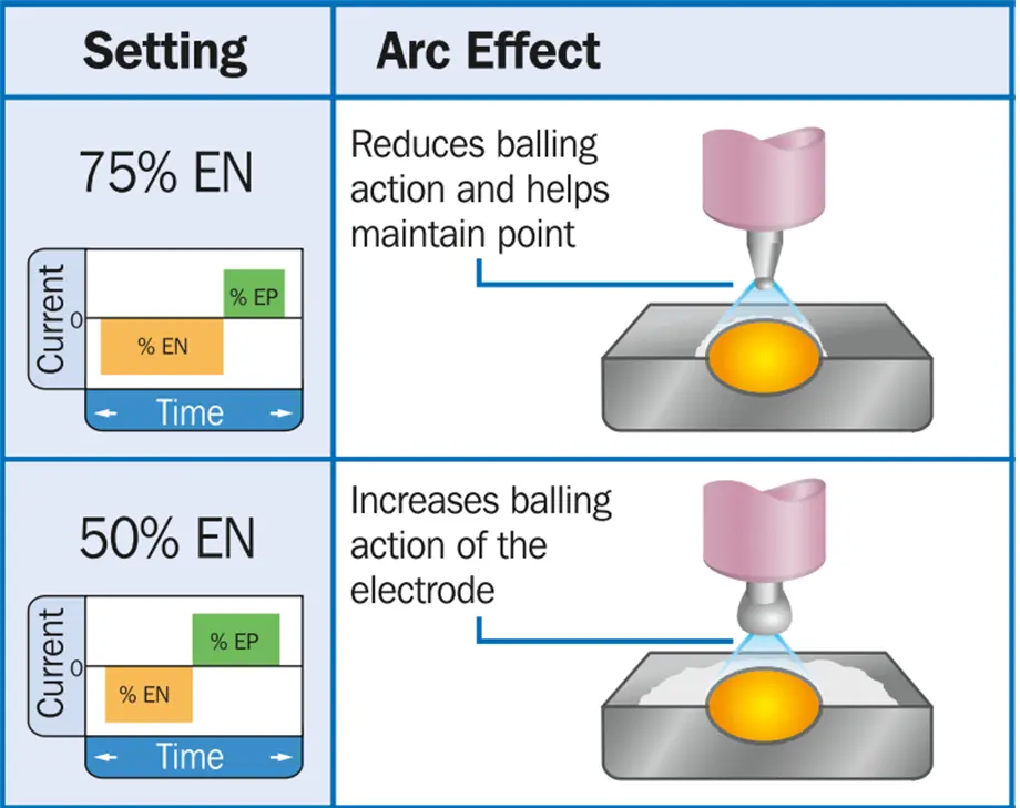

#2: Inverter-based welders extend EN balance control. Dynasty welders let operators fine-tune duration times from 50 percent to 99 percent. Making the EN portion of the cycle longer can help achieve greater penetration. It also contributes to narrowing of the weld bead and travel speeds increases up to 20 percent. Additionally, it reduces the heat on the tungsten, which can enable the use of a smaller diameter tungsten to more precisely direct the heat to make welds on smaller or thinner parts, and reduces the size of the etched zone for improve cosmetics. (see Fig. 1)
Fig. 1: Arc balance control

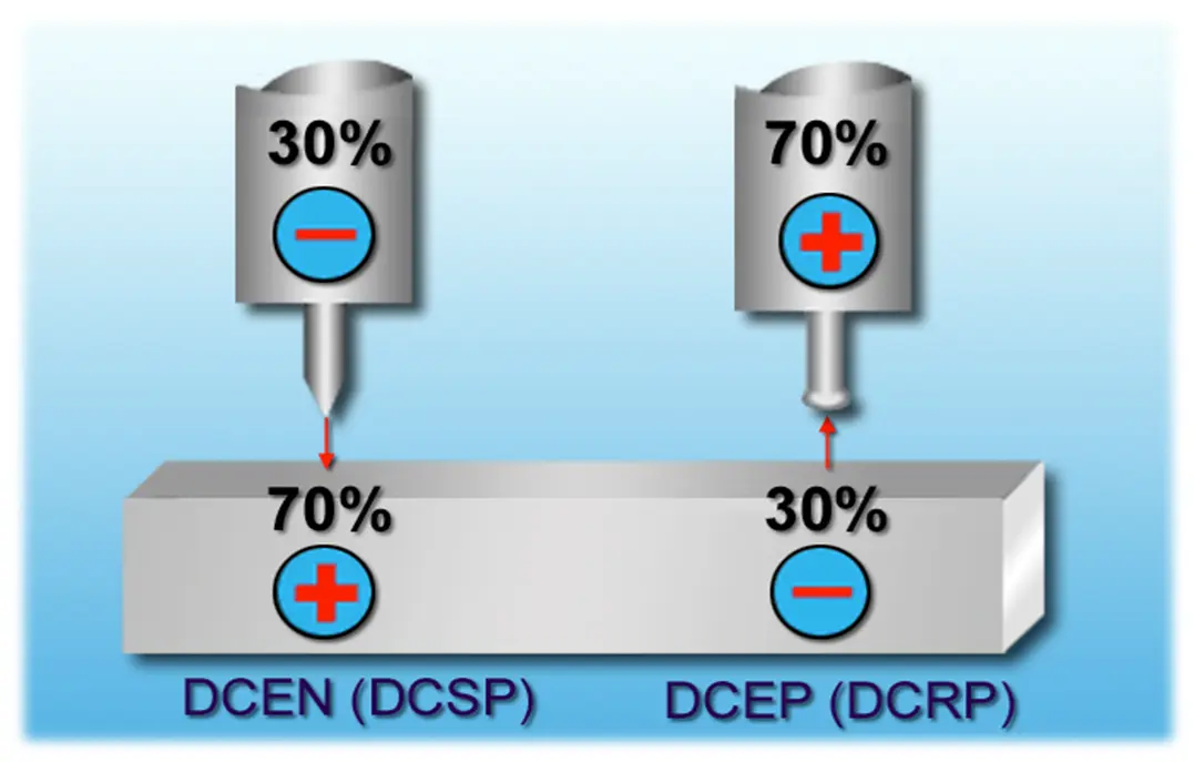

In DC mode, 30 percent of the heat goes to the electrode and 70 percent to the work (see Fig. 3). But because AC mode alternates the current between the work and the tungsten, it directs more heat at the electrode. This additional heat causes rare earth tungsten to crack and split, resulting in arc wander. The risk of tungsten inclusions also increases — smaller molten nodules are more prone to dropping into the weld puddle.
Fig. 3: Approximate heat input by polarity

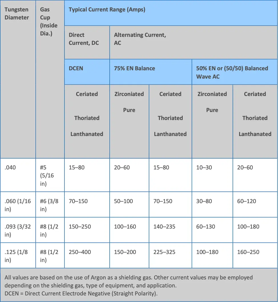

The combination of rare earth tungstens with advanced squarewave technology allows for the use of smaller tungstens. This delivers greater control with a more focused arc. (see Fig. 5)
Fig. 5: General tungsten amperage chart by diameter and alloying element.

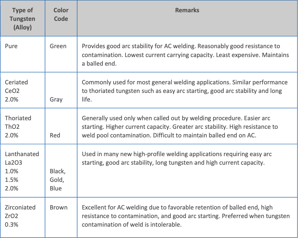

It’s also a good idea to consult a tungsten selection chart (see Fig. 6) for more information when making the choice.
Fig. 6: Common tungsten alloys and uses/arc characteristics.
