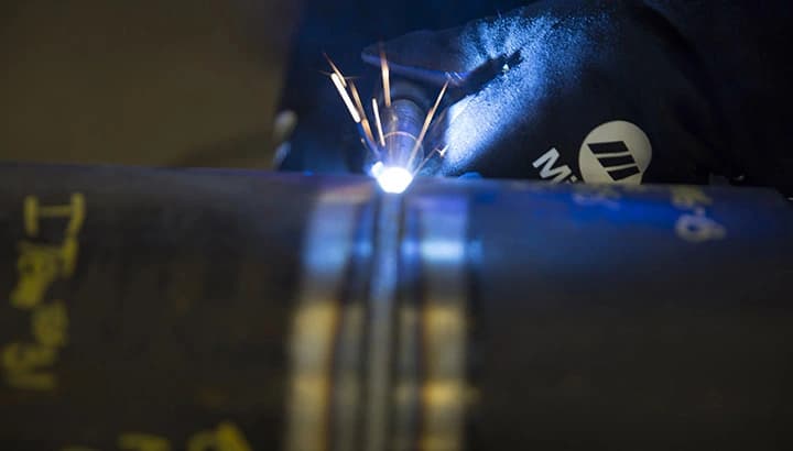

Here are five benefits a switch to the Regulated Metal Deposition (RMD®) process for open root pipe welding in shop and field applications can deliver.
5 benefits of converting to wire welding
Benefit #1: Faster process changeover
Using advanced wire processes like RMD (a modified short-circuit MIG process) and pulsed MIG welding allows for simple process changeover between weld passes with the push of a button.
This greatly reducing switch-over time compared to using TIG and stick welding, which requires changing polarity between each process switch. With PipeWorx 400 and XMT® 350 FieldPro™ with Polarity Reversing systems, operators can change polarity with the push of a button — without moving the electrical connection. In addition, RMD and pulsed MIG can provide a one wire, one gas solution that reduces time spent on changeover.

Using RMD instead of TIG for the root pass on stainless steel and chrome pipe welds may allow operations to eliminate the back-purge process. Back purging provides gas shielding on the back side of the joint while welding, but it adds significant time and money to the process.
It can require 20 to 30 minutes each time, depending on pipe size, to set up the argon shielding gas and tape the pipe ends for purging. In addition, the argon gas used for back purging adds to consumable costs. Back purging can also introduce safety hazards to operators who can be overcome by the argon gas and suffer inert gas asphyxia. Eliminating back purge saves time and money and reduces the risks involved with the process.
With RMD, welders can more easily control the weld puddle, welding speeds and heat input. A lower heat input allows the weld puddle to freeze faster. All of these factors combine to result in a less turbulent weld puddle and smoother shielding gas flow. This allows the gas to push through the open root and protect the weld's back side from sugaring, or contamination. Because the puddle freezes so quickly in the RMD process, such gas coverage is only needed for a short time — eliminating the need for back purging.
