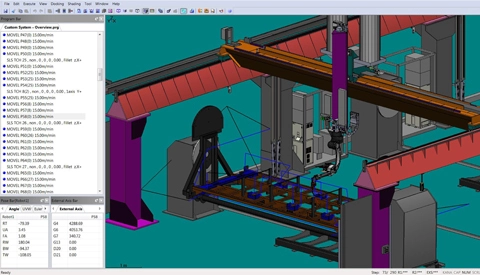

Offline programming and simulation software allows you to program your robot from a computer rather than on the robot itself. In order to work with this type of software, you will require 3D CAD models of both your parts and fixtures that will be used in the cell (created in a program such as Solidworks®). From there, your software options will vary depending on the manufacturer of the robots in your robotic welding cells. For instance, most OEM robot manufacturers offer specific, in-house developed offline programming software that features proprietary 3D CAD models of their robots. If your operation features a multi-brand robotic fleet, there are software solutions that offer 3D CAD models of numerous manufacturers. In-house robot software programs tend to be customized with more brand-specific functionality and finer control over the programming.
Once you import the 3D CAD models of your part(s) and tooling/fixtures, the software will match that with the 3D CAD model of the robot, creating a virtual replica of the system on the shop floor. With the click and drag of a mouse, you can build the program on your PC instead of using a teaching pendant in the weld cell. Upon completing all of the weld sequences, the system lets you to run the welding program as a simulation. This is when the software will detect possible collisions (discussed later), identify areas where weld procedure angles could be difficult to achieve and provide the time it would take for the cell to make a complete part.
After simulation and testing, you will export the program from the computer to the robot via Ethernet. Manually touching-up your program with a teaching pendant in the cell is next, as the software typically gets the robot to within a quarter of an inch of its final path.

Short Start-Up Times. A customer had a new robotic system that took months to build and they wanted to be operational as soon as the system was complete. The system featured two robots that moved along a gantry-style structure to weld an extremely large part. They were able to offline program the system as it was being constructed and, upon completion, drop in its programs, touch them up and begin welding. Manually programming these parts would have been difficult, and would have required the user to spend extensive time in and out of a hoist to access each weld. The software cut what could have been four weeks of programming down to one, allowing the user to perform the bulk of it from the comfort of his/her office.
