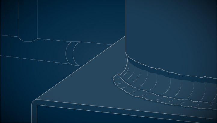

When it comes to controlling welding costs, you may be at a disadvantage before welding even starts. Something as simple as improper fit-up or overwelding adds time and wastes money. When the gap between parts to be welded is too large, for example, the operator has to use more filler metal and possibly make more weld passes. Poor setup can also lead to a greater potential for defects — and more costly rework. Whether the improper fit-up stems from bad fitting during tacking or from poor parts arriving from the manufacturer, it can add substantial costs. On a typical jobsite, labor accounts for 80% of welding costs while filler metal accounts for 10%, so finding ways to save on both of those things can put money back into your budget.
